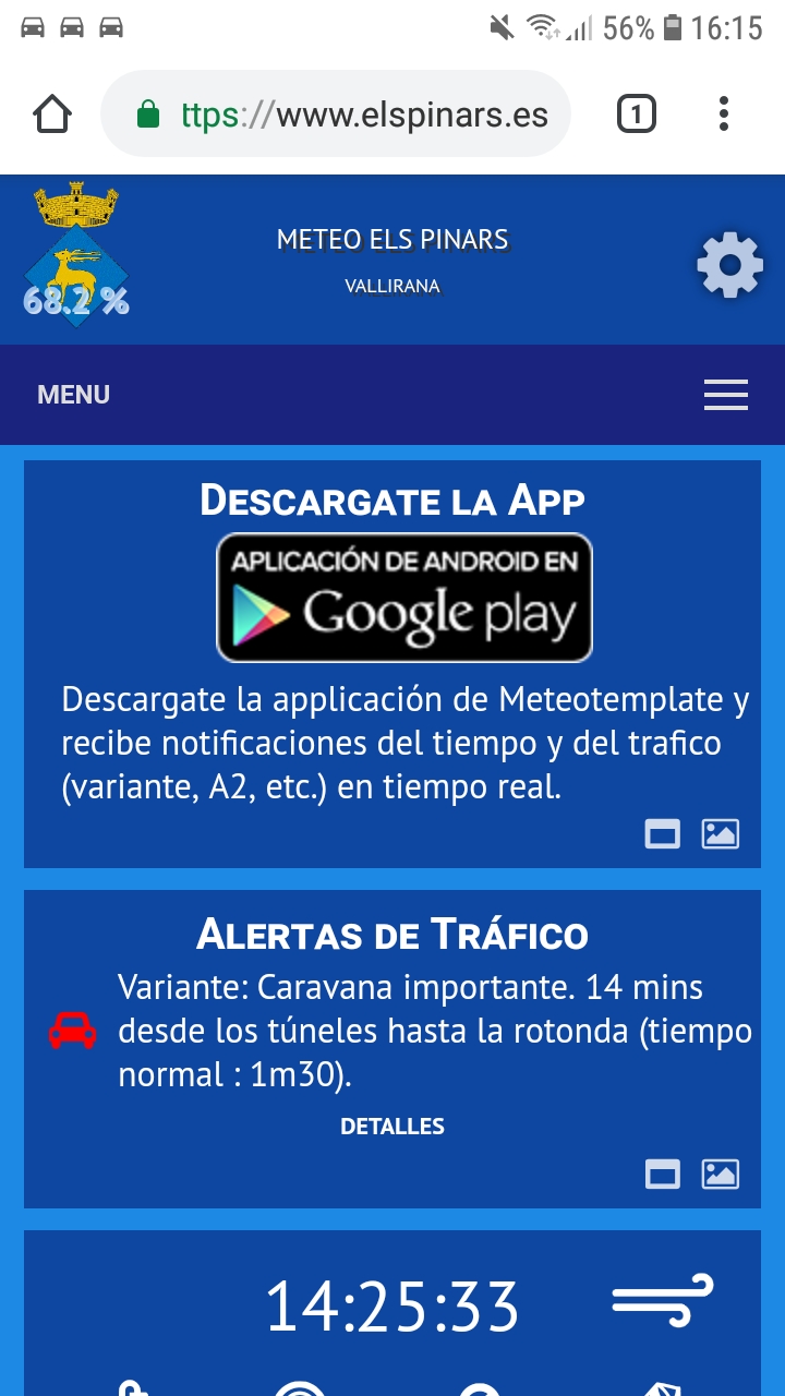

Even easier to install : just click on the button below :
And download the appBlock to display the same button on your site (along with a message of your choice) :
Note that the button :
- The block will be displayed only to visitors using Android
- The button will be localized in your site language
- The block will not be dsplayed in the app.
Enjoy and spread the word...

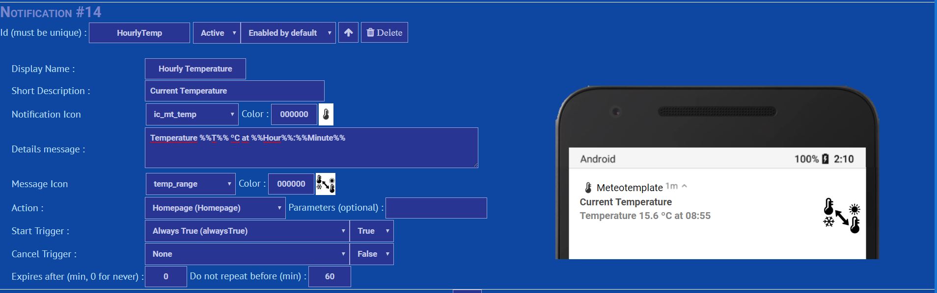

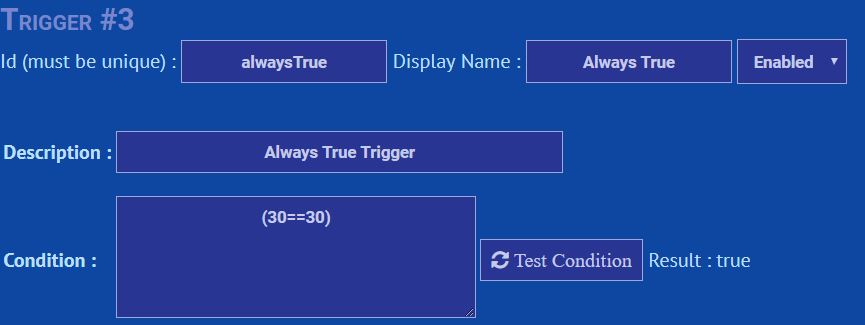

An "easy" way to do this is to have a trigger that returns always true and configure a notification which do not repeat before 1hr.
Example :
For the Trigger Condition : (30==30)
Note that you could also restrict the time range during which this trigger occurs to limit it to day hours, using the condition ((%%Hour>6) && (%%Hour<22))
For the Notification : variables must be enclosed by %% before and after the variable (like %%myVariable%% )
Your message could look like that : Temperature %%T%% ºC at %%Hour%%:%%Minute%%
This notification would be updated every time the user fetches notifications (as he will have defined in his app settings)
Note that you can play on both time variables : Expires and Do not repeat
Expires will cancel the notification after XX minutes : depending on how often the user fetches notifications, you may come to situations during which the notification already expired but the new one has not been fetched yet. In this case, when the notification is triggerred again, it comes as a new notification (with sound and everything) while if the notification did not expired (and the user did not cancel it), only the message is updated.
The Do not repeat before field will prevent the app to trigger the notification again comparing the current time to the last time it was visible. This means that while the notification is visible (has not been canceled by the user), the messages gets updated. When the user click (or dismiss) the notification, this will not be repeated before XX min. This can be tricky as you do not control the user's behavior (ie if he clicks on the notification at 8:55, he will not see it again until at least 9:55)
I am currently working on the whole notifications topics (adding configurable schedules and notification groups) so it is a perfect itme if you have feedbacks on how it is currently set up or new idea on ho it should behave, what would be useful, what is redundant, etc...
Thanks for your time testing the app.
Cheers,
Pol-Brieuc

Thank you, Pol-Brieuc; this is exactliy what I wanted!

It should work after that.
If it does not make the trick, please send me screenshots of the settings for your trigger and notifications and we can have a look offline.
Cheers,
Pol-Brieuc

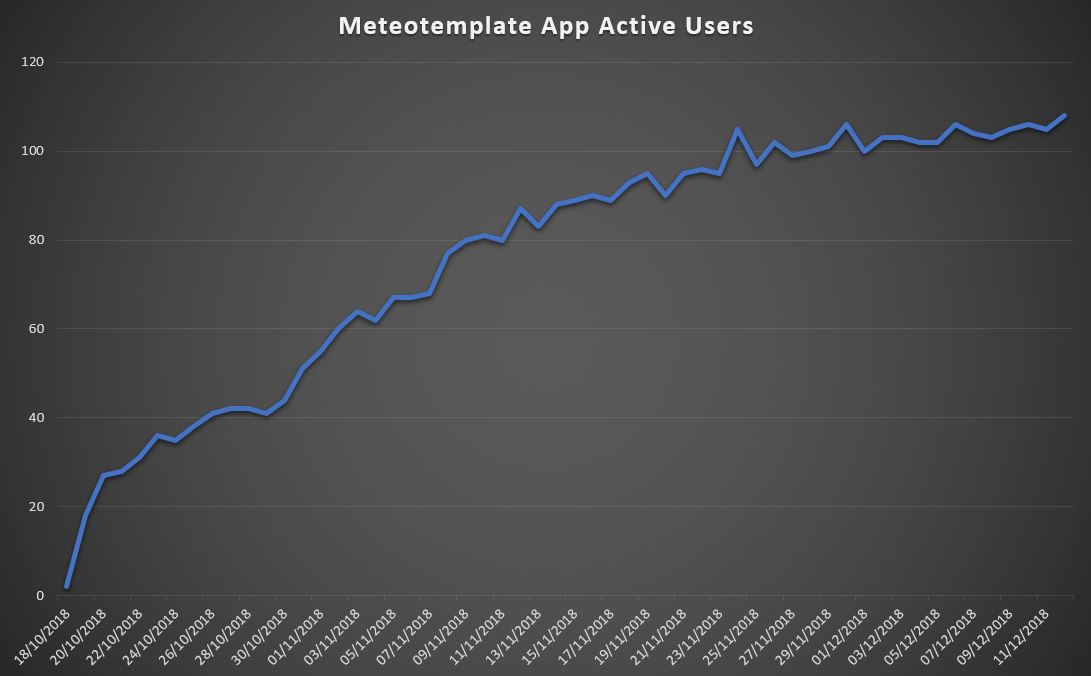

Hello everybody,
A quick update on the app :
- 45 days without a new version
, I had little time to work on it but I hope to get back on track during the holiday period
- There are several bug fixes ready (should prevent 90% of the crashes some user may currently see) but as I started to work in parallel on new features (and did not finish yet), I cannot release them yet. I'll try to have the next release before 2019
- As of today, the app has 108 active users (have the app installed on an active device)
- 35-50 daily average unique users
- 28 Meteotemplate sites are available in the app (thanks to the brave site owners who accepted to be guinea pigs, if you want your site included in the list, please contact me)
- 3157 screens viewed in the last 30 days (small report extract can be found here)
- Next update will include better notification management (including the possibility to group notifications and schedule them), better cache management (important for both loading time and resource usage for the user) and obviously bug fixes.
Here is a small graph of the evolution of users since the app is released as beta in Google Play :
As usual, you can find some additional information on the app page and you can contact me for further details.
And if you do not have it yet on your Android device, download the app and send me your feedback !
Cheers !
Pol-Brieuc

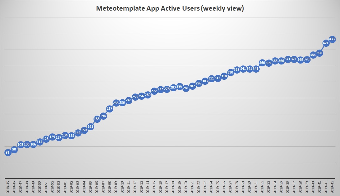

Hello everybody,
Another quick update on the app after quite a long period of inactivity...
- As of today, the app has 433 active users (have the app installed on an active device) :
- 43 Meteotemplate sites are available in the app (thanks to the brave site owners who accepted to be guinea pigs, if you want your site included in the list, please contact me)
- 56245 screens viewed since the beginning (small report extract can be found here)
Cheers !
Pol-Brieuc
