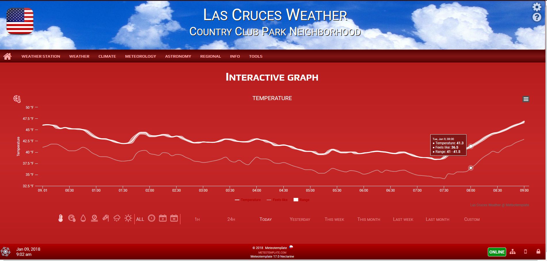

My Interactive graph is showing the wrong time scale at the bottom and the times in the popup boxes. The time is exactly minus 7 hours. The data displayed is correct for the correct time. Example: The temp at 8:00 am this morning was 41.3 if you look at the time of 1:00 am on the graph is shows 41.3. It is the graph times that are wrong. Help please.
Jay

Hi Jay
to increase your confusion:
seen from here (Switzerland), it looks all right (8 am - 41.3 °F) ?

Thanks for looking. I am confused. I deleted the cache and still seeing the same issue.
Jay

I suspect they must have made some change in Highcharts, because similar issue was in Meteogram and Interactive Graph was working fine, it is there since v1, people would notice...

jay_hoehn wrote: Tue Jan 09, 2018 3:24 pm My Interactive graph is showing the wrong time scale at the bottom and the times in the popup boxes. The time is exactly minus 7 hours. The data displayed is correct for the correct time. Example: The temp at 8:00 am this morning was 41.3 if you look at the time of 1:00 am on the graph is shows 41.3. It is the graph times that are wrong. Help please.
Jay
Mine is plus 1 hour, could it bee something related to UTC time? (Denmark UTC +1 hour --- US UTC -7 hour)

Noticed that the popup on the block shows the correct time.
It is only the block it self that differs. (+1 hour ahead)

georg wrote: Thu Jan 11, 2018 7:33 pm Noticed that the popup on the block shows the correct time.
Hi georg
Your "big" graph looks fine to me. Time is now 20:58 and latest record from 20:55
Time on x-axis on the right is 21:00
http://vejr.arloese.dk/template/pages/station/graph.php

Re: Interactive Graph
Post by Jachym » Thu Jan 11, 2018 10:18 pm
Highcharts adjusts time based on user system time, which is a problem because thats not what we want. Setting it to UTC should prevent this because it tells the script not to convert anything. What puzzles me is that the same setting works in other blocks/pages

Jachym wrote: Thu Jan 11, 2018 10:18 pm ...Setting it to UTC should prevent this because it tells the script not to convert anything.
Yes...but one of the options got
useUTC: false,
