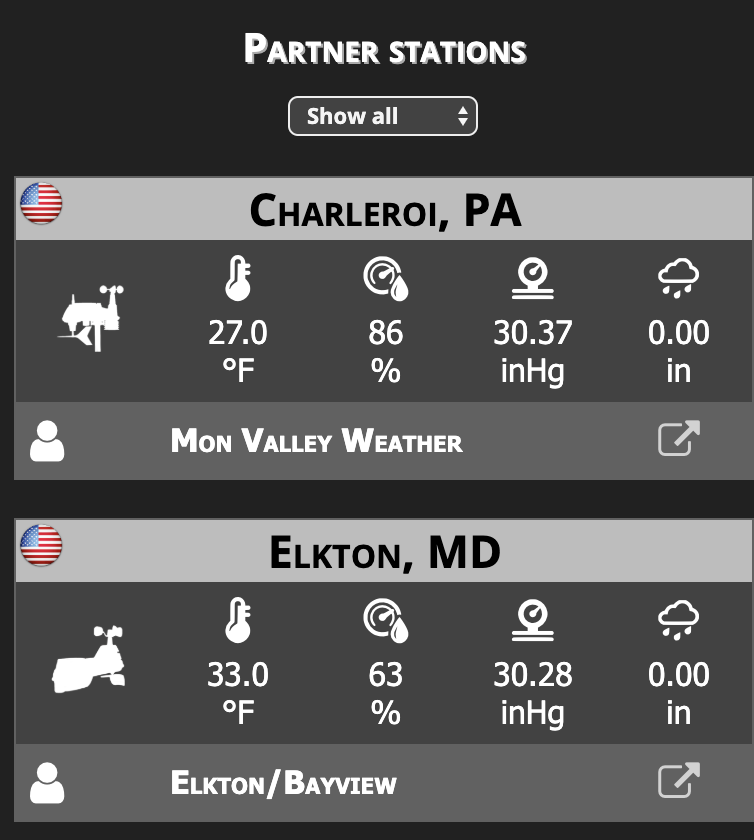

It sounds like you just as I have two partner sites you typically display. While not included in my original upload, I did make a small edit so that the block shows both of my partner sites by default (i.e. the 'ALL' option). I did this by going to the end of the partnerStationBlock.php code and making the following changes:
Original Code:
	<script>
		$("#partnerStationSelector").change(function(){
			id = $("#partnerStationSelector").val();
			if(id != "all"){
				$(".partnerStationClass").hide();
				$("#partnerStation" + id).show();
			else{
				$(".partnerStationClass").show();
		$("#partnerStationSelector").val(0);
		$("#partnerStation0").show();
	</script>
Updated Code:
	<script>
			if(id != "all"){
			else{
		$("#partnerStationSelector").val('all');
	</script>
The key points are to change the line $("#partnerStationSelector").val(0); to $("#partnerStationSelector").val(all); (This is the drop-down list entry) and to change the next line from $("#partnerStation0").show(); to $(".partnerStationClass").show();.
Figured I would pass this on as well.
Jay
After Code Update
After Code Update
Screen Shot 2019-12-07 at 10.01.31 AM.png (91.11 KiB) Viewed 16188 times
