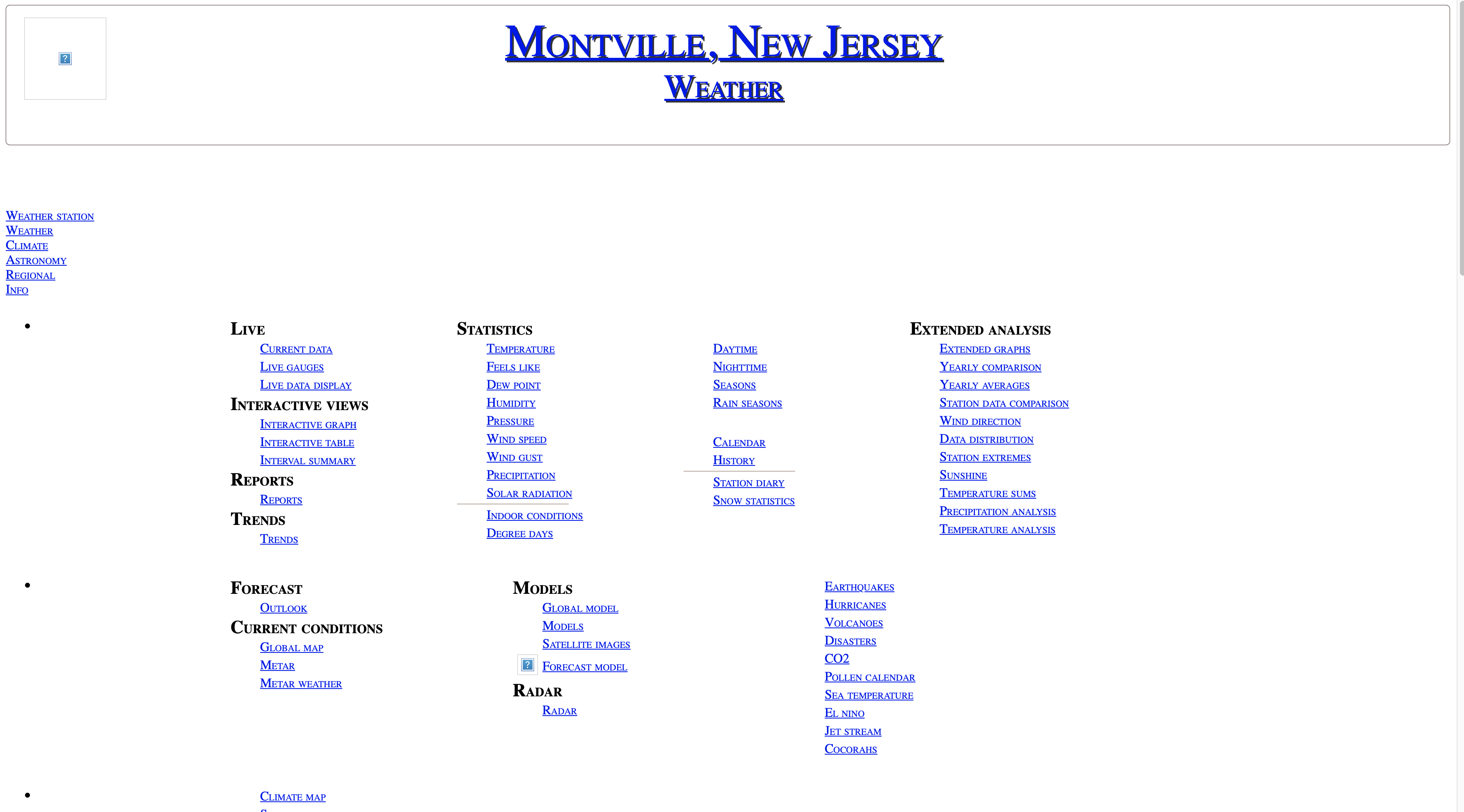

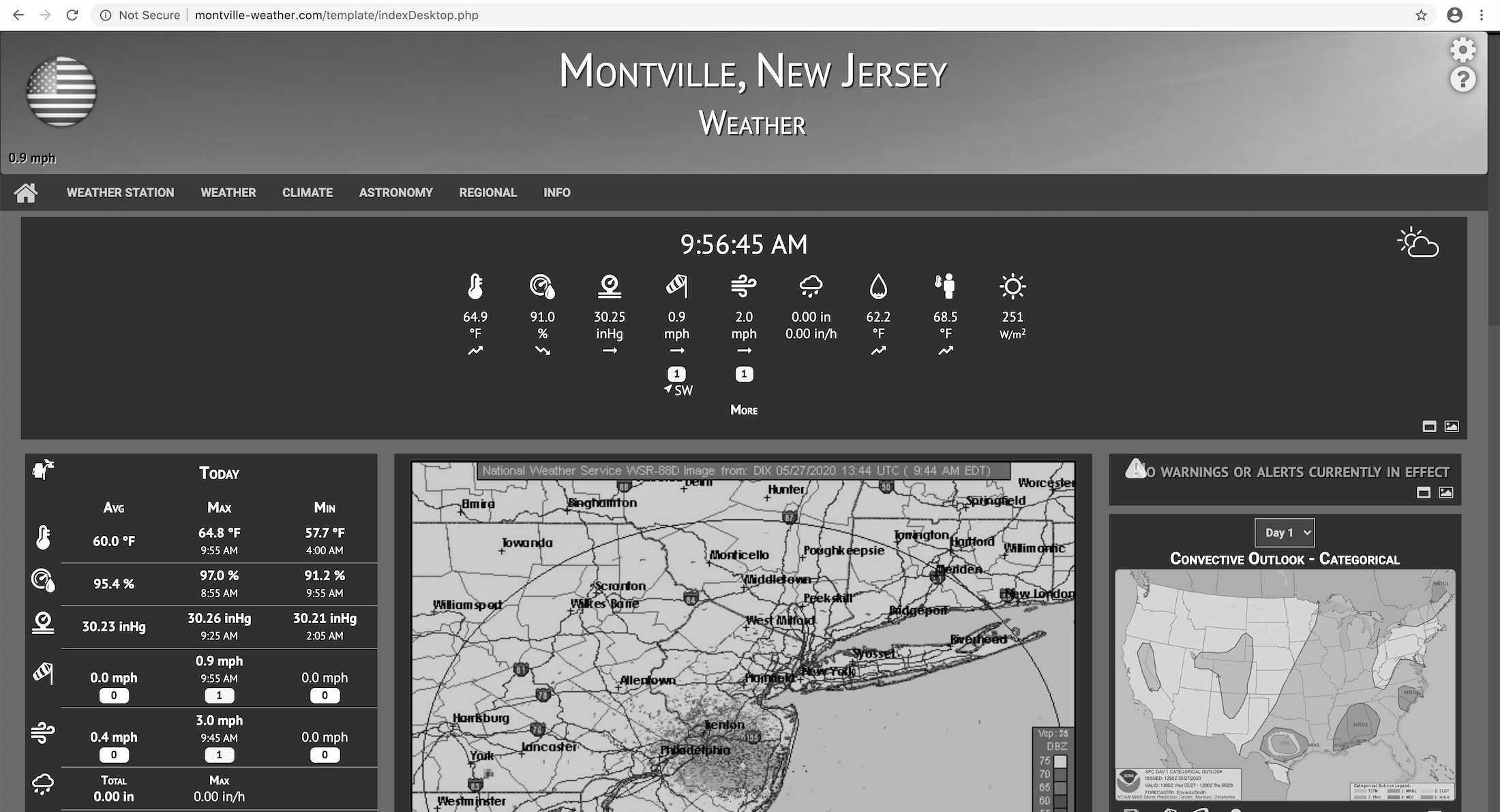

I've been having the same problem. I can only use the flexible option with Cloudflare as that is what my host's free plan allows. Unfortunately, that messed up all the css and other necessary files. I tried turning development mode on, and changing the setup.php path from http to https with no success.
EDIT: My website actually loads fine on Chrome with the flexible option, but not on Safari. First image is Safari, second is Chrome.

I got Cloudflare working properly now. I had the path set incorrectly on the setup.php page. It had the "https://", but I needed to remove "www." in order to get the website to display correctly and get rid of the Error 404 messages.
