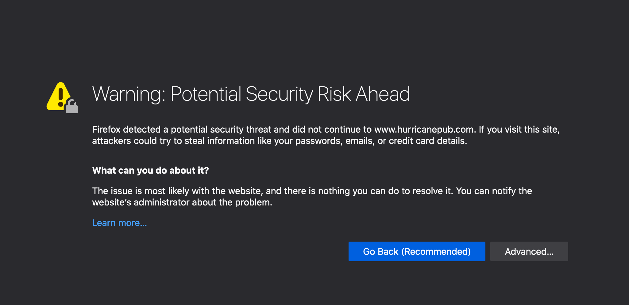

BTW, when I try to go to your site I get a big warning message:
Screen Shot 2020-12-18 at 11.48.48 AM.png (168.06 KiB) Viewed 58566 times

That should be fixed
Never updated my signature url to https after i secured all my sites
And yes if you look at my site now there is a warning I am still working on the details page but it will load I am using nwsalerts and calling it from a blank block there is some changes needed in the nwsconfig file needed

Yes, it is fixed and I can get to your site now without a big security prompt.
