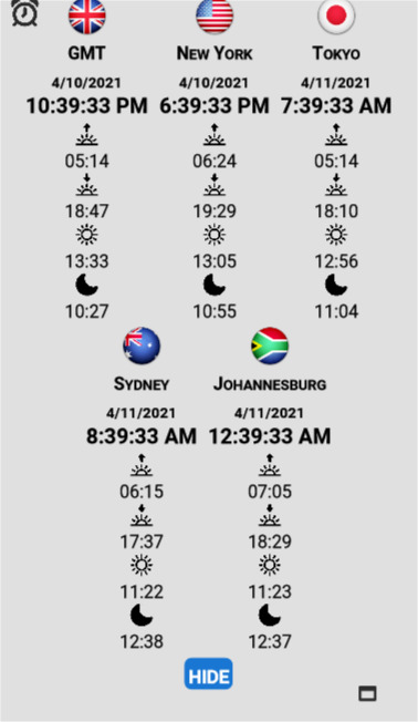

The remaining issue is why does the main clock show AM PM when I have selected a 24 hour clock?

AmateurExtra wrote: Fri Apr 09, 2021 12:37 pm Thanks, making the LA and Honolulu longitude negative resolved that issue - operator error.
As can be seen: sunrise, sunset, time of day and length of night is OK and in 24 hour format. The current time at the various locations is not in 24 hour format and I have the settings.php to $AMPM = false;
$clockStyle = 'digital';. I have tried to look at the code to determine what might be amiss and have had no luck. Please advise, thank you.

Post by davidefa » Sun Apr 11, 2021 3:04 pm
You can try this mod.
The funny thing is that I can see your page in 24h format ( but obviously you can't )
The arcane is that the visualization is 'locale dependant' ( and even browser dependant )
My locale (it-IT) shows it in 24h format, but your locale (en-US) shows it in 12h format!
The mod should fix this.

Post by AmateurExtra » Sun Apr 11, 2021 3:41 pm
davidefa wrote: Sun Apr 11, 2021 3:04 pm You can try this mod.
Now that sir, resolved the issue. I thank you for resolving this for me.
