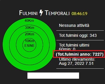

Ciao,
Would it be possible to move the total lightning year under Strikes last 60min and above last strike?
but only total lightning, however
the other comments $tunder_txt (Storm is approaching at, Storm is going away, ...) leave them under where they are
thanks in advance
thanks in advance

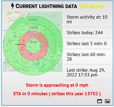

Hi!
I seem to have a problem in ver 2.3 where the 5 min section is not updating and the approaching storm at the bottom is not working. It was with a previous version which I don't remember the number of but assuming ver 1.0
I am still only using PHP 7.4 because am afraid to make the leap to 8.0 or 8.1. Could that be my problem and which should I try. PHP ver num (8.0 or 8.1) I mean.
Andy
Edit: I tried updating to both php 8.0 and 8.1 but my site comes up with a blank page and having to revert back to php 7.4 I think (I forgot the version number)
I mentioned this in other posts encase you run across them.
Andy

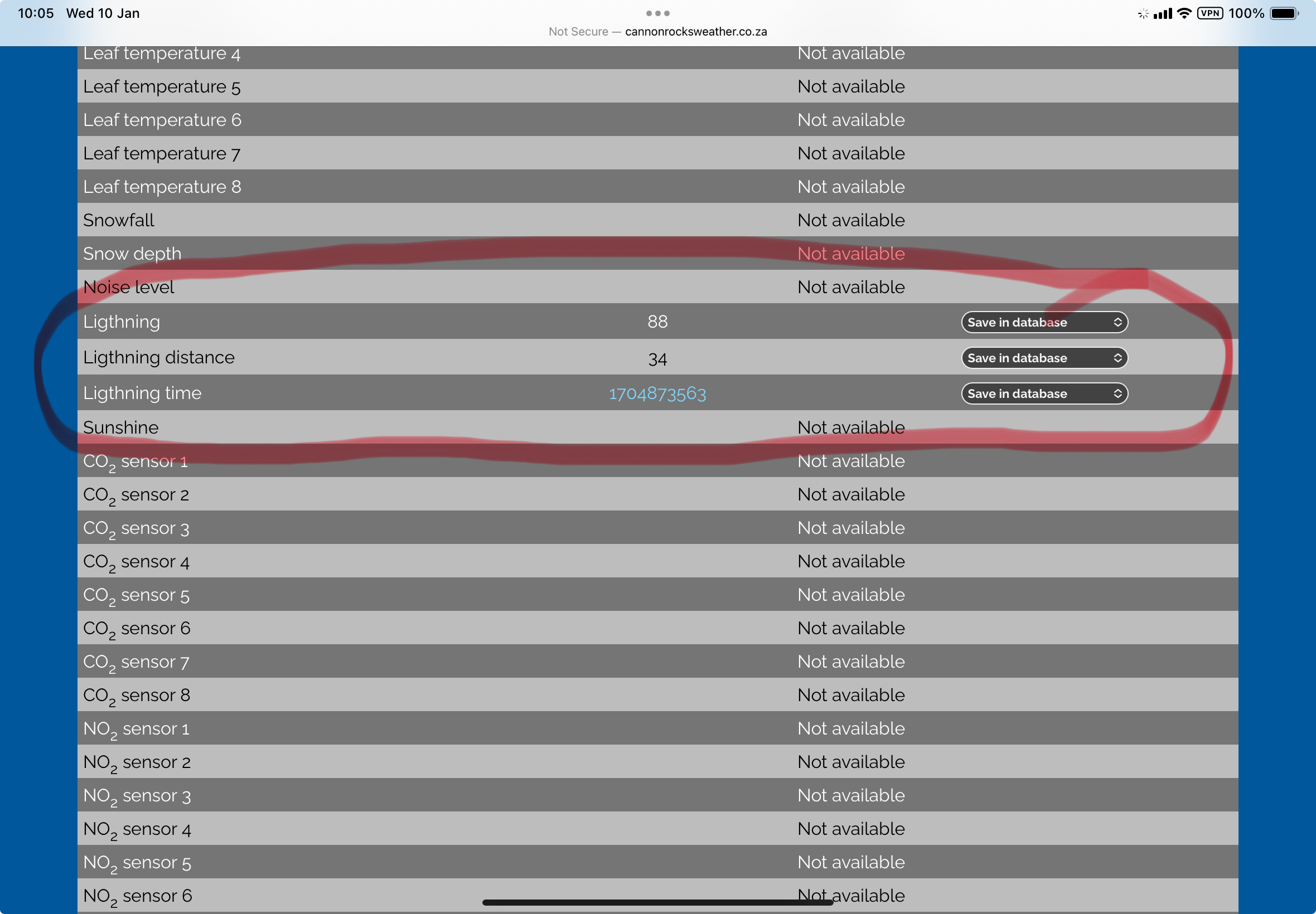

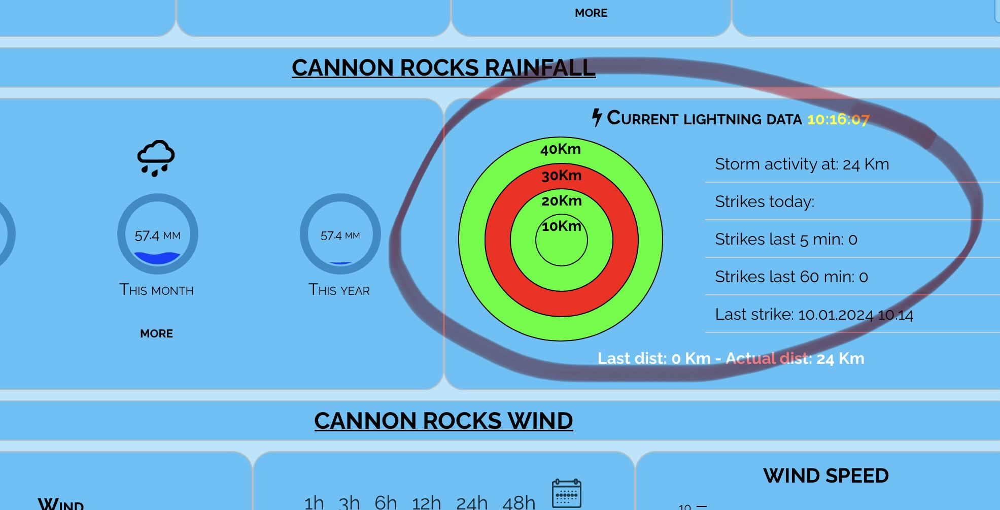

I need some help with lightningew block please.
My data shows in meteotemplate database…see attachments…but the block always shows only 1 strike…latest.
I have seet cache time to 0
Thank you,
Leon Rossouw.
Thank you,
Leon Rossouw.

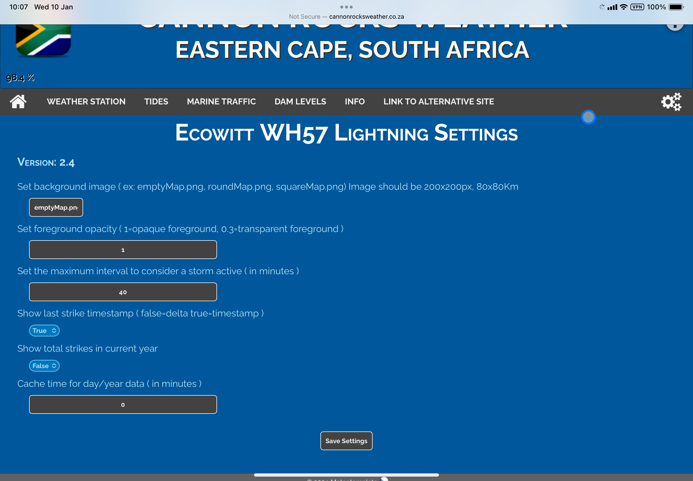

Screenshot of block

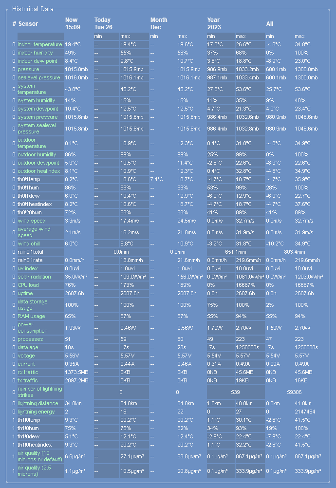

Screenshot

Screenshot database

Re: need help for ecowitt wh57 lightning device

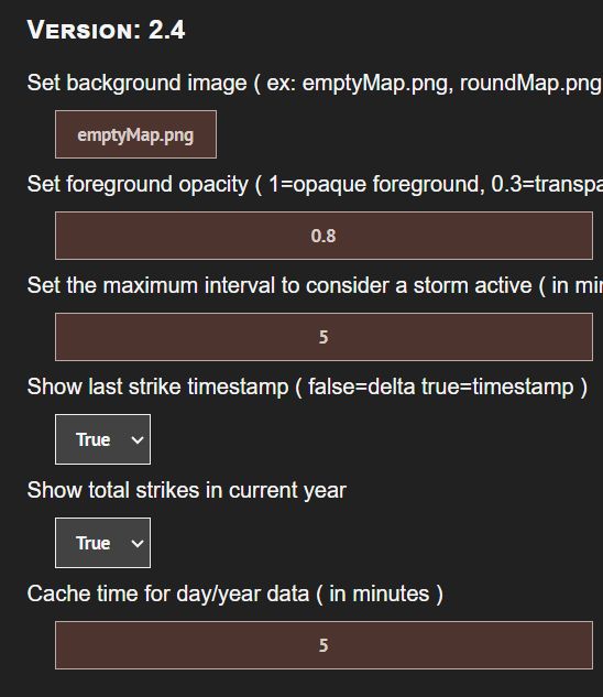

try to set your block like this

Thank you…did that but still showing only current strike
I eventually got it sorted thank you,
Problem was with my database..
Leon
Leon
