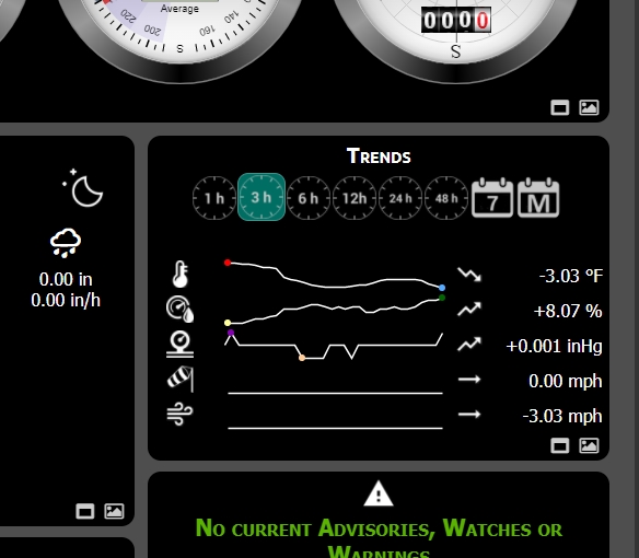

Small error in block trends.
The number shown for wind gust trend incorrectly uses the result from temp trend. The units is correct but the number is not.

Is anyone else having this issue?

You are right, same here.

I think it was a copy and paste error. On line 282 there are two instances of trendT those should read trendG. Fix that and it will solve the issue.

Worked!! Thanks!

Mine is all screwed up. My line 282 shows trendG

What seems to be the problem here? It looks fine.
Jay
Re: Block trends
Post by Dehatter » Sun Jan 28, 2018 8:22 pm
The block got updated a few days ago. It is good now. Be sure to use the updated block.

Hah.... nevermind. I was reading the data as actual values instead of the trend value! :shock:
