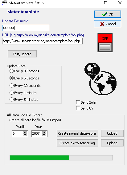

Just installed Jachym's excellent templates. Need to import data from my WeatherDisplay install. I have data going back to June 2007 I would like to import. I've read the wiki, and if I understand correctly, I can use the WD api to both provide the ongoing updates, and to import the historical data.
From the WD control panel, I can bring up the Meteotemplate setup screen. Can someone help explain how I use it to import all my historical data? Do I have to do it one month at a time? Below is the screen shot from the WD api page. I'm assuming I use the "All Data Log File Export" section at the bottom to do this. It's not clear to me how I'm supposed to use the "Month" and "Year" boxes. And do I use both the "create ...." buttons, and then the "Upload" buttons?
Any assistance appreciated.

I used Weather in the past and if I remember correctly you need to import one month at a time. The title of the import box is not clear. It is not all data but import to the alldata table. I also could not get the upload to work. I took the files from the computer, that were created when you press the create button, in the weather display folder uploaded them with my ftp then imported them to the database from there using the control panel in Meteotemplate.
Hope that helps,
Jay
Hope that helps,
Jay

Wow. One month at a time. So for me, that's 132 months. Times two, since I also have extra sensors. Then manually import one at a time. Thanks for the info Jay. Need to decide if I want to move all that data then.
