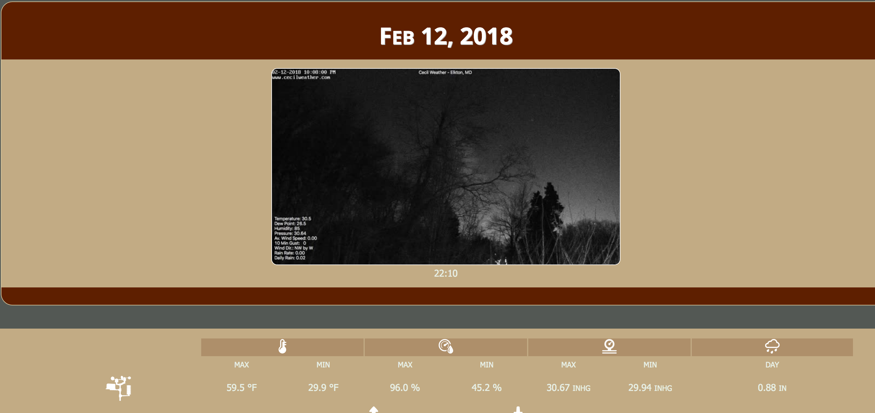

Just happen to notice that when viewing the information in the webcam, the rain total for the day is actually showing the total for the previous day. So for example if I view the images for February 12th, I am seeing the total rain for February 11th.
Screen Shot 2018-02-13 at 11.46.41 AM.png (655.71 KiB) Viewed 6826 times
Screen Shot 2018-02-13 at 11.51.03 AM.png (18.55 KiB) Viewed 6826 times
Minor and not something many users would catch but certainly something that should be addressed when the next plugin update comes around.

I then checked the WEBCAM table with the same search criteria and found the problem:
Showing rows 0 -  3 (4 total, Query took 0.0331 seconds.)
SELECT `DateTime`,`R` FROM `webcam` where (DateTime > '2018-02-11 23:40') and (DateTime < '2018-02-12 00:20')
DateTime	R
2018-02-11 23:40:02	0.88
2018-02-11 23:50:01	0.88
2018-02-12 00:00:02	0.88
2018-02-12 00:10:02	0.00
Since I have my webcam settings set to create an entry every 10 minutes, I am not sure how to prevent this. I am going to do this to see if it helps:
