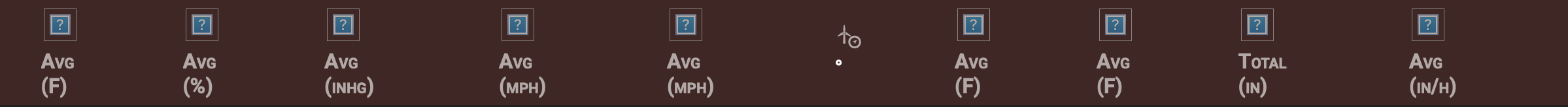

I have setup my website locally on my Mac using MAMP and I am running the update cronjob in terminal (which is working successfully every minute). My website is using Weather Underground for database updates and data import. The website is connected correctly to my database and all my data have been uploaded.
My current conditions block is working and updating about every 15 minutes and my Station Data block is also updating and showing correct data.

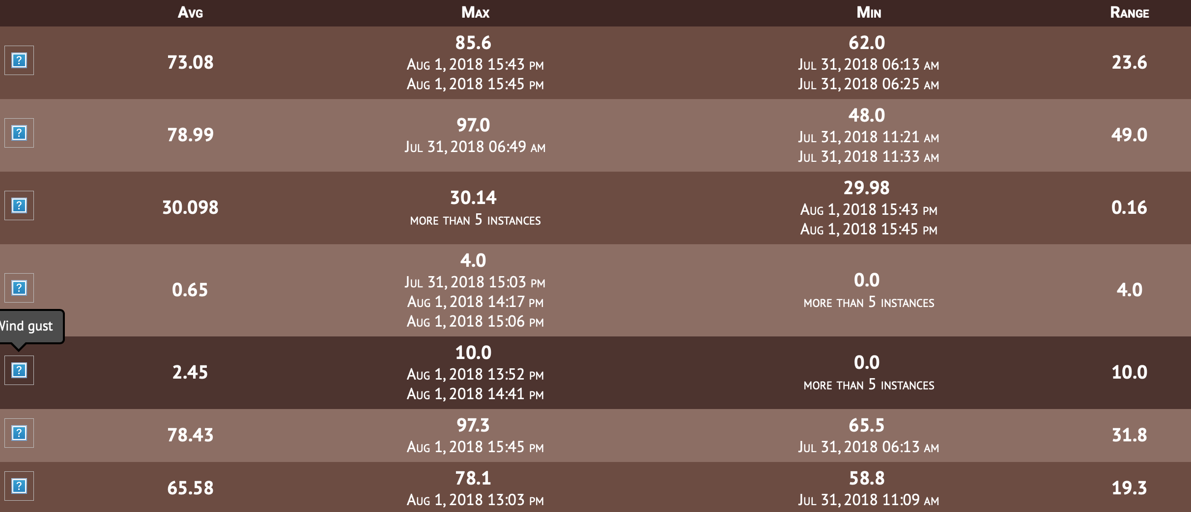

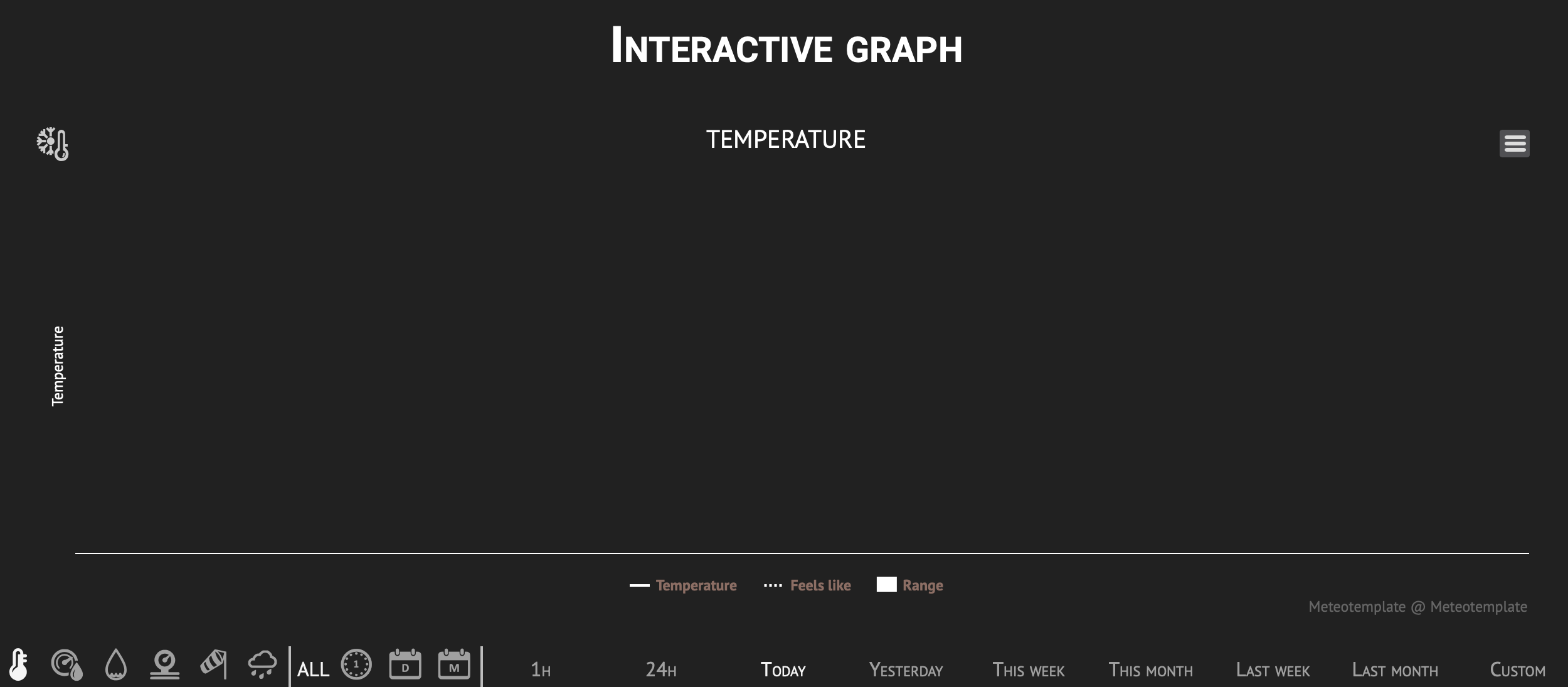

Unfortunately, the Station Averages block is empty and all of the pages within Interactive Views under Weather Station are not working. The Graph is empty and not showing anything. The Table also does not show anything (I can create the table when I hit OK but no data or pictures load). The Interactive Summary does work but it is showing bad data.
I don’t know what I can do to fix this as I already tried deleting and re-uploading the data from Weather Underground.
Station Averages & Interactive Views not working

If you go to the admin control panel - Edit Data page, do you see data in a table? If not, something must be wrong with the data recording.
The missing icons are probably either a path or permissions issue. What is your website's URL?

Strangely enough all the data seems to be in the table and none of it seems inaccurate as far as I can tell from a quick glance. I still don’t get why it won't show up on the Station Averages Block or any of the Interactive View pages.
Image problems seem to be caused by the image file being in the wrong spot. For example, the weather —> outlook page was missing the Forecast Summary icon and after opening the index.php in Brackets, I saw that it should be located in icons/table.png (/pages/forecast/icons/table.png). Turns out that the file was located in /icons and not /pages/forecast/icons.
That fixes the first issue with the images loading problem. The other problem seems to be the code <?php echo $pageURL.$path?> within the img src code. When I took that segment out and placed the table icon in the appropriate folder, the image appeared when reloading the page.

Did you set your "Path" and "Page URL" correctly in the template's main setup? Pretty sure you need the '/' after your page URL for things to work properly. So it should be and your path, if your template is installed in a folder called 'template', should be 'template/'.
