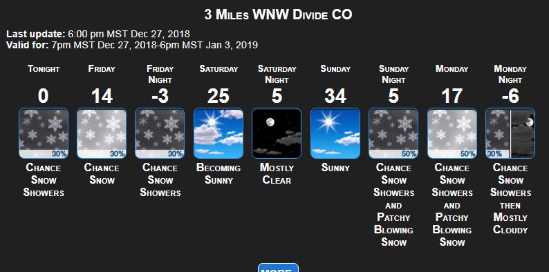

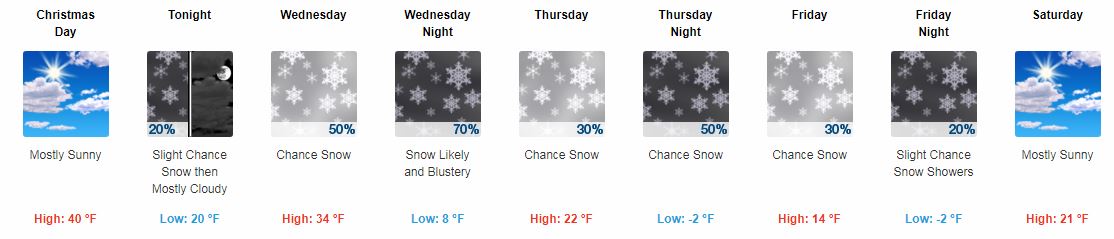

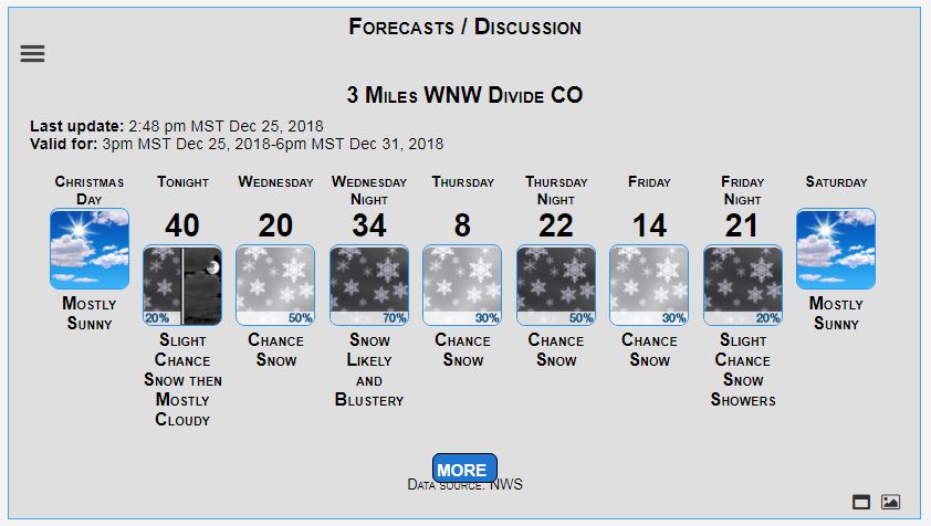

Attached images show the NWS Forecast block on my page and the same data on the NWS official page. I couldn't figure out what was going on with the temperature numbers missing and in the wrong place in the block. It looks like there is an issue with displaying negative temperature values in the block version. The negative temperatures don't show and they cause the rest of the numbers to appear off by one space.

Checking my cache file nwsForcastChace.txt, <p class="temp temp-low">Low: -2 &deg;F is in the correct place with the correct value. It looks like code for that block sets up an array with a counter to line up the images and temperatures to display in the block. When it encounters a negative temperature something happens, maybe to the counter??, and it skips any negative temperatures. Also, this same thing happens in the nwsForecastCustom block. Whatever is happening occurs in both blocks with temperatures below zero.

I made the follow minor change to line 90 in nwsForecastBlock.php. It seems to have fixed the issue of skipping past a negative (below zero) temperature. It now shows the minus sign and places the temperatures into the correct places. I'll keep track of it for a bit to see if the fix holds. If so, I'll make the same change in customLoader.php in the nwsForecastCustom Block which currently has the same issue with minus temperatures. I also updated the data source for the NWS images to https as that link was forwarding there.
Here are snips of the modified code and the block after the change.
