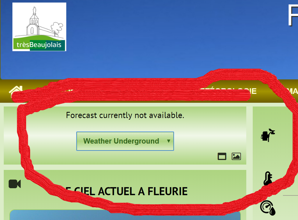

Hello
The wu forecasts in the FORECAST block no longer work.
Attached photo
cordially
Attached photo
cordially
- WU FORECAST li.png (820.65 KiB) Viewed 28156 times
Re: Forecast with WU
most likely this is due to the end of WU API. WU is transferring to a paid mechanism, no more free APIs
