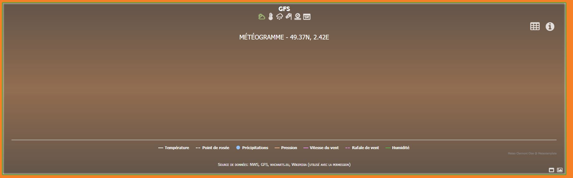

Re: GFS
Posted: Tue May 12, 2020 7:27 pm
by didoujm
le programme fonctionne avec le site http://wxcharts.eu/php/get_gfs.php?days=10&lat ça fonctionne plus l'adresse wxcharts.eu Ce site est inaccessible Impossible de trouver l'adresse IP du serveur de wxcharts.eu.
Essayez d'exécuter les diagnostics réseau de Windows.
DNS_PROBE_FINISHED_NXDOMAIN.
Par contre le site https://www.wxcharts.com/ fonctionne correctement
Re: GFS
Posted: Wed May 13, 2020 8:47 am
by al60
the site http://www.wxcharts.eu/ no longer works it has been removed. The https://wxcharts.com site works well.
http://www.wxcharts.eu must be replaced by https://wxcharts.com in the gfsBlock.php files and in gfsBlockTable.php using note ++ using the replace function.
Jachym, if you read us, can you update the gfs block. Thank you
Have a good day
(google translate)

Re: GFS
Posted: Sun May 17, 2020 5:30 pm
by Lespius
al60 wrote: Wed May 13, 2020 8:47 am the site http://www.wxcharts.eu/ no longer works it has been removed. The https://wxcharts.com site works well.
Have a good day
(google translate)
J'ai remplacé l'adresse de wxcharts mais ça ne marche pas. Ni graphs ni carte. Je vois que chez toi il te manque la carte aussi.
Re: GFS
Posted: Mon May 18, 2020 4:49 am
by al60

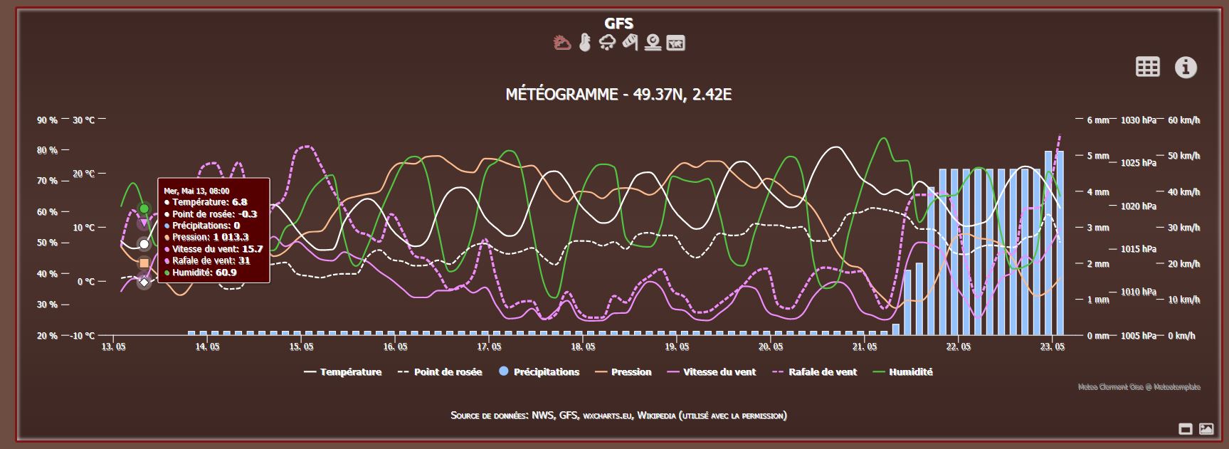

Re: GFS
Posted: Mon May 18, 2020 8:15 am
by Pavel
Thanks for fixing GFS, but I'm not satisfied yet, it still shows a summary of the rain, but not individual precipitation, as it was in the past, see the picture. Could it still be fixed? Thank you very much.
