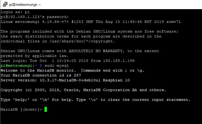

Some data from the MariaDB/MySQL configuration for the root user.
| Database |
| information_schema |
| mysql |
| performance_schema |
| phpmyadmin |
| @@datadir |
| /var/lib/mysql |
Current user. root@localhost
Protocol version: 10
Connection: Localhost via UNIX socket
UNIX socket: /var/run/mysqld/mysqld.sock

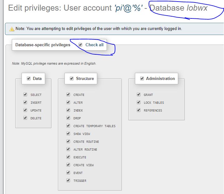

2. I suggest that you should. To create a database user, type the following command. Replace username with the user you want to create, and replace password with the user's password:
GRANT ALL PRIVILEGES ON *.* TO 'username'@'localhost' IDENTIFIED BY 'password';3. $dbName = 'lobwx';
$con = mysqli_connect('localhost','user','password',$dbName);
Hope it helps. You should probably use PhpMyAdmin to administer mysql/databases, makes it a lot easier. https://www.phpmyadmin.net/

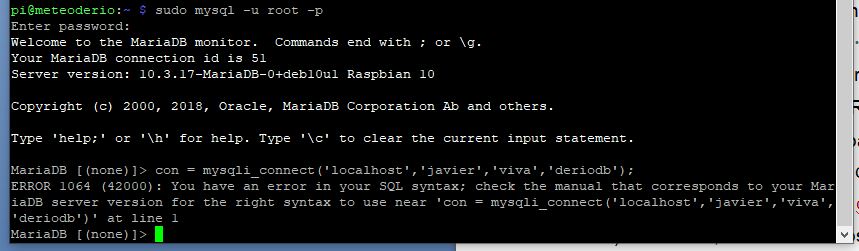

I have advanced, but I have problems with mysqli_connect.

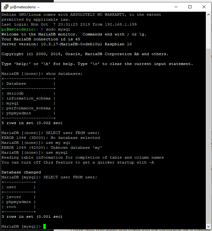

Successfully, I created a new user (javier), with password (viva) and a database (deriodb).
I have done several tests with the connection command:
In all cases the syntax error 1064 appears.
My PHP version is 7.3.9-1-deb10u1.
Can you help me discover the error? I'm a total novice and I have no choice but to abuse your patience. Thank you very much.
con = mysqli_connect('localhost','javier','viva','deriodb');
con = mysqli_connect('localhost', 'javier', 'viva', 'deriodb');
con = mysqli_connect(localhost,javier,viva,deriodb);My PHP version is 7.3.9-1-deb10u1.
El_Viejo
- Posts: 105
Re: MySQL Configuration
Here is a screenshot.
- LOBWX
- Posts: 104
- Joined: Sun Mar 11, 2018 6:43 pm
- Location: Los Osos, CA
- Station model: Ambient WS 1401-IP
- Software: MeteoBridge

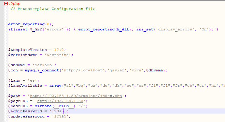

All this goes into the /template/config.php file
$dbName = 'deriodb';
$con = mysqli_connect('localhost','javier','viva',$dbName);
Just BE NICE! That's all it takes to be a decent human...

El_Viejo
- Posts: 105
I have read WiKi again and check that the config.php file is created after running for the first time the setup.php file located in /template/install.
Then, I assume that I must do the following operations:
1.- Run the setup.php file and save it.
2.- Edit the config.php file that will have been created and include these two lines
Is that correct?
Excuse my clumsiness. Thank you
$con = mysqli_connect('localhost','javier','viva',$dbName);Excuse my clumsiness. Thank you

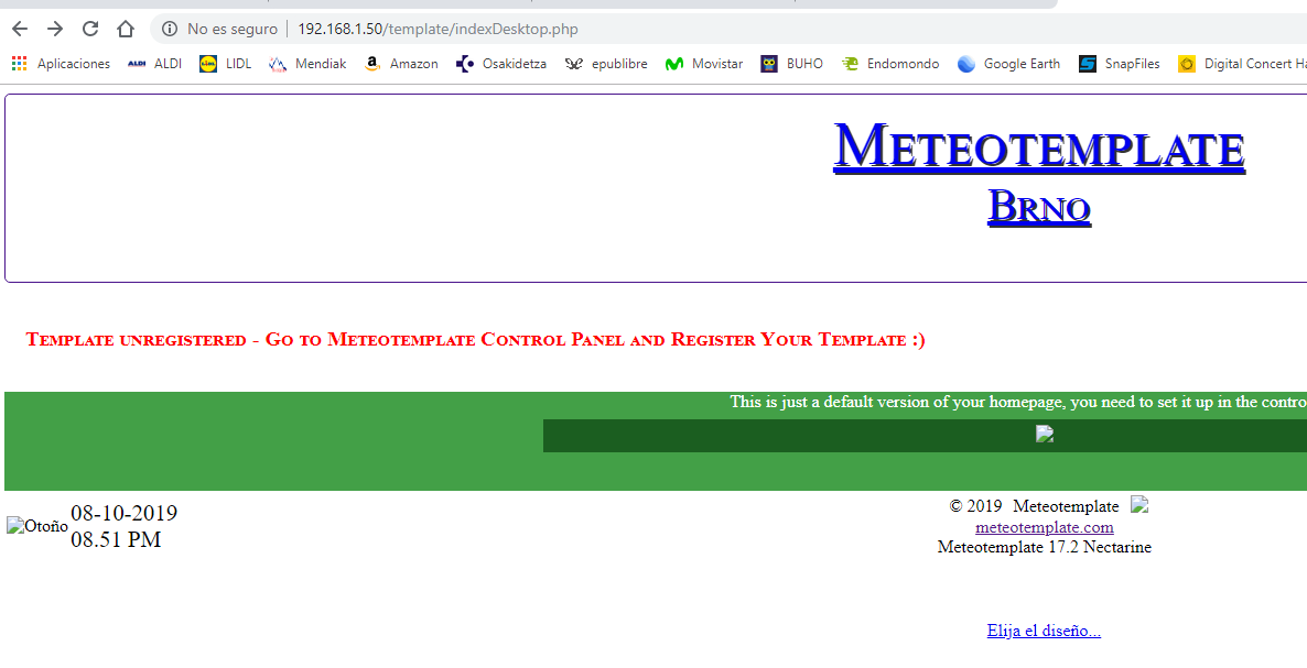

El_Viejo
- Posts: 105
I apologize for my limitations with the English language.
In my RPi, with the Chromiun browser, from the static IP (192.168.1.50) , I write http://192.168.1.50/template/install/setup.php
and the Meteotemplate installation page opens.
I run "Server Check" and it tells me everything is correct. But, when I run "Check MySQL", it returns this error message:
"Debugging error number: 2002
Debugging error: php_network_getadress: getaddrinfo failed: Name or service not know."
Host address = http://localhost
User = javier or root
Password = viva or yomismo
database name = deriodb or empty
Thank you for your help

El_Viejo
- Posts: 105
Affirmative, I have phpMyAdmin installed.
I include it as an attachment are the results with sudo mysql and the three commands.
Thanks again
Thanks again
- Forum_MySQL_01.PNG (54.11 KiB) Viewed 28755 times
- LOBWX
- Posts: 104
ok now edit your /template/config.php
Then run the "Check MySQL" again with any luck you should have no errors.

El_Viejo
- Posts: 105
Your patience is almost infinite. Thank you very much.
But write what you write,
http://192.168.1.50 or http://192.168.1.50/template
this is the page that appears. I think the error is in the paths
- Config_01.PNG (21.01 KiB) Viewed 28724 times
- Inicio_01.PNG (44.94 KiB) Viewed 28724 times
Getting closer.
You also need to fix this, just localhost NO http://localhost
Do you not have a FQDN "domain name" .com , .net, or something?
$path = '/template/';
$pageURL = 'http://lobwx.com';
$baseURL = dirname(__FILE__)."/";
$adminPassword = 'mypass';
$updatePassword = 'mypass';

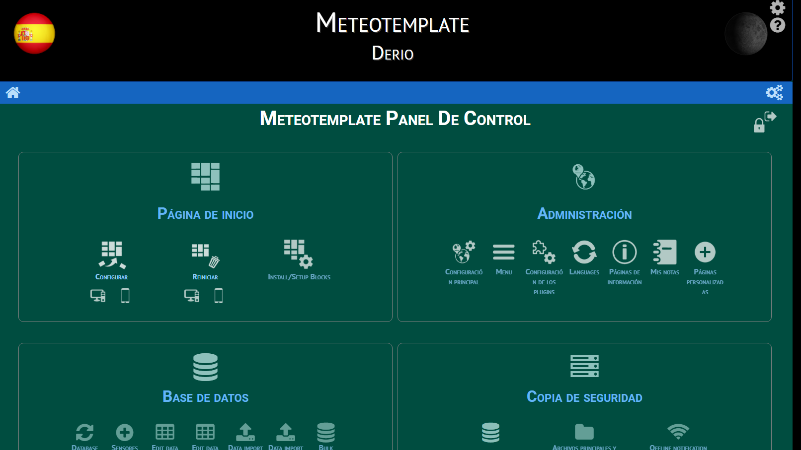

El_Viejo
- Posts: 105
I needed to repeat the whole process in another RPi.
I managed to start the Control Panel and register my Meteotemplate. Here is the proof
But "Table Create" displays this message: "Table was not created, please check your MySQL setup."
I'll keep investigating, but I'm sure I'll need your help. Do you still have patience?
In any case, thank you very much.
- Panel_Control_01.PNG (103.61 KiB) Viewed 28701 times
- LOBWX
- Posts: 104
You may want to check phpMyAdmin for the correct privileges on the the database you are using
