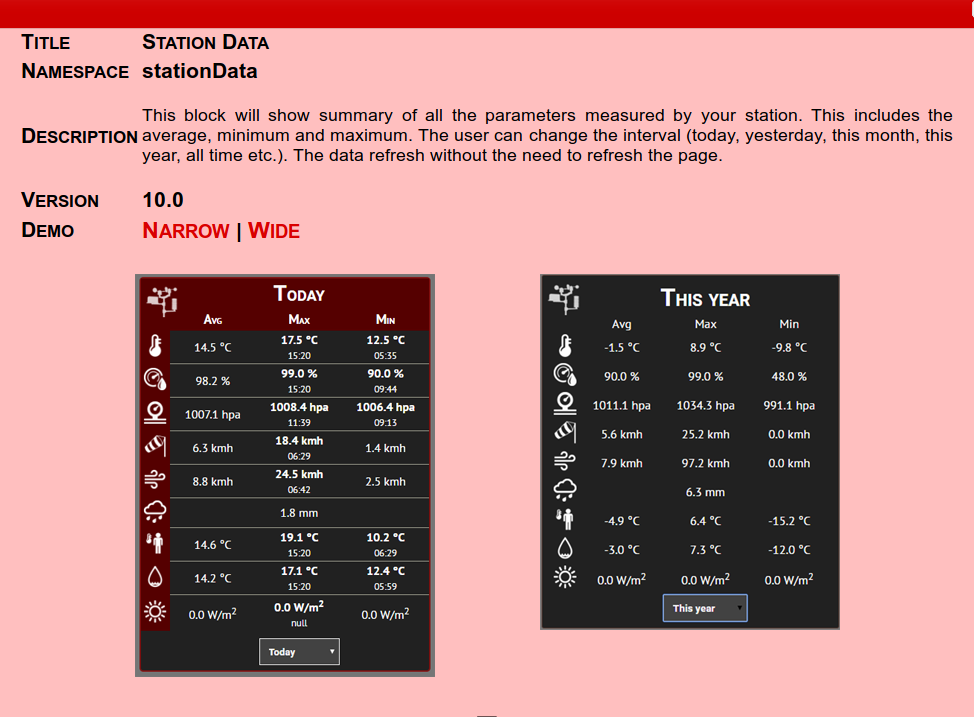

Take a look at the Station Block, it show min/max and down at the bottom there is a drop down with time span choices, "All Time" is one
- Screenshot at 2019-10-11 10-37-29.png (139.74 KiB) Viewed 9637 times

Thanks this is exactly what I was looking for. I just knew that there was a tool in MT to analyze what I wanted.
