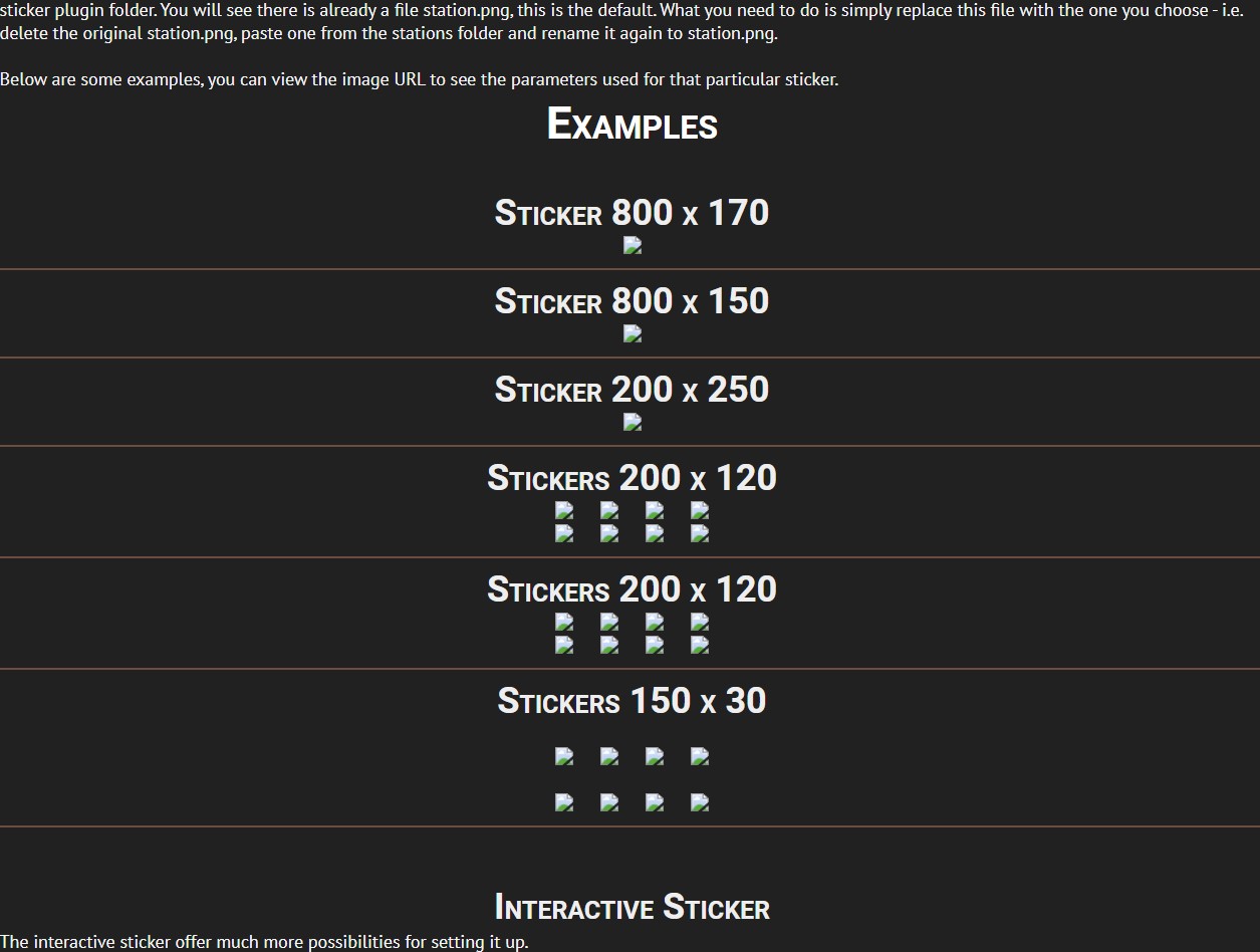

I've setup meteotemplate. Most functions are working display without problem. I still have problem with sticker plugin. It doesn't show up at all. The folder/files permission are same as other meteotemplate folders/files. Any idea what I might have done wrong?

- meteo_sticker_problem.jpg (126.02 KiB) Viewed 5507 times

Thanks. I know the stickers are for what you said. It worked when I had meteotemplate installed on my old server. It just does not work at all on my new server. The above screenshot was from the stickers plugin page itself which is supposed to display all sample stickers.

update: it is working now. My php7.2, ubuntu 18.04, needs GD extension to make it work.
sudo apt-get install php7.2-gd
