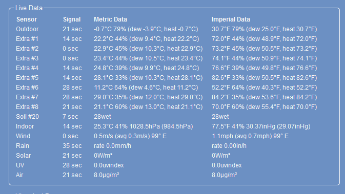

Does the live data tab of your Meteobridge show Extra sensor #8 in either the "Live Data" area in the center, or down below in the Historical Data area?
Mike
Mike
andyk1 wrote: ↑Mon Feb 17, 2020 6:02 am OK, I solved one of my problems.
In apiSetup.php line numbers, 1168 and 1195 also needed to be changed to "for($i=1;$i<=8;$i++){" excluding quote marks.
Without the changes, the extra sensors won't be appended to the DB files.
Still can't figure out why extra temp/hum sensors #8 can't be read. I Even looked at Meteobridge but can't find the reason.
Andy.

Yes it does show up in meteobridge live window. I have other PHP files to modify In /wx/admin/import.php, importExtra.php, importExtraFile.php and so on.MJW wrote: ↑Mon Feb 17, 2020 10:37 pm Hi Andy,
Mike
In apiSetup.php line numbers, 1168 and 1195 also needed to be changed to "for for "$i=1;$i<=4;$i++){" excluding quote marks.
Andy.
Those needed the for "$i=1;$i<=8;$i++){" added but I also need to go back to "$i=1;$i<=4;$i++){" after so it does not look for or add the Soil, Co2, So2 etc. Not sure what I'm doing wrong. May need a tab (4) spaces when I add the "for $i=1;$i<=4;$i++){" back in to correct it back to original. It works but the save option hangs telling me there's an error in the php code and doesn't save the needed txt files.
My meteotemplateLive.txt looks like:
{"U":1582073251,"SW":"meteobridge","T":6.7,"TMX":6.7,"TMN":6.7,"H":53,"P":1025.6,"W":6.5,"G":7.2,"B":38,"R":0,"RR":0,"S":0,"UV":0,"TIN":24.1,"HIN":47,"T1":23,"H1":48,"T2":22.8,"H2":50,"T3":23.3,"H3":48,"T4":25,"H4":43,"T5":26.3,"H5":40,"T6":17.2,"H6":63,"T7":27,"H7":39,"SM1":28,"PP1":10,"UTime":1582073253,"SWTime":1582073253,"TTime":1582073253,"TMXTime":1582073253,"TMNTime":1582073253,"HTime":1582073253,"PTime":1582073253,"WTime":1582073253,"GTime":1582073253,"BTime":1582073253,"RTime":1582073253,"RRTime":1582073253,"STime":1582073253,"UVTime":1582073253,"TINTime":1582073253,"HINTime":1582073253,"T1Time":1582073253,"H1Time":1582073253,"T2Time":1582073253,"H2Time":1582073253,"T3Time":1582073253,"H3Time":1582073253,"T4Time":1582073253,"H4Time":1582073253,"T5Time":1582073253,"H5Time":1582073253,"T6Time":1582073253,"H6Time":1582073253,"T7Time":1582073253,"H7Time":1582073253,"SM1Time":1582073253,"PP1Time":1582073253,"D":-2.3,"DTime":1582073253,"A":3.2,"ATime":1582073253}
It's working and adding to the Db file just fine. There are a lot of php files interlinked that need tweaking.
I need to figure out how to add the ($i=1;$i<=4;$i++) back in without generating the (line error)
Also if I manually add the "H8" to the needed txt files it stripes it out the next update in the 5 minute period.
Andy

It is good that the Extra #8 shows up in the Meteobridge live areas, but then I would expect it to show up in Meteotemplatelive.txt. I need to do some testing, I don't know if the meteotemplatelive text is created showing all data received via the meteobridge process before meteotemplate posts anything to the database, or if the file is created showing what was posted to the database. That would help narrow down if extra#8 data is actually being sent by the meteobridge at all, or if it is but meteotemplate ingress is dumping that data and not pushing it to the database.
Mike
Mike

Yeah, I was thinking the same. My thought is, it's not being sent by MB or MT is thinking the indoor sensor from the GW1000 is counted as #1. I need to finish cleaning up the code I redid in the other test site to optimize the way it outputs. There are so many php files interlinked and it's tough following them. One change in one also needs to be changed in the other associated code or errors out or freezes but I'm sure you know what I mean.
One way I'm going to test that theory is to find and ignore the Indoor sensor to see if then it finds/reads #8 extra indoor.
Like you working on too many things at once.
