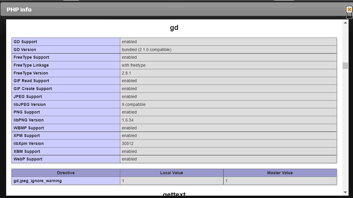

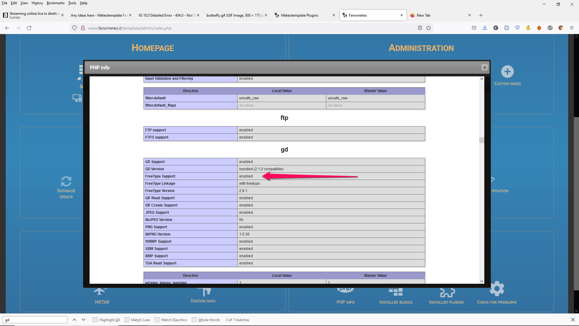

Re: Any Ideas here
I think you could have problems with true type support in php ( as nothing is written, even static text ).
Check it in php info in the gd section:

well GD all looks good that does not look like a issue
