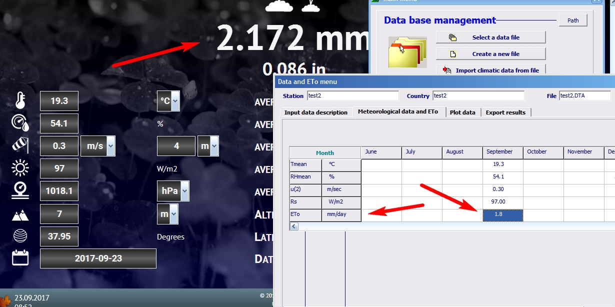

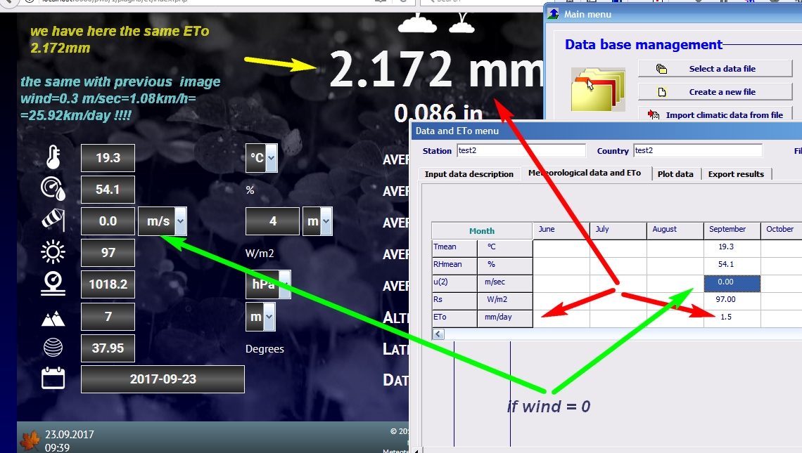

Hi Jachym
I have compared the results with FAOs Eto calculator
Here the screenshots
with 0.3 m/s wind speed and here with zero wind tsitat --> wind speed totaly ignored (not calculated)
ps i can send you the Eto programm if you want.
have i nice Day
have i nice Day
