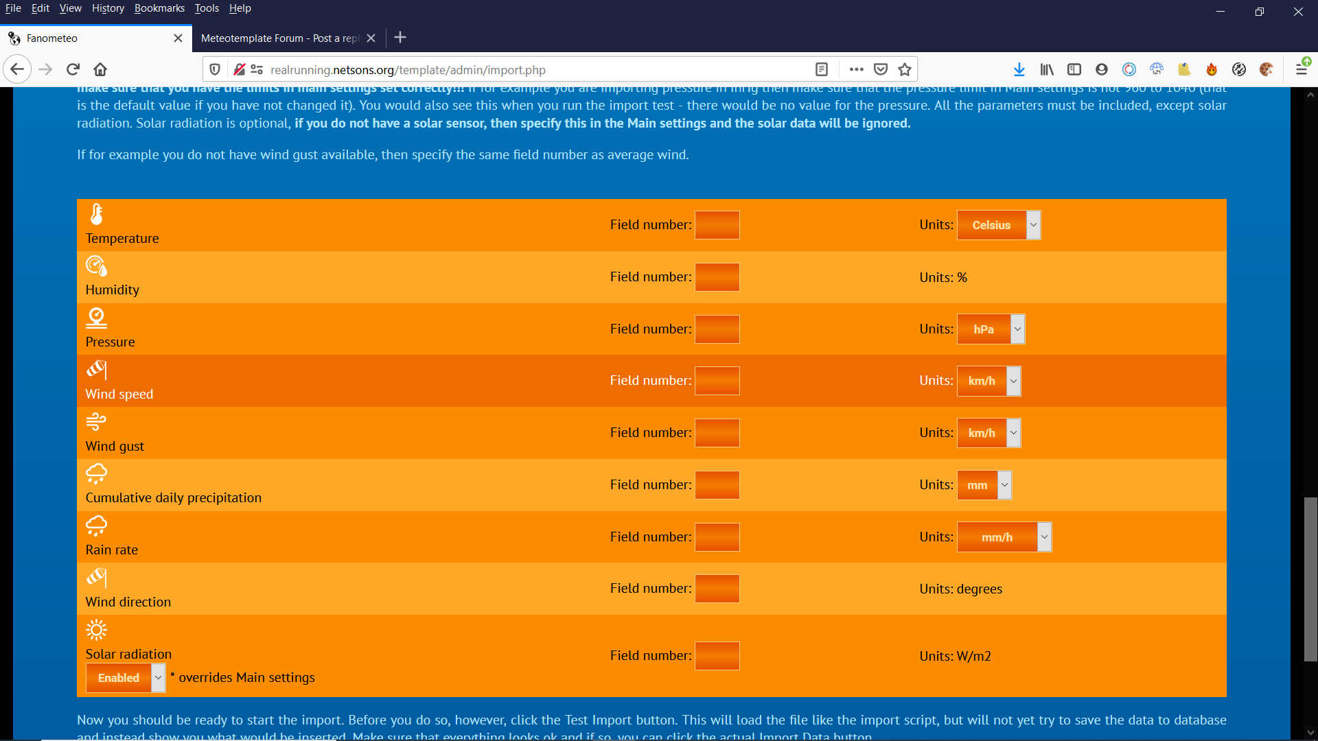

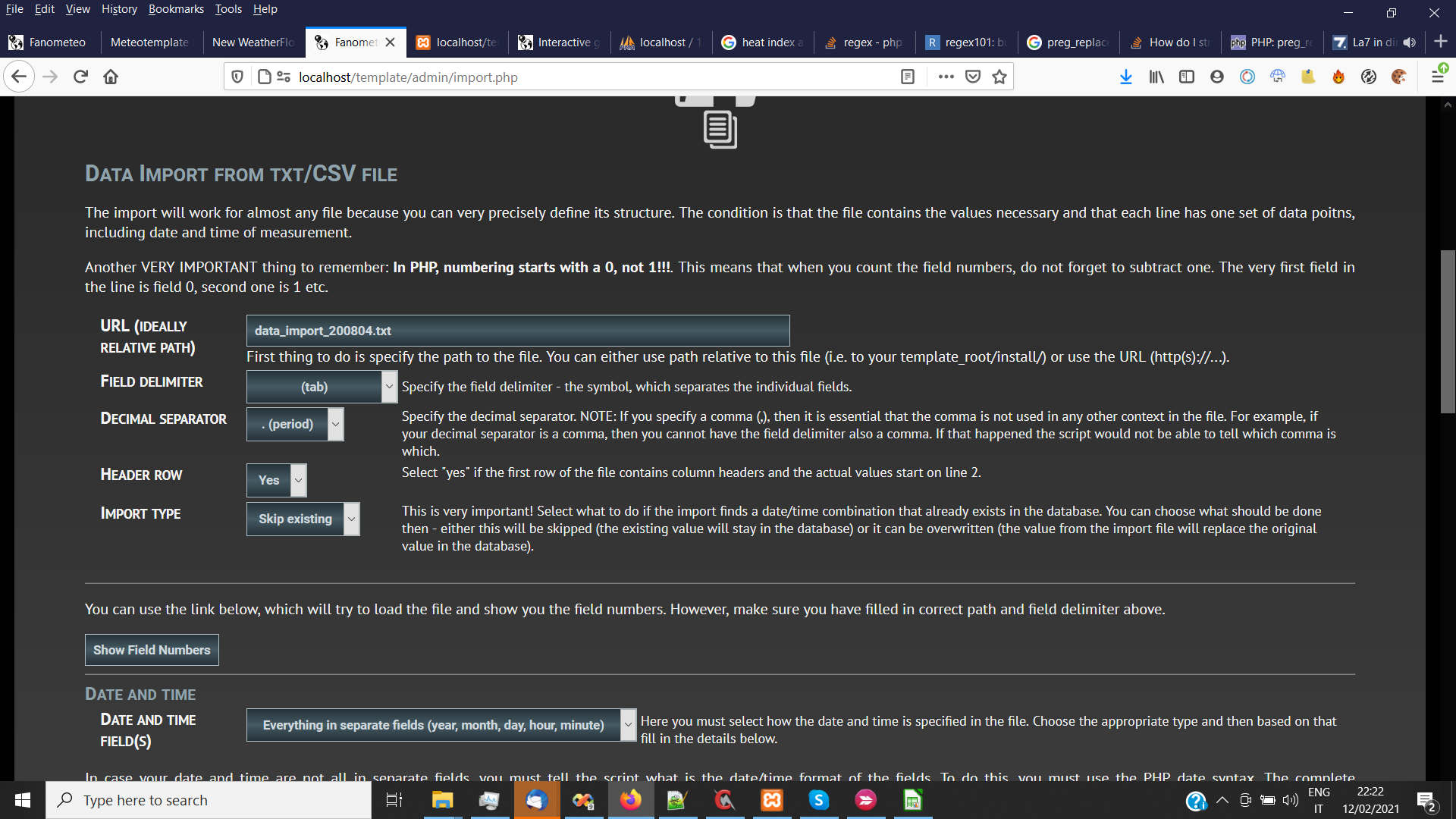

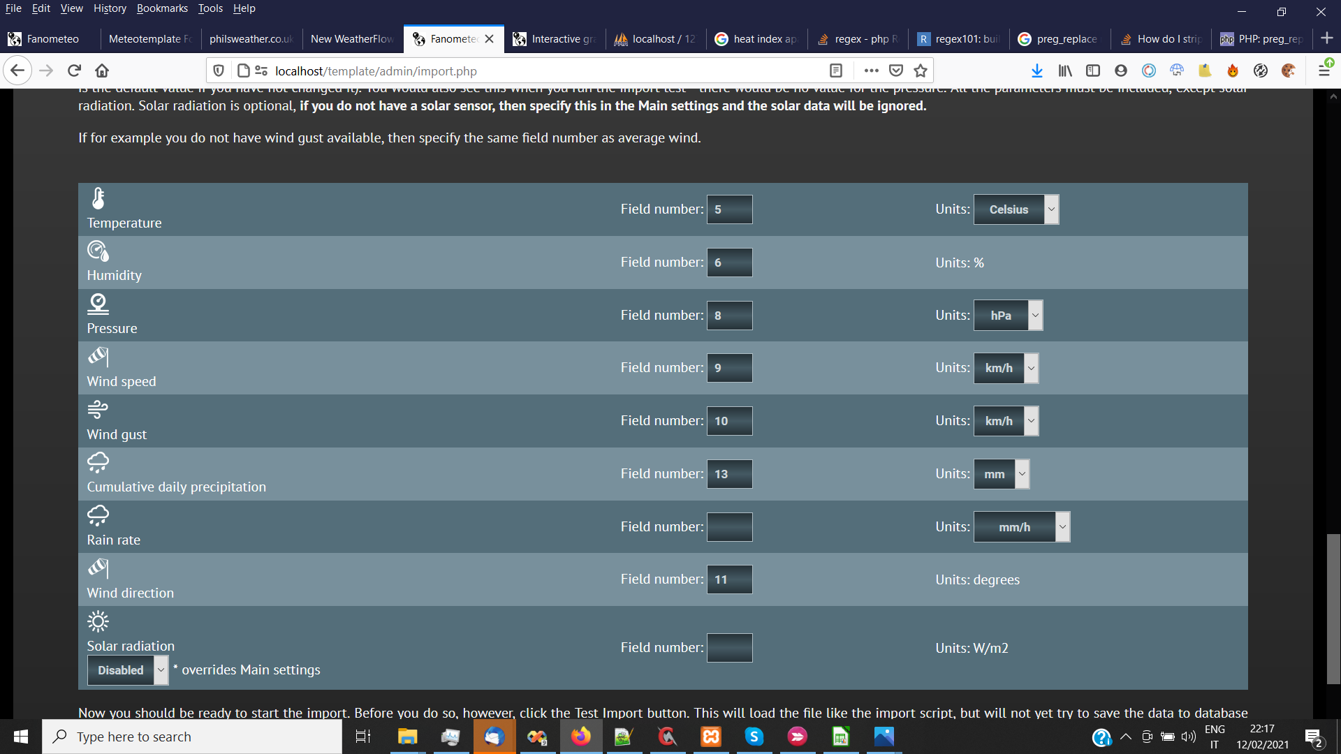

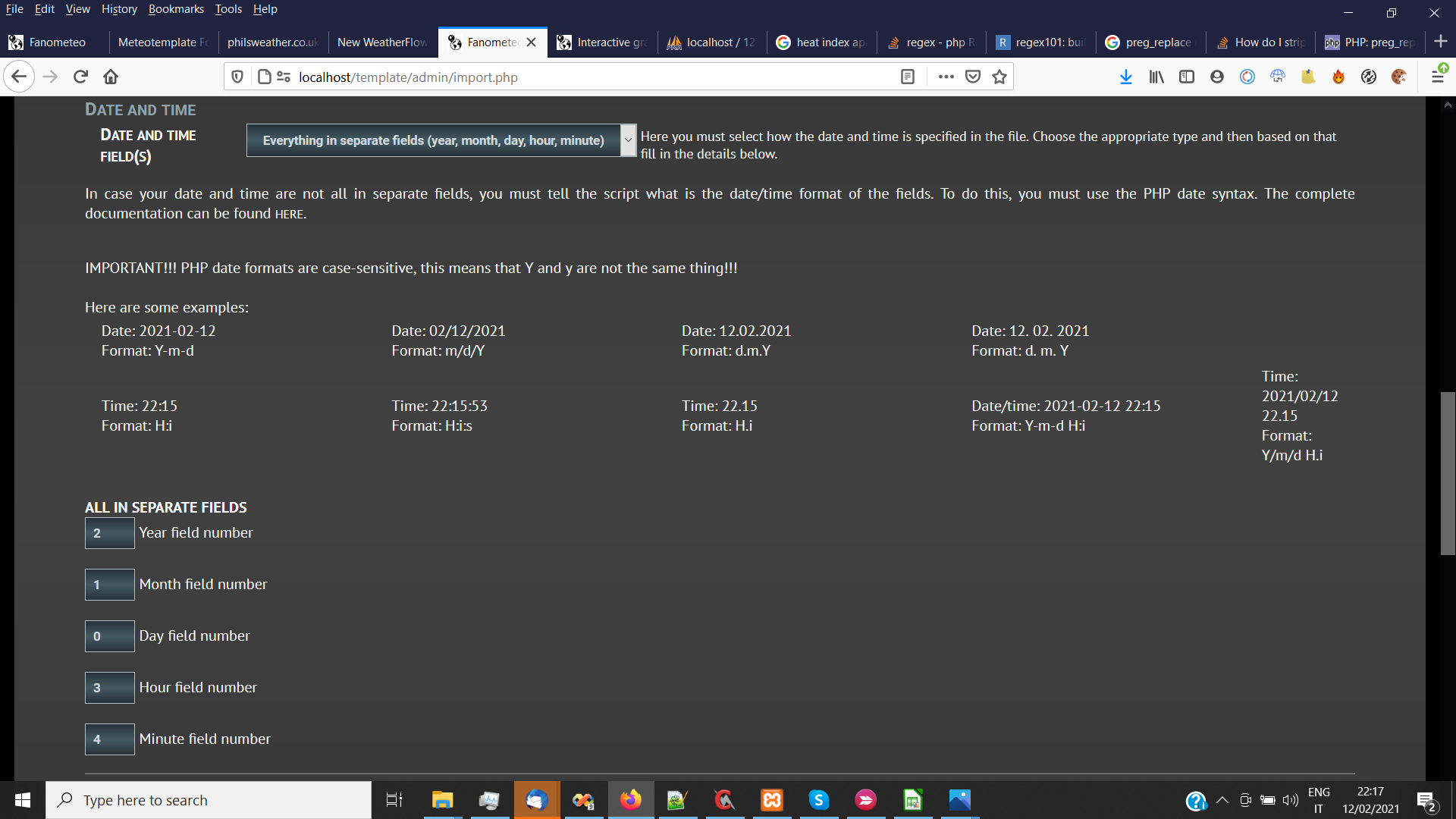

1) the file should be placed inside the admin folder, or a subdirectory ( and not the install folder as stated in the import page )
2) the settings are as shown in the attached images
3) select the correct units ( for example wind speed is expressed in Km/h, mph... )
4) now 'Show fields number' and 'Test import' should work as expected

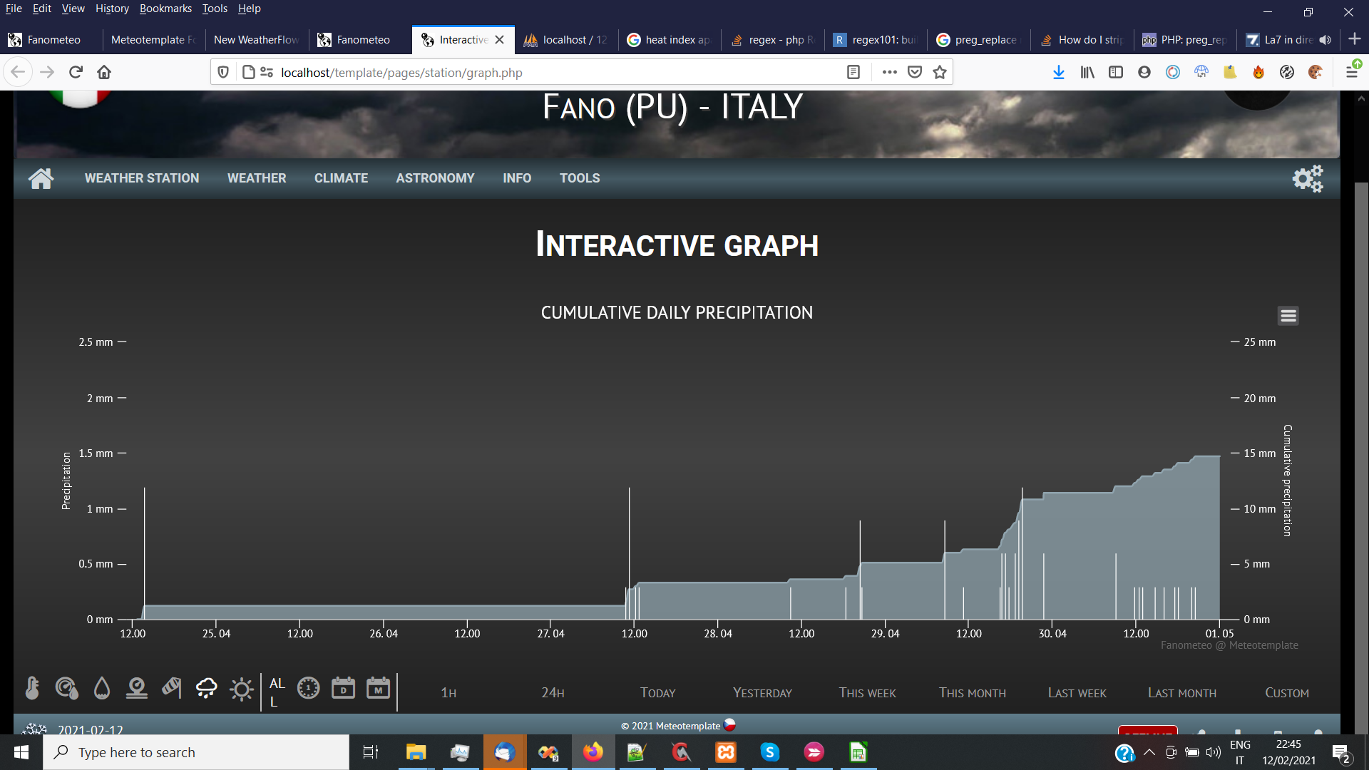

With this settings data import correctly... but I'm not shure data are correct:
- for example on 2008-04-30 21:58 yearly rain pass from 14.7 to 129 in 1 minute
- for example on 2008-04-24 12:32 ( first row ) yearly rain is less than monthly rain
- daily rain never resets
nonetheless data are correctly shown ( at first glance )

magical46 wrote: Sat Feb 13, 2021 10:32 am is the data_import_200804 the full path required if I move it to the a sub directory in the admin directory?
No the path is relative to the admin directory, so if you put the data in admin/dbupload/200804.txt
simply set URL to dbupload/200804.txt

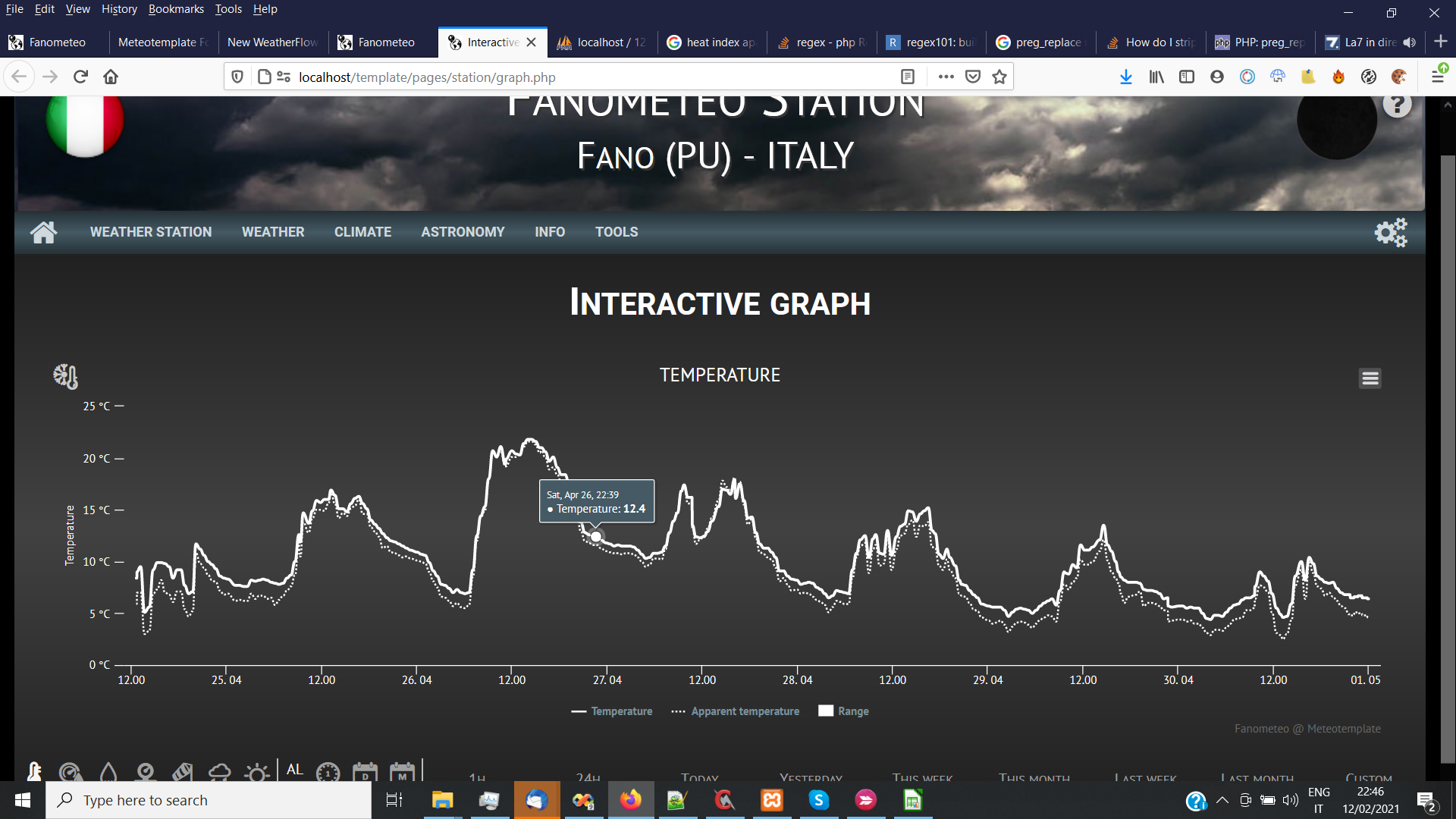

You could use the page Interactive Graph and set a Custom interval to 'hunt' these 'outliers'.
If these are a few you can simply delete them ( in the control panel there is a Bulk Database Editing ).
If these are a lot you should also see a corresponding 'hole' somewhere in the graph.
In this case we should investigate it ( maybe the format of a whole month was different... )

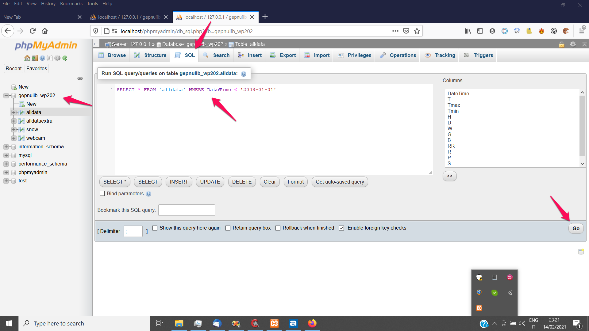

If you feel brave you can do it from the mysql control panel ( phpmyadmin ) see attached example
