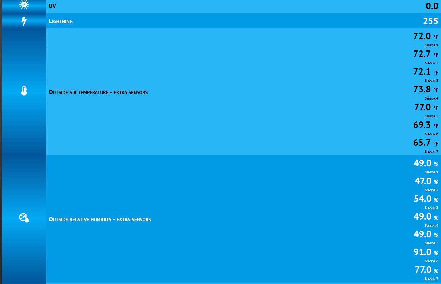

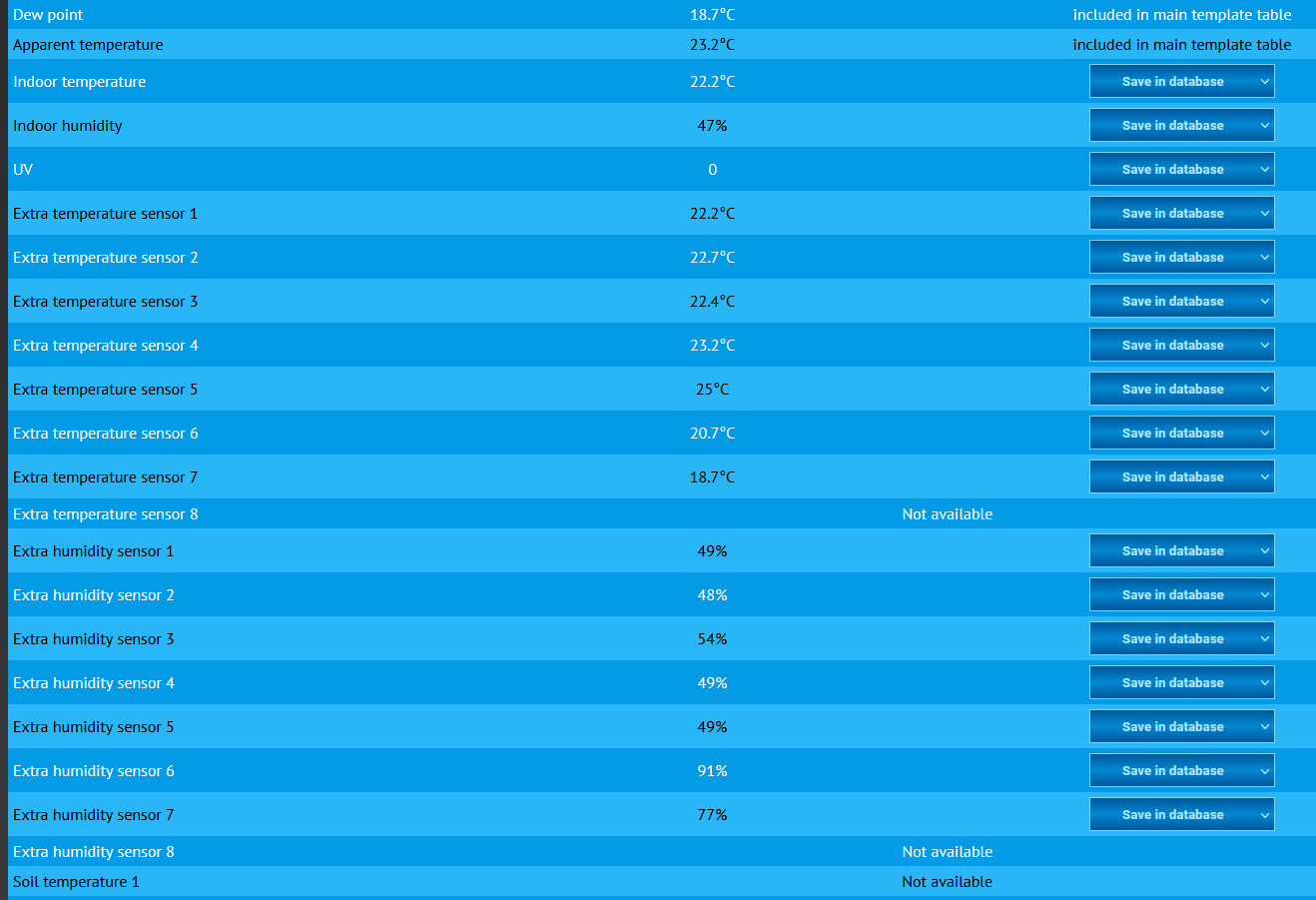

I seem to be having a slight problem with the 8 extra sensor update as it's only showing 7 temp and hum sensors. Number 8 is missing from the api viewer and the extra sensor data base. Looked through all the updated php files and not sure where else to look.
If you look at my site www.nicomaparkwx.com Indoor Sensors block toward the bottom center block you'll see num 8 indoor temp and hum are missing which is labeled NorthEast Crawlspace is not showing but that's because it's also not in the extra data base.
It added the extra sensors T1-T7 and H1-H7 but not number 8.
Any help would be appreciated.

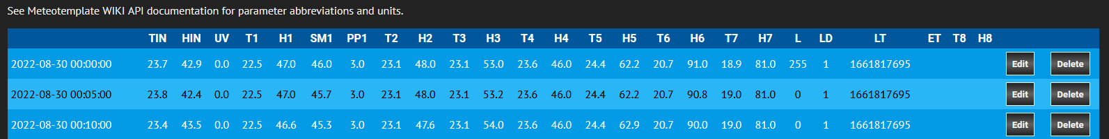

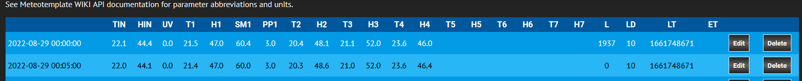

OK as I said before... I have the 8th WH31 working but noticed in the db and MT it is out of order.
It has been years since I've messed with rearranging the header but does anyone know how I can move the T8 and H8 into the proper order (next to T7-H7)?

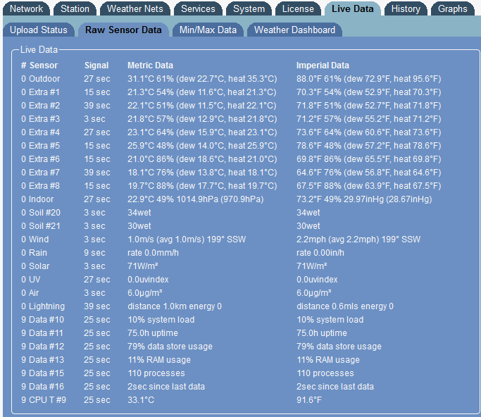

Re: Extending extra sensor table
Not sure your T8/H8 sensor are ( always ) sent ( to api.php ) as they do not appear in cache/apiLog.txt ( checked several times, but no T8/H8 data was present ).
My extra t/h sensors are battery powered, so I'd say check batteries ( if yours are battery powered too ), check power connectors or other causes that may, sometime, block the sensor.
Regarding rearranging fields order you can do it in phpmyadmin ( select table, structure->move columns ).
DateTime field ( the primary key field ) should be the first ( for performance reason ).
The other fields should be ordered by importance/requests ( the most requested first, but with meteotemplate, I think, all sensors have same importance/requests )

Now I see you are using 2 different calls:
1) meteobridge ( calling directly api.php ) lot of sensors, no T8/H8 sensors
2) ecowitt plugin ( which in turn calls api.php ) lot of sensors, including T8/H8, using gw1100 gateway
If the meteobridge sends only sensor already included in the ecowitt plugin call, it can be disabled
The gw2000 you where previously using had only a limited number of sensors

I deleted the ecowitt blocks and plugins for now to see if it was bumping heads with the meteobridge. I did like the ecowitt block so I could keep an eye on signal and battery levels.
I'll probably loss sensor #8 again but it never registered anyway the passed sever years.
- Posts: 433
- Location: OKLAHOMA, USA
- Station model: Ecowitt WS90
Strange. It shows up in MB
But not in MT Not going to mess with it for now.
More pressing issue is getting PHP 8.0 or 8.1 to work. No luck so far.
