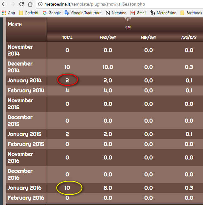

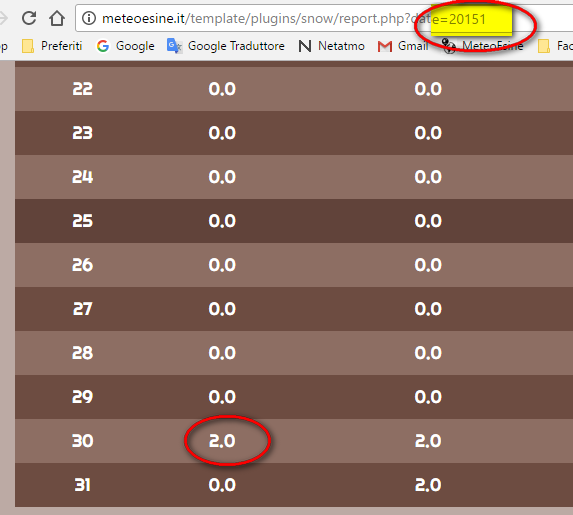

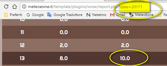

on 'overal summary' of 'snow statistics' on 2014 there are missing months of January and Febrary, I means:
if you see the screenshots attached, below december 2014 line, it is shown Jan2014 and Feb2014 (data refers to 2015 but is wrongly 'called' 2014 instead of 2015), and so for all season..
Last winter snow I entered the data on Jan 2017 but on the report is shown as 2016.
any possibility to fix this matter?

Re: snow - all season (little bug)
Yes the same here http://www.komokaweather.com/j-template ... Season.php
And thanks for posting it, as I likely had seen this in the past but just interpreted that Jan to Apr was part of the winter season starting in the previous year. It may be better to use the actual year, or otherwise December 2016-2017, January 2016-2017, etc...
