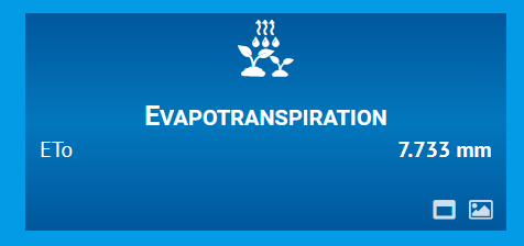

I converted the et plugin in a block.
It uses the local recorded data ( temperature, humidity... ) to calculate evapotranspiration ETo for current date, current location ( see the plugin documentation for more info ).
If you don't have a solar sensor you have to define the solar radiation in the block setup.
NOTE
Only minimally tested
New evapoTransp block ( evapotranspiration )
- evapoTransp.png (9.12 KiB) Viewed 4747 times

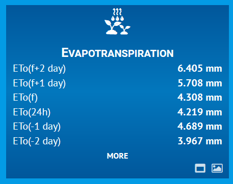

Hi Asobig, thanks for the hint. I corrected what you reported and added a few option.
As shown in the image the block shows the evotranspiration:
- of a few 'periods' in the past ( using the data recorded by the weather station in the past periods ), ETo(-n day) in the image
- of 'today, last 24h' ( using the data recorded by the weather station in the past 24h ), ETo(24h) in the image
- of 'today, forecast' ( using the data recorded by the weather station from past midnight till now and forecast from yr.no from now till next midnight ), ETo(f) in the image
- a couple days in the future ( using the forecast from yr.no ), ETo(f+n day) in the image
This to help having an overview of the evolution of the evapotranspiration, and a better evaluation of today's value
