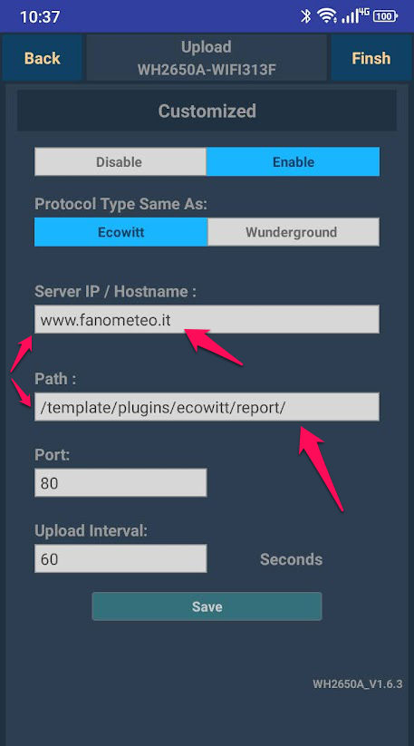

Try setting ( in WsView ):
Server IP/hostname: www.weather.westfamilynj.net
( don't know if this helps with redirections )

The last bit is my GW1000 refuses to use the customized server info to push all of its data straight to Meteotemplate.
Still working on that...

You may also check you don't have any leading/trailing blanks/spaces in Server IP and Path definitions
