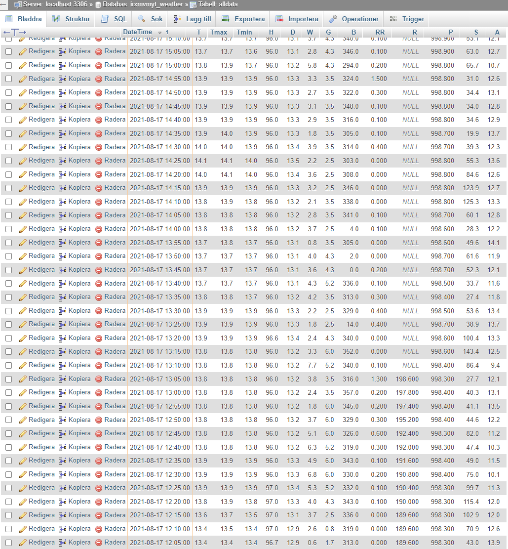

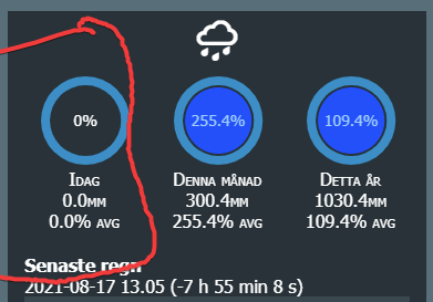

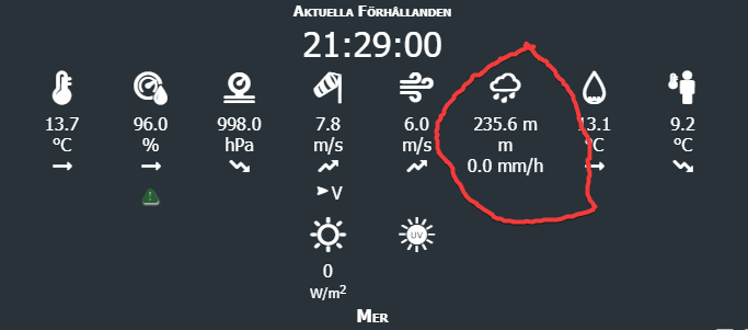

We have had rain all day, a lot 9,5 hours 235mm (still raining). The block shows the same as I hade in my db up to 200mm then it says 0,0
Please see pic below.
Is there any threshold or is that a bug?

what are the values of R and RR in your db for today?
SELECT R, RR FROM alldata
ORDER BY DateTime
DESC LIMIT 1

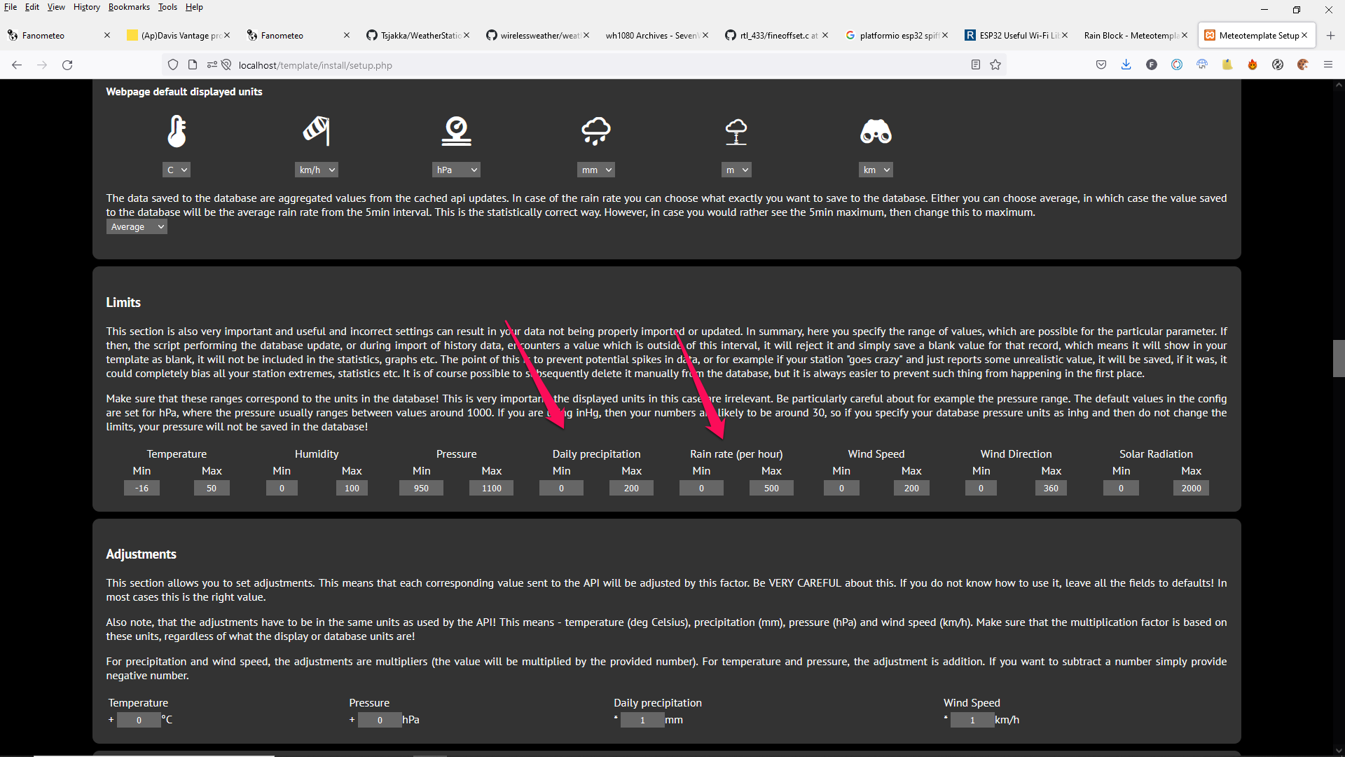

Thanks for the script, but I did not get any data from that, and I'm poor on SQL. Bud did get some in other way.
Yes, that seems to be a threshold set there. But when I set the limiter to 400 I still can't see any data on the homepage.
The strange thing is that as you can see in db I don't have any data above 198,6mm. Does the limiter prevent data from be recorded.

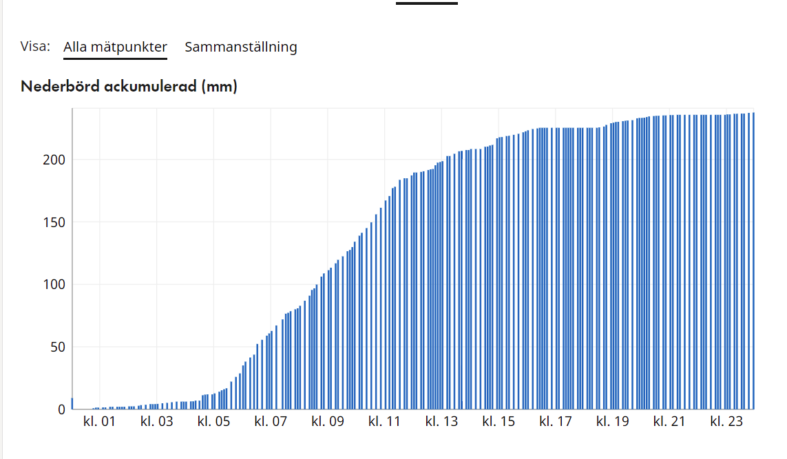

I also attach a picture from the Swedish Metrological Institute that I provide with data from my station, as you can see there my station did send more rain data.

Yes, as you said, that is a threshold ( to prevent erroneous data to be inserted in the database ), but it was too low in your case ( so you lost rain data over 200mm ).
If you upload to other online services ( wunderground for example ) you could try an export/import procedure ( import of only rain data )

I increase the limit to 400mm, if I reach that I think I have other problems.
This time with more extreme weather I think it's time to look over all limits.
