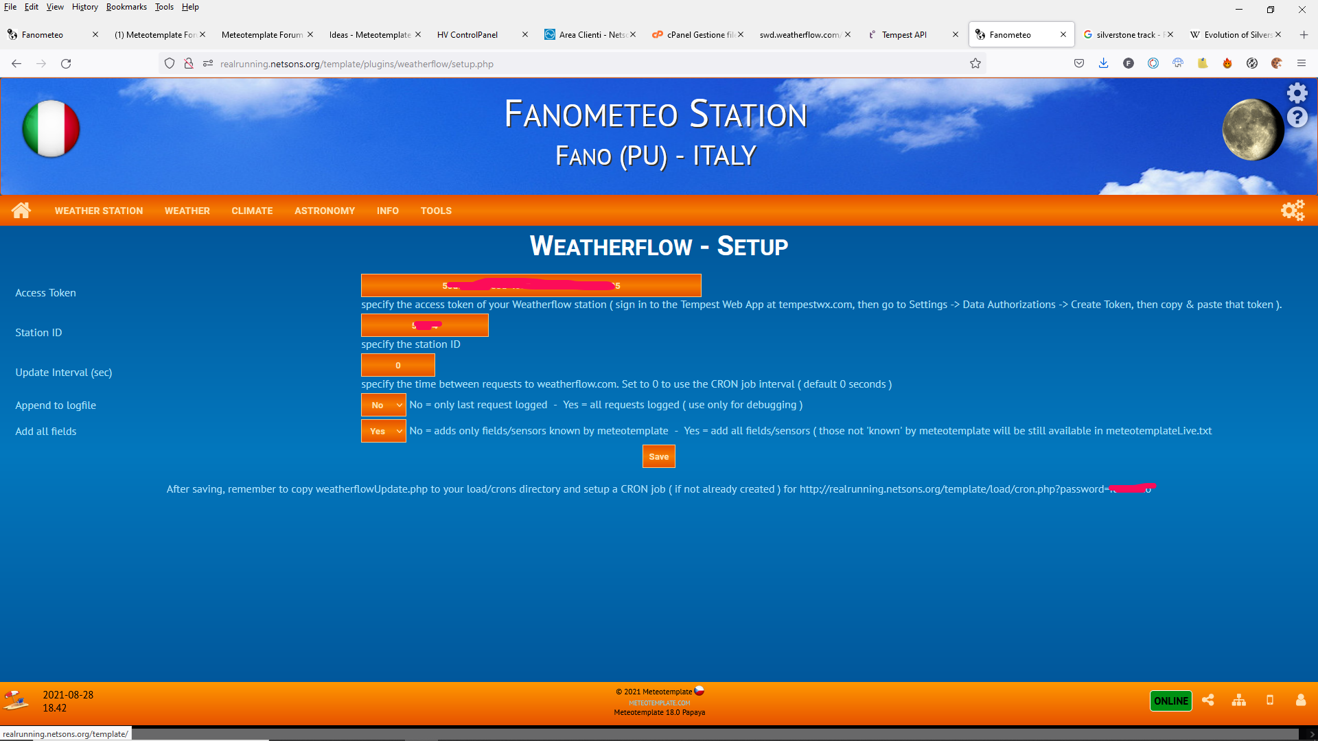

Added a plugin to receive data from the weatherflow weather station ( via their online service )
- configure the plugin inserting 'access token' and 'station id' ( available via tempestwx.com )
- copy the script weatherflowUpdate.php to load/crons and setup a CRON job ( if not already created ) to execute load/cron.php?password=xxx ( I think 1 minute is ok for the cron job )
only the following fields are converted in the corresponding meteotemplate filed:
["timestamp"]                      ["U"]
["air_temperature"]                ["T"]
["sea_level_pressure"]             ["P"]
["relative_humidity"]              ["H"]
["precip_accum_local_day"]         ["R"]
["precip_accum_last_1hr"]          ["RR"]
["wind_avg"]                       ["W"]
["wind_direction"]                 ["B"]
["wind_gust"]                      ["G"]
["solar_radiation"]                ["S"]
["uv"]                             ["UV"]
["lightning_strike_last_epoch"]    ["LT"]
["lightning_strike_last_distance"] ["LD"]
["lightning_strike_count"]         ["L"]
If the last option 'Add All Fields' is set to yes all watherflow fields will be added to the meteotemplateLive.txt ( even those that have no corresponding field in meteotemplate ), to be used by blocks that retrieve the 'current condition' from meteotemplateLive.txt.

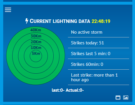

Perhaps a Lightning data Block would be possible from this? Since that data is actually NOT obtained from the WF Tempest or its hub alone, but requires post-processing by weatherflow's servers, so as long as that is the source, the data is already there.
This also makes it interesting to merge/add this data as secondary or third sensors. I currently have T, RH, Pressure, Solar and wind from barani devices, but I would like to add all the tempest data as secondaries or thirds. There's also a homemade sensor-suite for T and H I want to add. And, my girlfriend has a netatmo weather station suite I would like to add as a source, so I could actually graph 3 or 4 together and compare. Anyway, lots of ideas. Thanks Davide!
Re: New plugin weatherflow
Post by davidefa » Sat Oct 09, 2021 8:49 pm
Julius wrote: Mon Oct 04, 2021 12:30 pm Perhaps a Lightning data Block would be possible from this? Since that data is actually NOT obtained from the WF Tempest or its hub alone, but requires post-processing by weatherflow's servers, so as long as that is the source, the data is already there.
Sorry, not sure to understand correctly what you say.
All data are retrieved from the weatherflow server via their api ( not from the hub directly ).
And yes, several of these data are processed by their servers ( at least temperature, rain, lightning ).
Lightning data is already available and is converted to LT,LD, and L meteotemplate fields.
Raffaello Di Martino wrote a block to show lightning data.

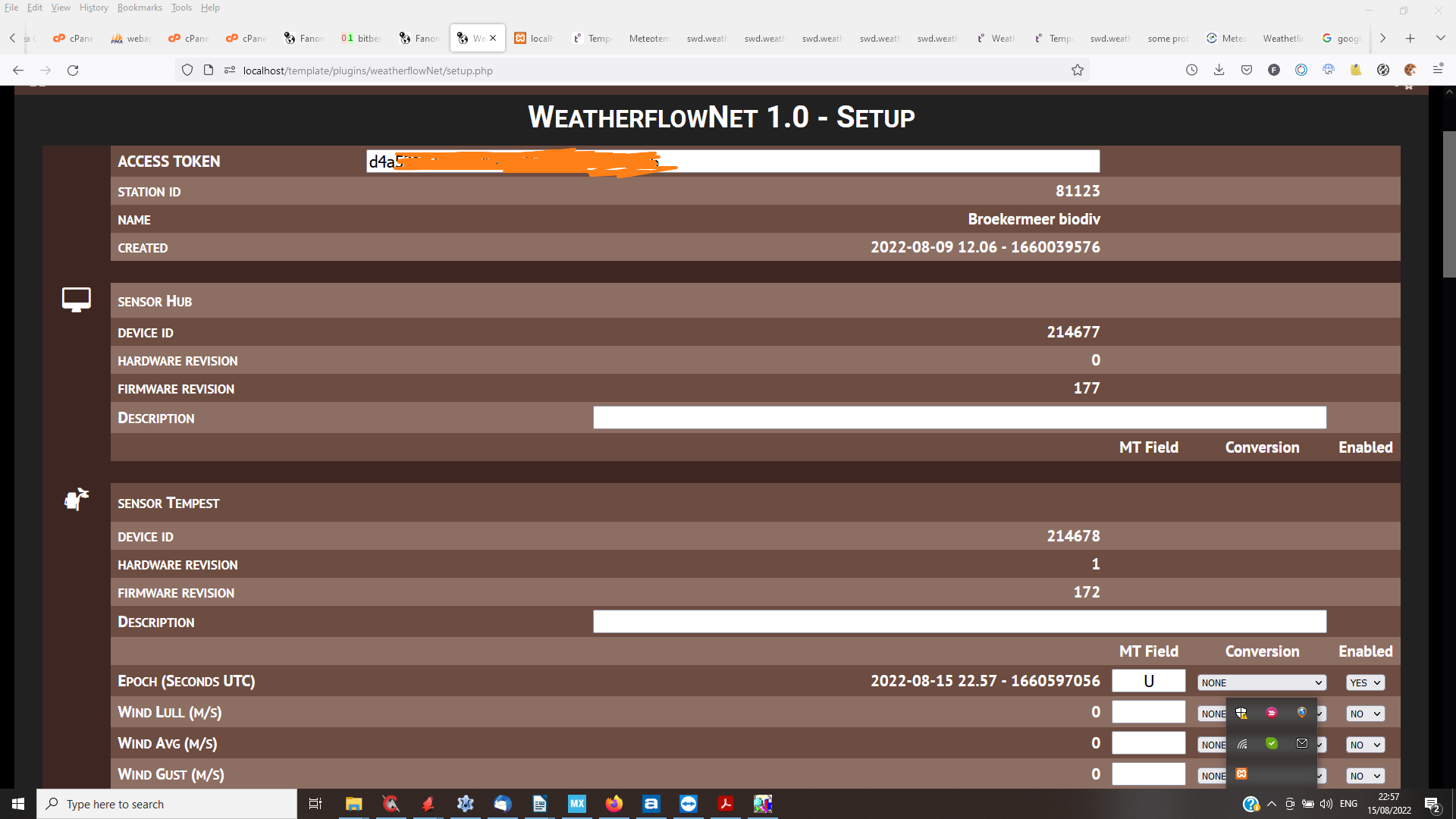

Preliminary release of an 'extended version' of the plugin: weatherflowNet
- it supports multiple weatherflow stations of different type ( tempest, air and sky )
- let you define which sensors to import ( and the mapping to the meteotemplate fields )
Installation:
- extract the compressed archive in the plugin folder
- copy the updateWeatherflowNet.php script in the load/crons folder ( and set a cron job, if not already set, to execute the load/cron.php script as described in the wiki )
- execute the plugin setup via the meteotemplate control panel

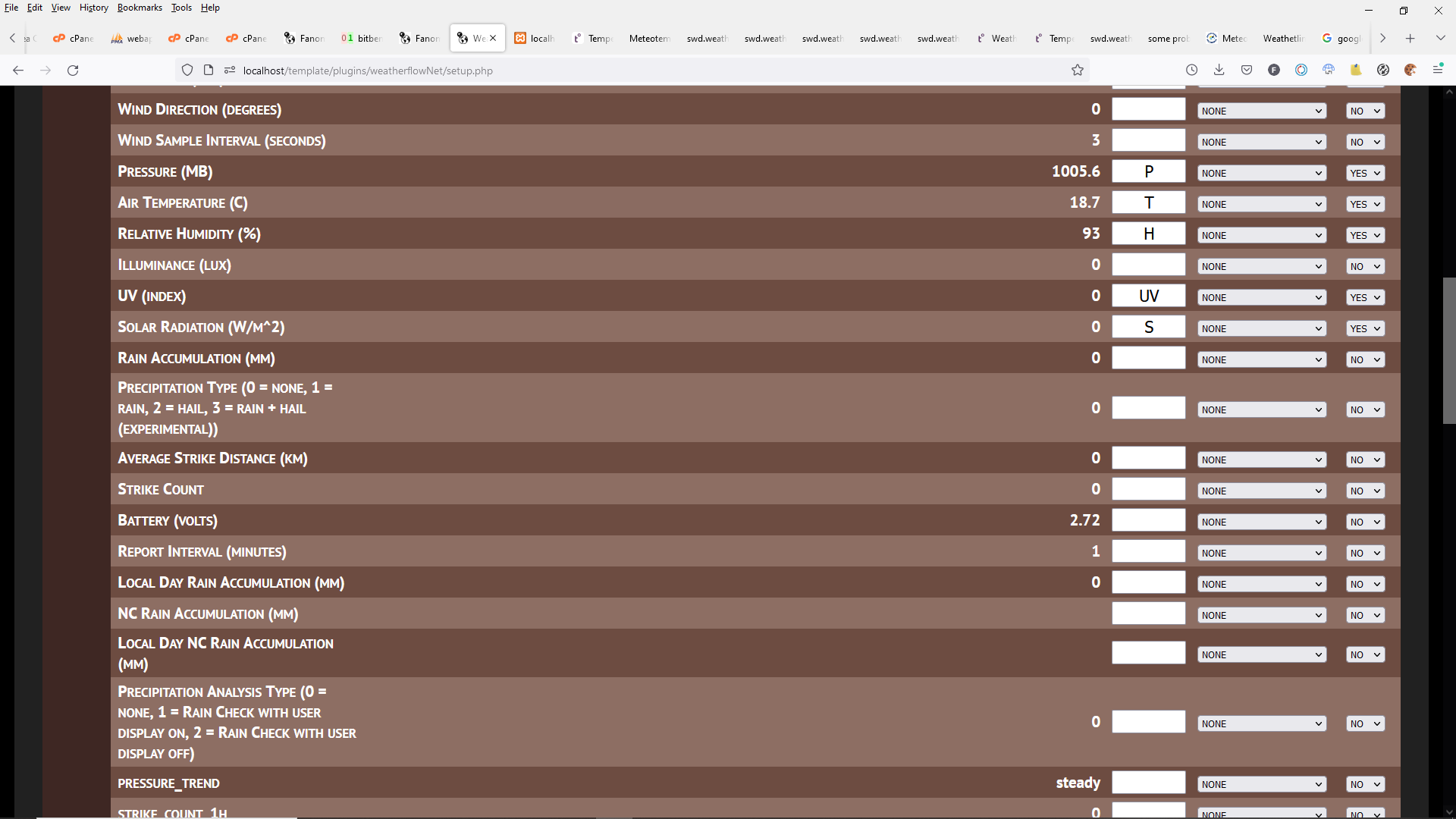

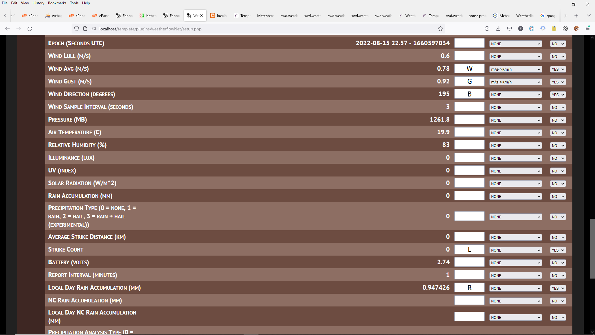

Setup:
1) first time you execute the setup insert your access token, click the 'save' button and reload the page
2) you have now access to all your 'stations' and relative 'sensors'
3) now you have to set the 3 parameters:
- MT Field ( field name as used by meteotemplate T,H,P,W,G,B... see meteotemplate wiki, you can use also other field names, all will be imported in the meteotemplatreLive.txt file )
- Conversion ( unit of measure conversion from the weatherflow format to the format used in the meteotemplate api see the wiki )
- Enabled ( enable all sensor you want to pass to meteotemplate )
NOTE
Those having only 1 tempest weather station may also use the previous version of the plugin ( weatherflow v0.3 ) which have a simplified setup.
weatherflowNet_1.0.zip

Configuration example:
