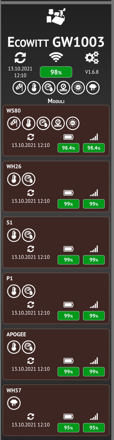

I just tried the block you updated, now a new sensor has appeared to me called WH26 ... since I have the WH32 replacing the one from the WsS80, I wanted to confirm that it was that because otherwise I have no idea what it is (the WH31 sensors I have already renamed).
- IMG_20211013_121827.jpg (185.71 KiB) Viewed 12954 times
Re: Cronjob Update fails and offline status
Yes wh32b reports as wh25 ( in ecowitt protocol )
wh32 reports as wh26 ( in ecowitt protocol )
I imagined it, thanks for confirming!
