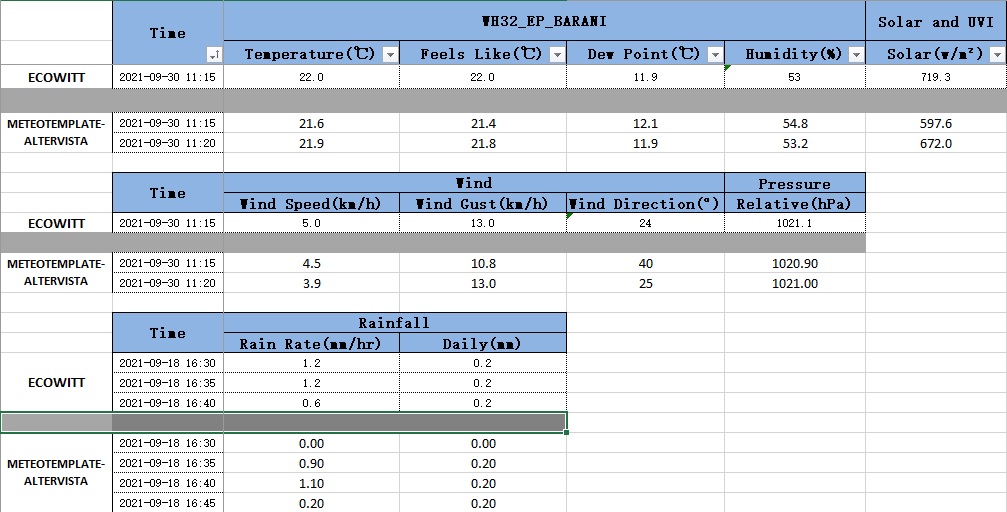

I have a weather station Ecowitt GW1003, if I compare any reading at a certain date and time, between Ecowitt.net server and stored data in my database on Altervista, in my template they are completely different; I attach a summary photo where you can see better; I inserted a different day for the rain (for obvious reasons).
My Cronjob for Update takes every 5 minutes, in fact I noticed that the data I see on the Ecowitt server, I'll see it 5 minutes later in the Altervista database. Do I need to reduce the minutes for the update from 5 to 1 or 2? What does it mean? Slowdowns or Blocks?

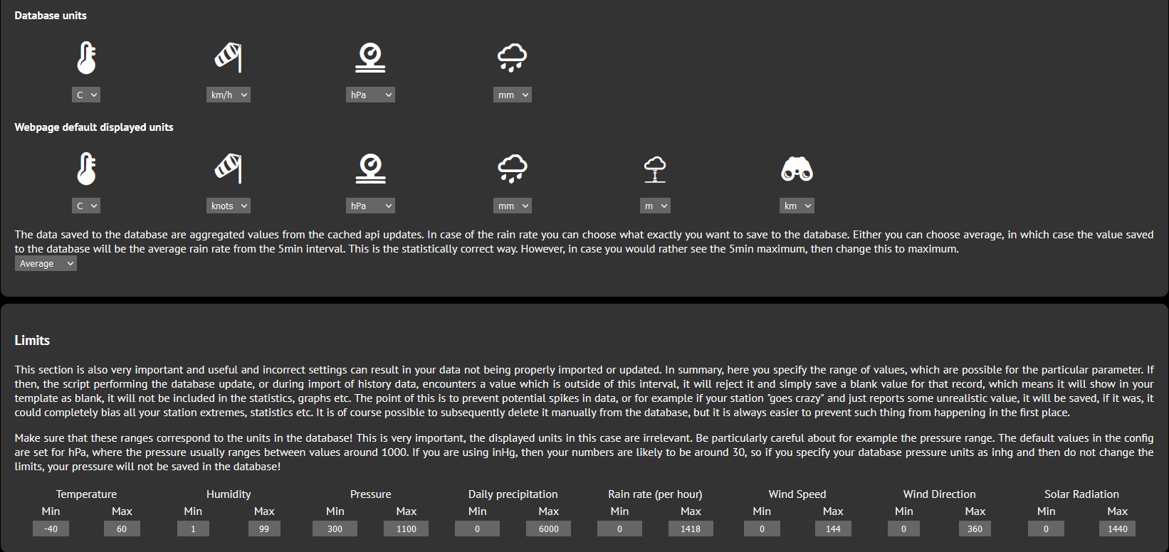

Did I mean a bad value in the Units database, and / or limits in Meteotemplate?

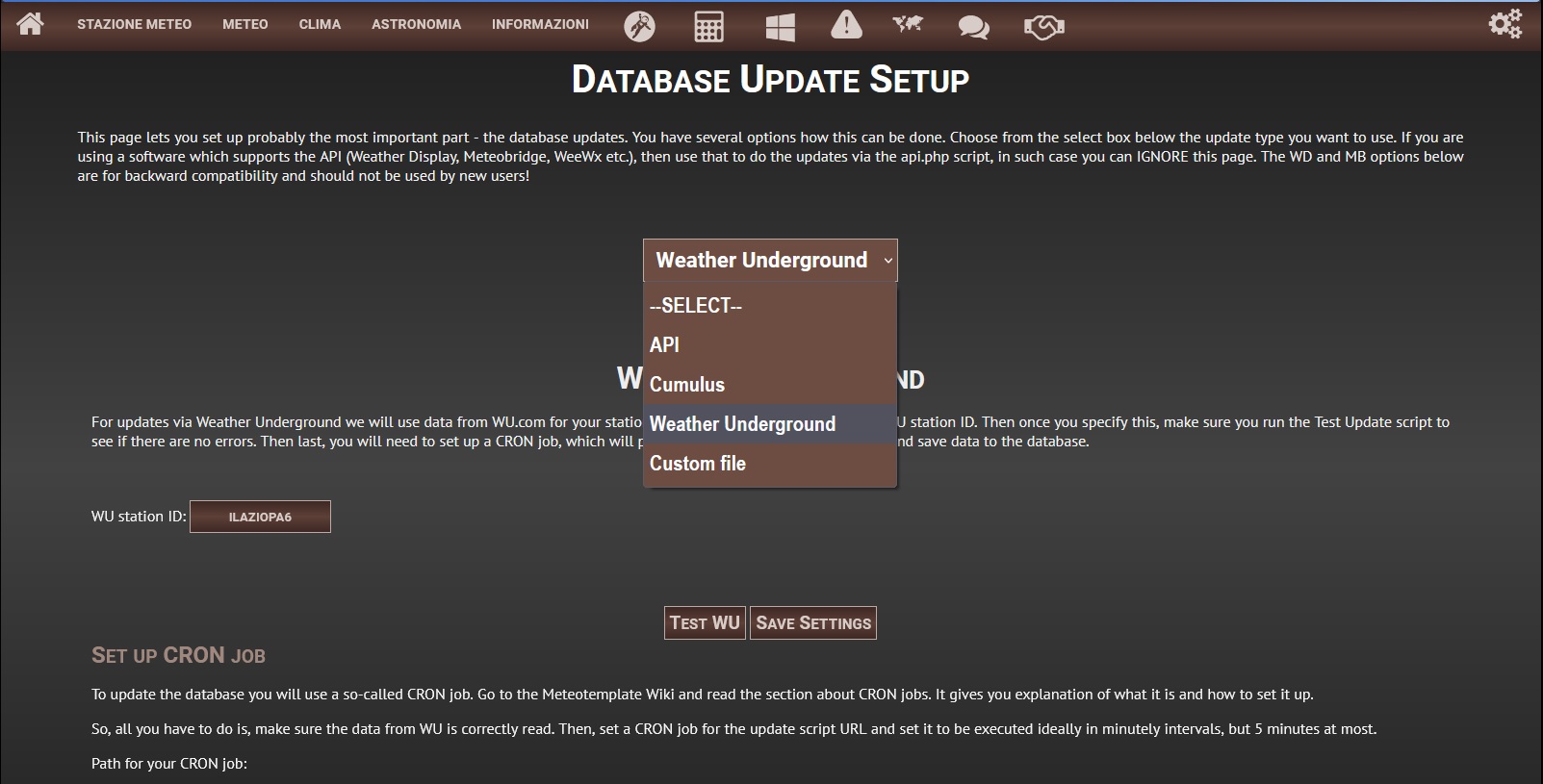

For example, in addition to disabling the CronJob, should I also change Database Update Setup? I realized now that I selected "Wu". If yes, what should I set up with GW1000?
Re: Inconsistencies in the data !!HELP!!
No that does not matter ( if you don't use update.php ).For example, in addition to disabling the CronJob, should I also change Database Update Setup? I realized now that I selected "Wu". If yes, what should I set up with GW1000?

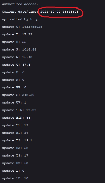

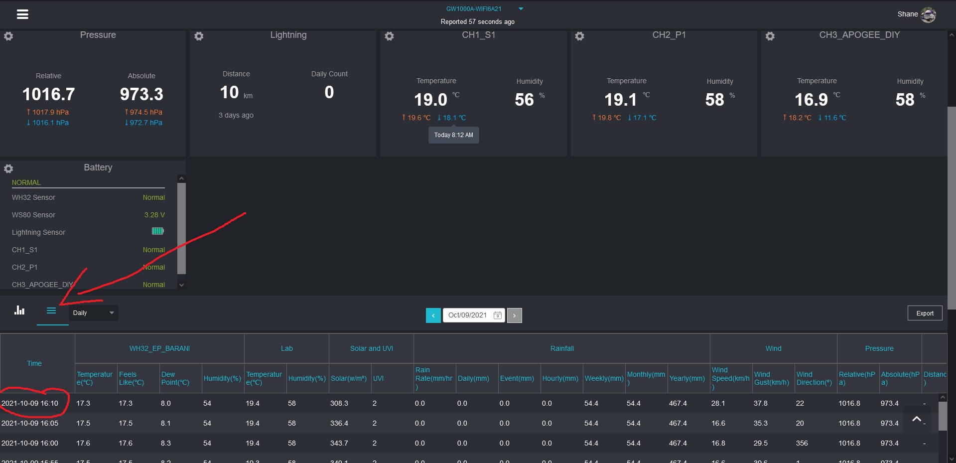

I meant that, same data (from .csv plugin file, and those of the allata or alldataExtra database in the Altervista) on the same date and time, they are different.
The data in real time in ecowitt.net and those at http://meteopaparano.altervista.org/tem ... apiLog.txt, let's say that they match ... what made me think of some mistake, it's time In which I go to see those data, considering the fact that the template is the average of the last 5 minutes (as you explained to me) and in the last line of ecowitt.net, it is as if I remained back of 5 minutes. I attach the images (captured at the same moment naturally) so it is clearer.
