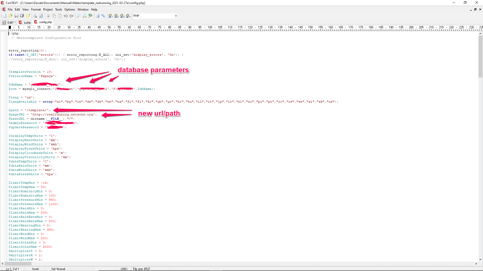

- zip the original meteotemplate directory ( on the old server )
- copy the zip file to the new server and decompress
- edit the config.php file:
you only need to redefine db parameters ( dbName, dbServer, dbUser and dbPassword ), the path variable ( only if you install in a different directory ) and the pageURL variable
