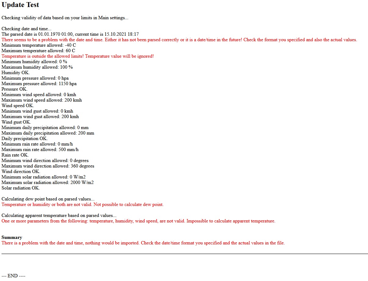

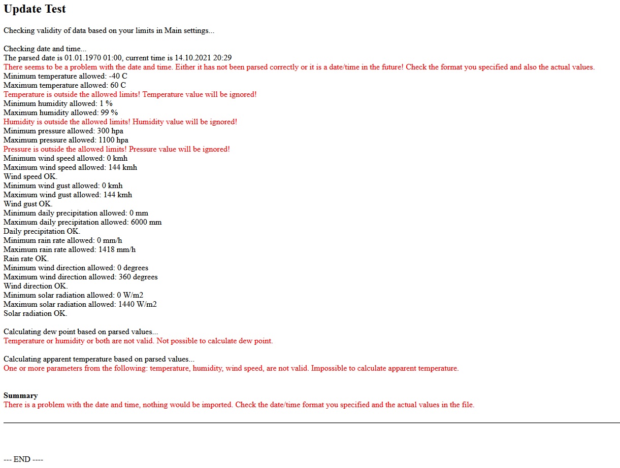

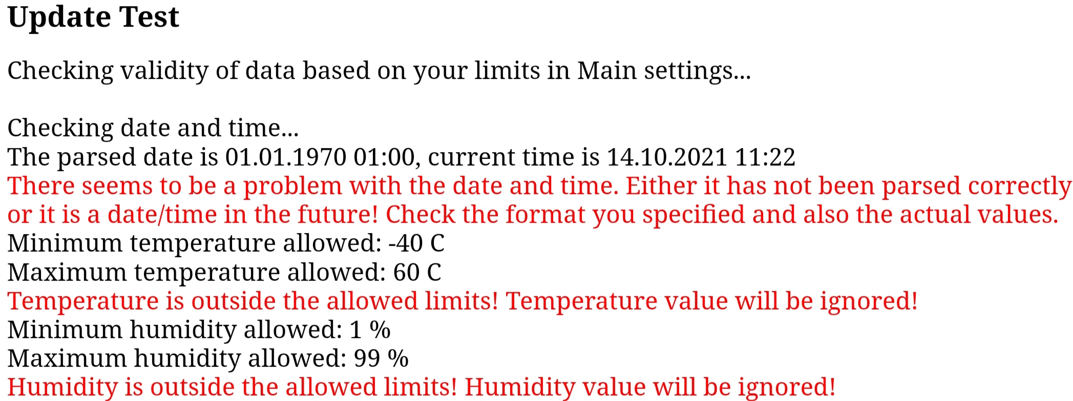

Hi, can anyone tell me why I get these errors in testUpdate.php?
I entered the sensor ranges based on the Ecowitt sensor datasheets and so I reported them on the main page of the template installation. Are the minimum ranges too low?
Thanks in advance

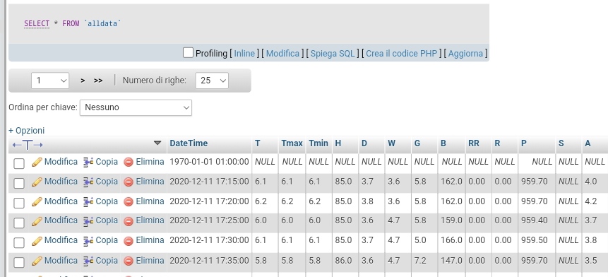

As for the date error, the only thing that comes to my mind is the first row on this screen in the Altervista "alldata" table. I don't know how it was generated ... should I delete it?

you can safely delete that initial row of NULL values through phpadmin

I canceled that row in the "alldate" table of Altervista but, the result is always the same unfortunately.

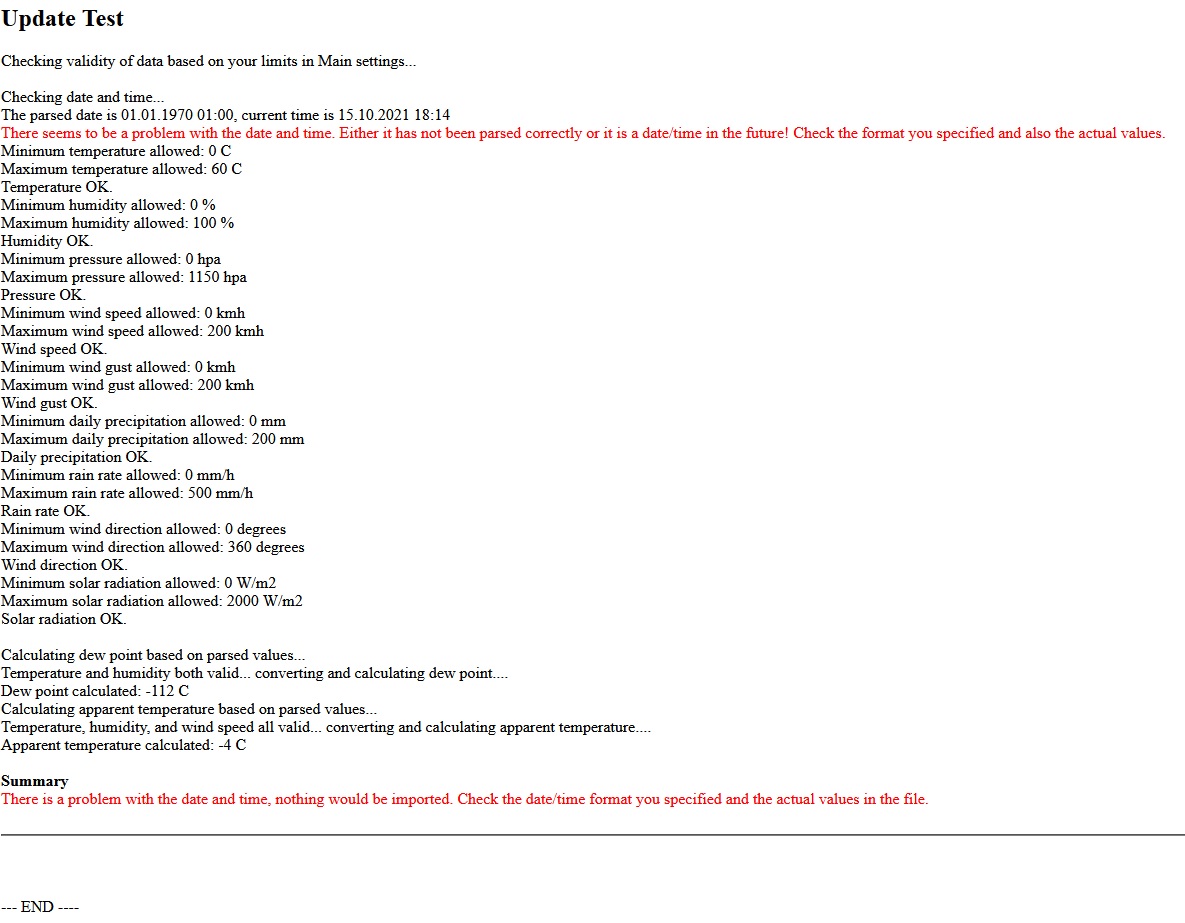

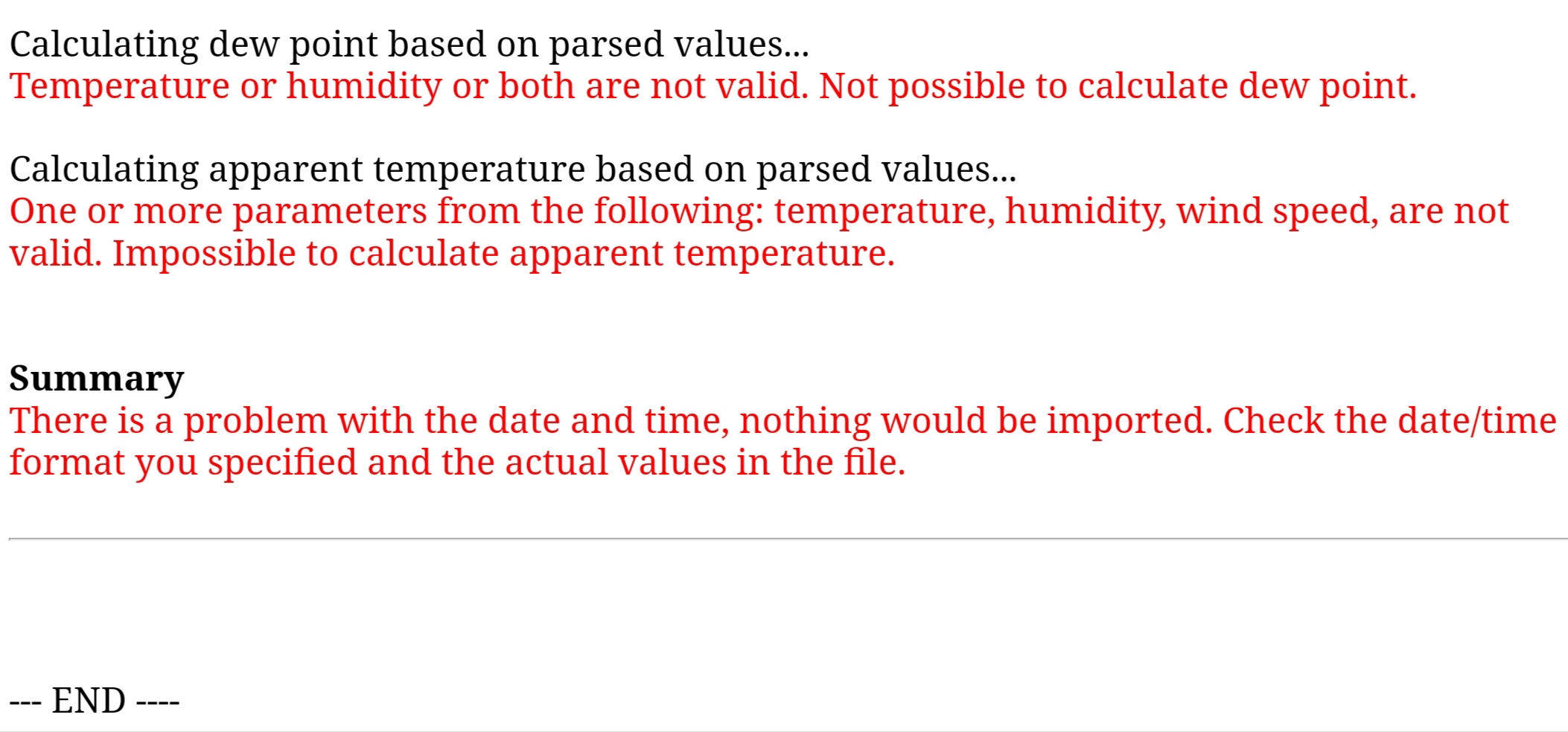

OK perfect, thanks for confirmation, in the meantime I made further tests:

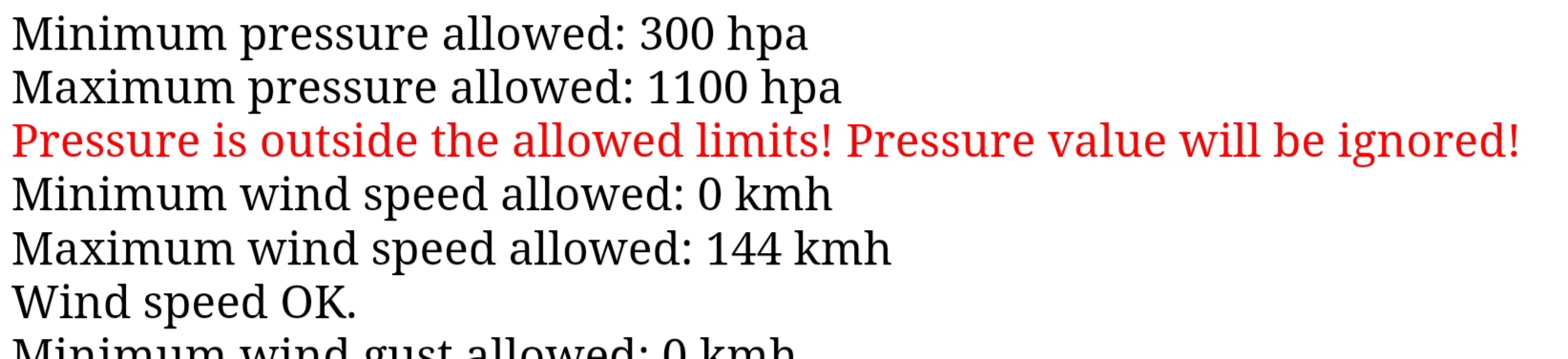

I tried to change the min and max ranges on the main installation page and most errors have disappeared, more than anything else they were the minimum limits the problem.
Only that for the temperature if I imposed 0°C everything is ok, while it gives me error if I go down under 0°C; What to me problematic because in winter it often happens and from the error that comes out, even "Dew Point" is not calculated and "apparent temperatures".
The phrase highlighted in red "temperature value will be ignored!" Honestly it worries me.
In addition to this I am investigating with the date, I still don't come to the head.

Surely the date problem is here but, I thought I could select in my pleasure ... what should I change, go for trials?
Re: Errors in testUpdate.php
Post by davidefa » Fri Oct 15, 2021 5:16 pm
Scusami, ma non puoi richiamare lo script update/testUpdate.php direttamente.
In questo modo non stai facendo nessun test ( perchè non gli stai passando nessun argomento da testare ).
Quello script è richiamato solo da update/updateSetup.php ( quando selezioni 'cumulus' 'wu' o 'custom file' )
Il test che stai facendo non ha nessun senso.
Se vuoi verificare la 'correttezza' dei dati memorizzati nel database ( potrebbero esserci dei valori errati per qualsiasi motivo, come la prima riga del database che hai cancellato ) puoi usare il plugin 'Data Quality Control' chè ti permette di analizzare i tuoi dati in diversi modi evidenziando le incongruenze
Post by davidefa » Fri Oct 15, 2021 5:23 pm
Riguardo i limiti li puoi impostare nella sezione Limits ( del setup iniziale ).
Verifica che siano compatibili con le tue condizioni.

Post by amonphi » Fri Oct 15, 2021 5:55 pm
davidefa wrote: Fri Oct 15, 2021 5:16 pm Scusami, ma non puoi richiamare lo script update/testUpdate.php direttamente.
Accidenti a me :) , come ho fatto a non arrivarci, hai pienamente ragione, un test inutile giustamente. Chiedo immensamente perdono!
Verificherò bene i limiti e proverò il plugin che mi hai consigliato.
