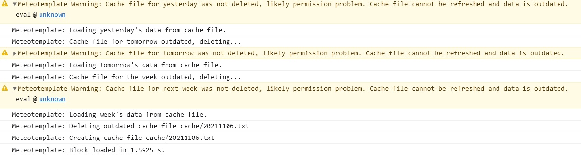

I have disabled the error reporting that Meteotemplate throws if cache folder is no writeable, how ever the warning is still there if i inspect the page. something is wrong here
Warning shows it deletes and recreates the same date file
Is there anyone that has found why this happens or how to fix
attached you will see my cache folder and also the error from the browser

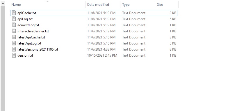

You can see that its writeable by the file structure
Cache Folder IIS

I guess whatever system user PHP is using has a rights issue?
