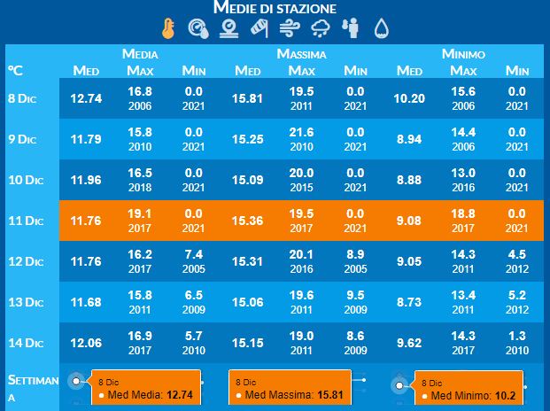

Hi, i had a problem with my weather station sensor and i am waiting the new sensor. Actually only the pressure and the rainfall work.
I would like to know if it is possible to remove the averages of the last few days, because since the station no longer works it is always marking me temperature, humidity, wind always at 0 so every day it mark a new record in 2021.
Also the variations are wrong.
no data and wrong averages

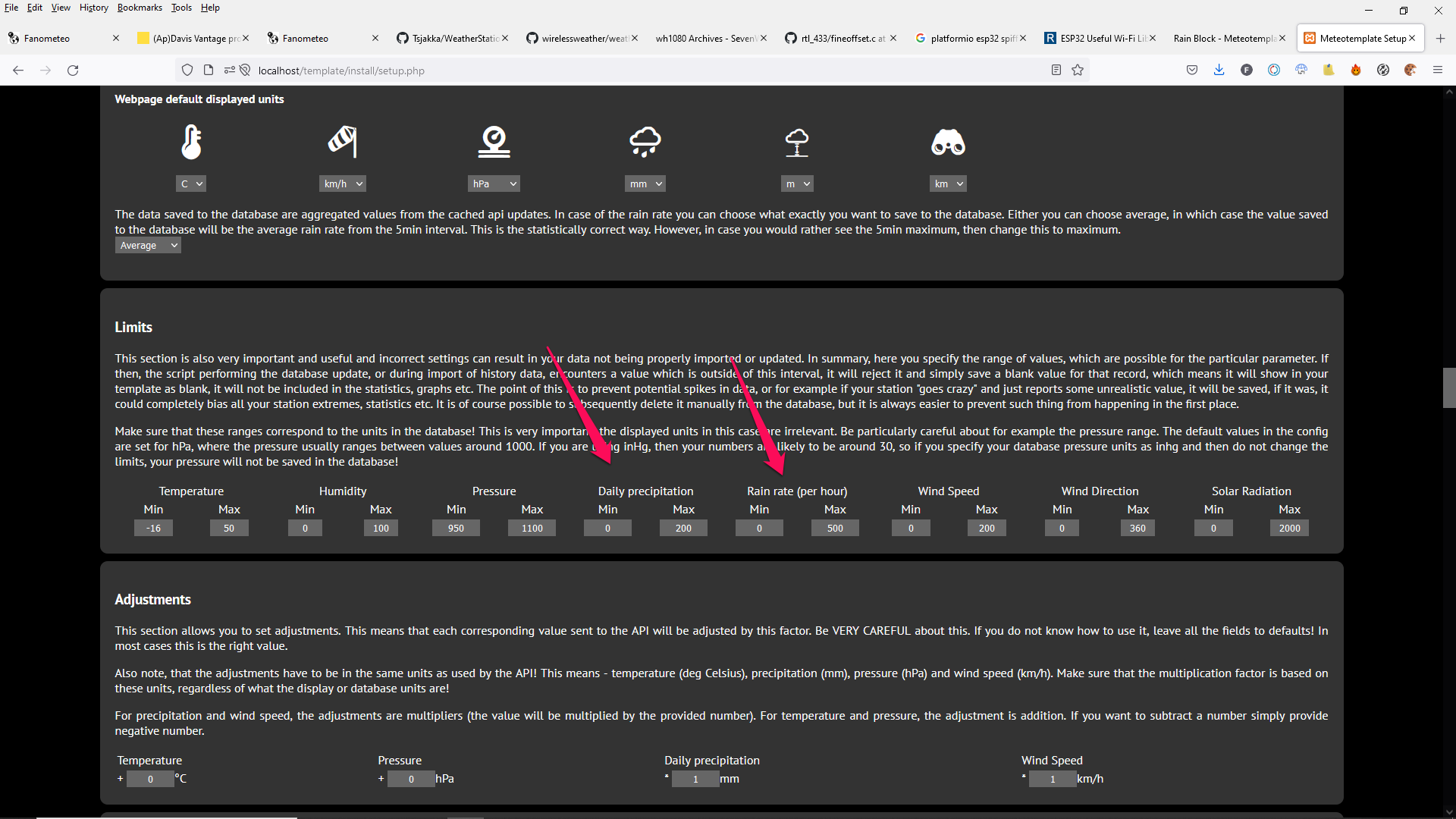

Re: no data and wrong averages
1) to filter out these values for the next days you can set a limit in the meteotemplate control panel -> main setup, limits section ( don't considers the arrows, set appropriated limits for temperature, humidity and wind, you'll have to revert this once you'll receive the new sensor ).
2) for past data, you have to delete all the past wrong data in the database ( averages are not stored, but calculated on the fly ), I'm not aware of a tool that can do this in meteotemplate, but you can do this in phpmyadmin ( I mean in the database administration tool supplied by your provider, if you choose this way make a backup copy of the db before proceeding ):
Thank you for the answer, I already changed the limits but now i modify also the temperature at 5 minimum.

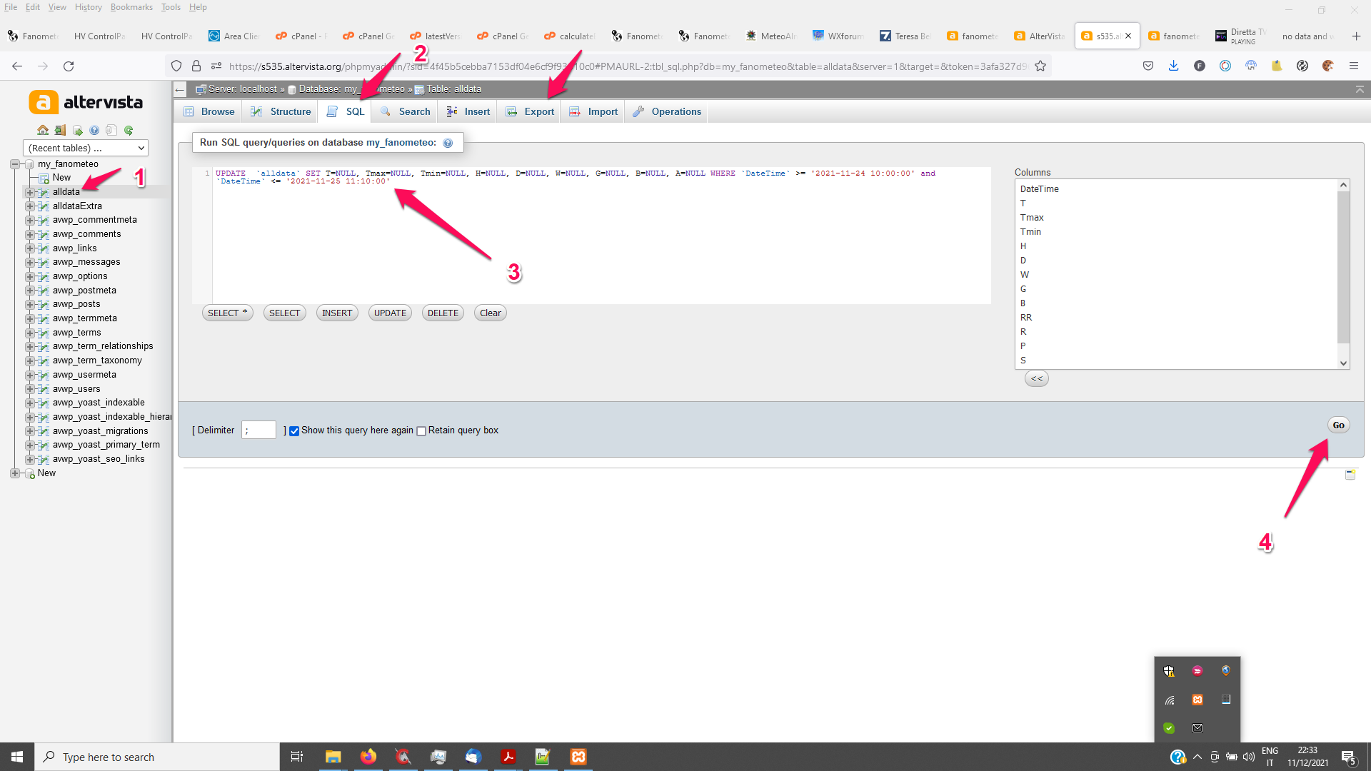

1) select the alldata table
2) select the sql tab
3) paste the sql command
3a) modify the date/time
3b) verify everything is correct
4) press go
To backup the database select the export tab
4) press go
I did it but it's always like before
