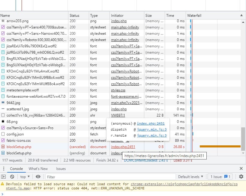

Do you have any idea about this problem, after clicking on the install / setupBlocks icon, I need at least 1 minute to access the block conguration panel.

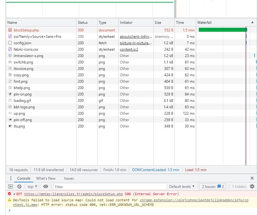

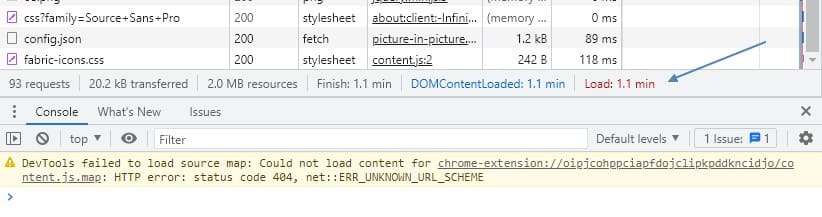

Hello Davide here attaches the result. in fact it only happens if you click on install/setupBlock and intermittently. Thank you José Luis
Opening without error attention 1.1 minutes
error encounter evec firefox

The problem seems to be the '500 internal server error'.
You may check if the server error log contains other useful information ( trough your provider's control panel ) as this may be connected to different problems.
