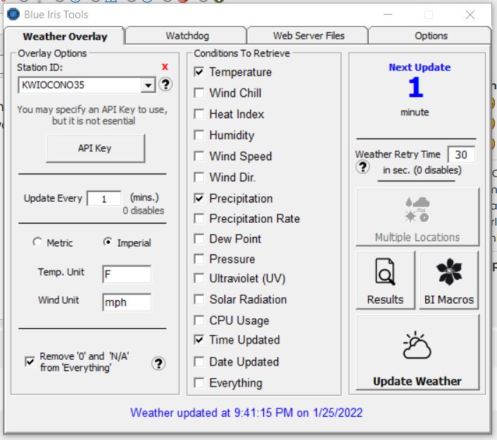

Alright, I found a way to do this.
I'm sending my weather data to Weather Underground.
I'm using Moonware's Netcam Studio to stream my webcams.
I also have Blue Iris Tools.
Blue Iris Tools (a completely separate app from Blue Iris webcam software) has a weather overlay feature.
It will go to weather underground, fetch my uploaded data and write the result to a text file.
I have it updating once a minute.

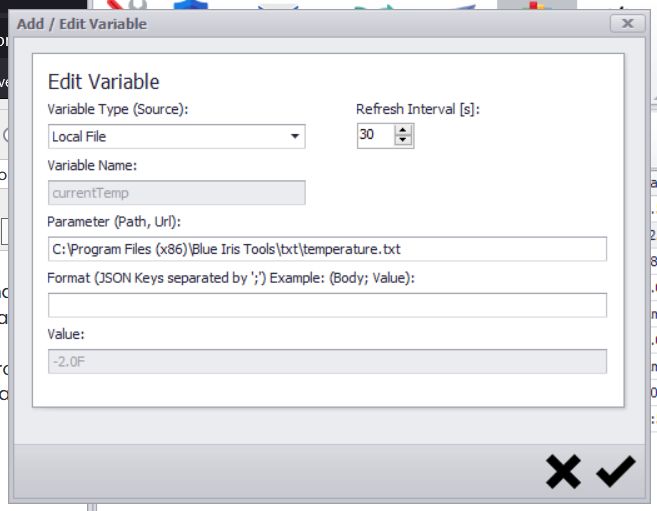

In Netcam Studio, I created new global variables for the outdoor temp and the update time.

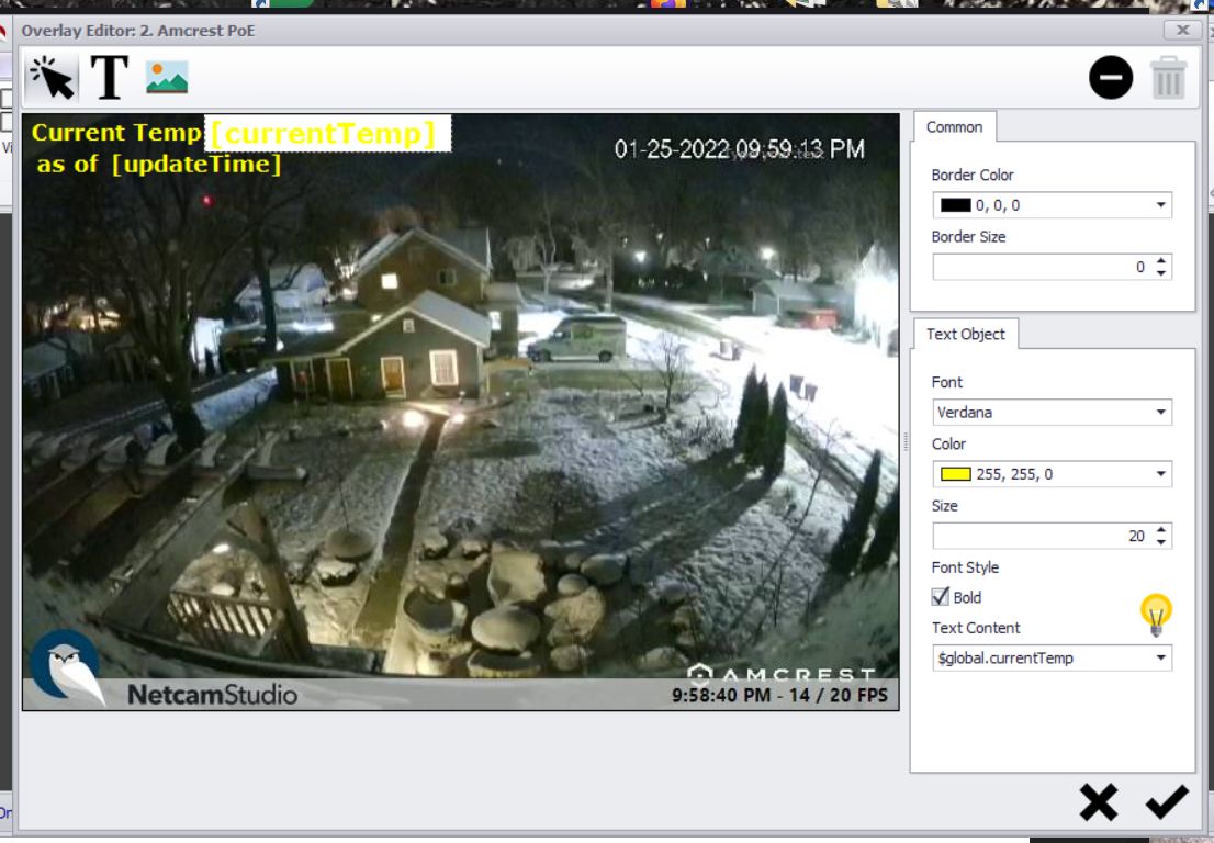

Then, using Netcam Studio's overlay editor, I inserted the newly created global variables as overlay text on my webcam image.
