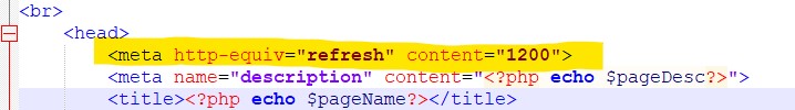

You can add a HTML Meta page refresh command to your template file.
Screenshot 2022-02-02 124925.jpg (23.35 KiB) Viewed 3231 times

Thanks. Was so focused on the server side that I didn't think about it via the client.
Rolled it into header.php so it looks like its showing up on all the pages.
