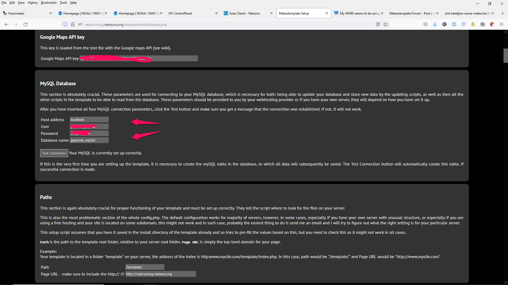

I took a glimpse at your cache/apiLog.txt, at the end of the file you can see:
This means you have not set your database parameter correctly ( in the main setup page ):
Recheck the four parameters highlighted below ( your hosting provider should have provided ).
Verify with the Test Connection button that everything works as expected.
Saving first new data to cache/apiCache.txt, timestamp=2022-02-03 14:30:29
Generating log file cache/apiLog.txt
ERRORS:
Unable to connect to MySQL
Meteotemplate MySQL Error: with query:
INSERT INTO alldata
(DateTime,T,Tmax,Tmin,H,P,W,G,B,R,RR,S,D,A)
values ('2022-02-03 14:30:00',8.0,8.1,7.9,83.8,1015.8,4.0,11.2,170,0.0,0.0,48.4,5.4,6.2

Yes, that it is.
there was a typo.
sorry about that.
