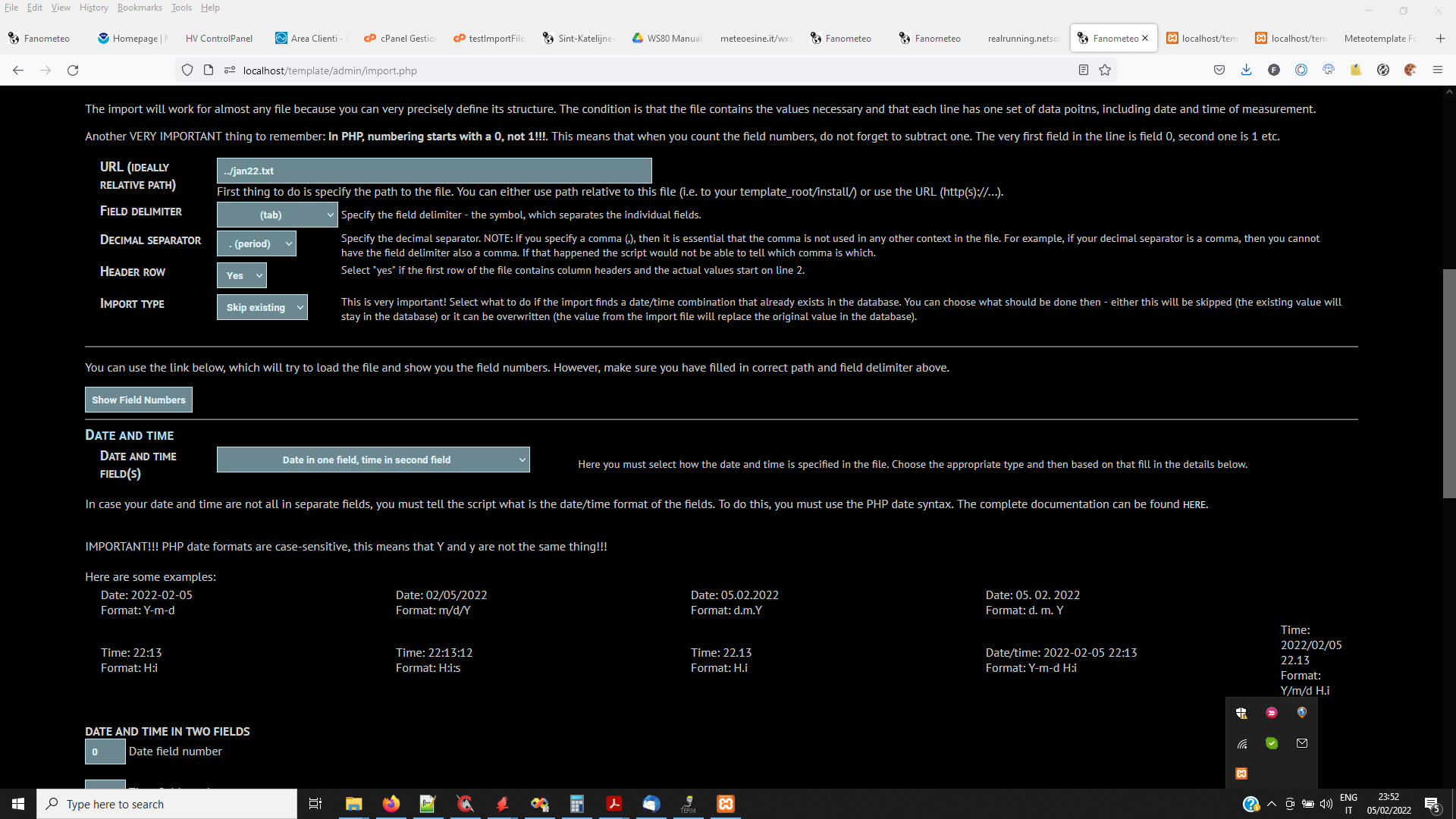

I have difficuties uploading historical data.
Everytime I get 504 Gateway Time-out.
This is the file: https://www.sint-katelijne-waver-meteo. ... /jan22.txt
Even show field numbers doesn't work.
Thes are the settings I use
Field delimiter
(tab)
Decimal separator
. (period)
Header row
Yes
Import type
Skip existing
uploading to api.php every 5 minutes.

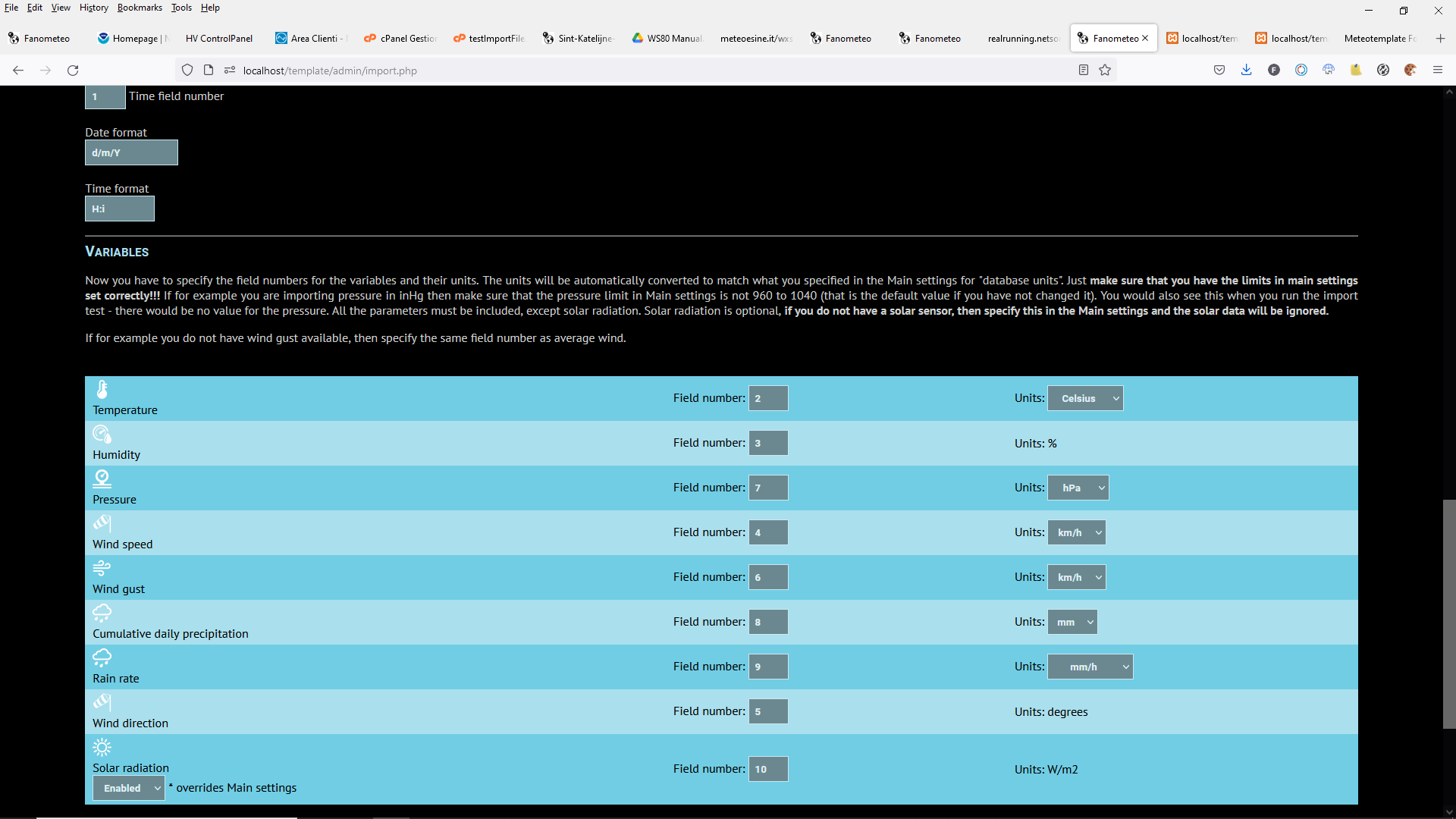

If my wind redirection is not in degrees how do I convert the export file to it?
in the example i changes the wind direction to 0.

- uncompress the attached file in the admin directory ( backup the original files ), added alphanumeric bearing conversione ( N, NNE, NE... ), so you can import your files without additional conversions, and a few PHP 8.0 compatibility fixes
- configure import parameters as below
- Show field number, Test import and Import should work as expected

thx, uploaded all your ph8.0 mods and they work.
One thing I'm struggling now is the rain data. They rain block doesn't show the correct daily rain, etc....
Some graphs also doen't show the correct rain data.
Any ideas?
Thx
Any ideas?
Thx

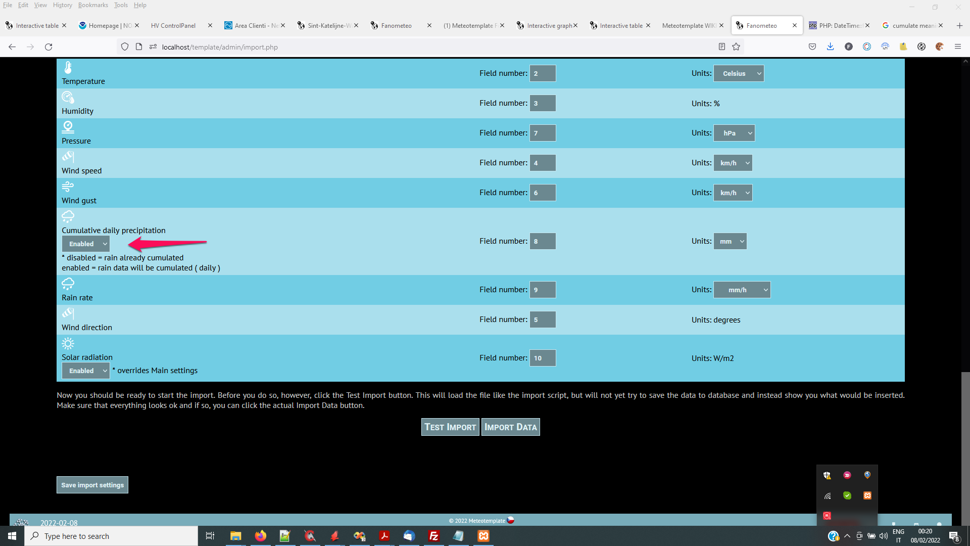

Yes, the rain data should be a 'daily cumulative rainfall (since midnight)' but the data you imported has the rain data as rain in the last 5 minutes interval ( I didn't noticed it ).
You have to repeat the import process ( unzip the attached script in the admin directory ):
- set Import Type to Overwrite
- set the new option to Enabled
- import_1.0.zip
- (11.49 KiB) Downloaded 421 times
