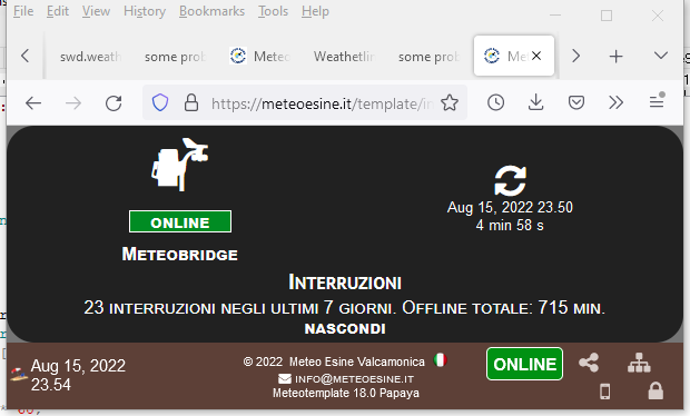

today I discovered that I had problems with the meteobridge: it was no longer recording data on the database. (restarted MB and everything restarted regularly)
But the problem arises that the offline notification does not work with php8.1:
The current block continues to show the current time and the icon in the footer is also green "online". (and obviously no notification email has be sent)
I noticed the anomaly from the stationStatus block (lastest version 5.1) which was correctly displaying offline.
to add to the to-do list ;-)

It seems working correctly on your site now
But the image you posted is indeed strange
After a blackout period, the indication at the bottom of the page goes 'online' after the first update of the meteotemplateLive.txt file while the stationStatus block goes 'online' after the first write in the database.
So it is possible, for a few minutes, to have the first indicator 'online' and the second 'offline'.
But the image you posted shows the stationStatus block 'offline' with the indication that the last database write occurred 4' 23" ago ( and this is not correct )

Note, however, that the image has been modified with paint to show you how at about 14:00 I discovered the problem before I restored everything.
Note the interruptions: from your screenshot of last night at 23:50 to now ,there has been other interruptions for a total of 125 minutes (almost every 2 hours there are holes of 30-45 minutes) VERY STRANGE, and no reports of offline.
it will be necessary to understand what causes these interruptions, whether to php8.1, or to meteobridge (but it never happened) or to something else.
and above all that it notifies the offline

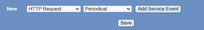

At the bottom of the "Services" tab, you need to add a service. Select 'HTTP Request' then select 'Periodical" then click add service event.
Screenshot 2022-08-16 101730.jpg (11.42 KiB) Viewed 40818 times
You will now see a blank service event.
Screenshot 2022-08-16 102012.jpg (21.86 KiB) Viewed 40818 times
You need to pick your frequency to send and add your api call, then click save.

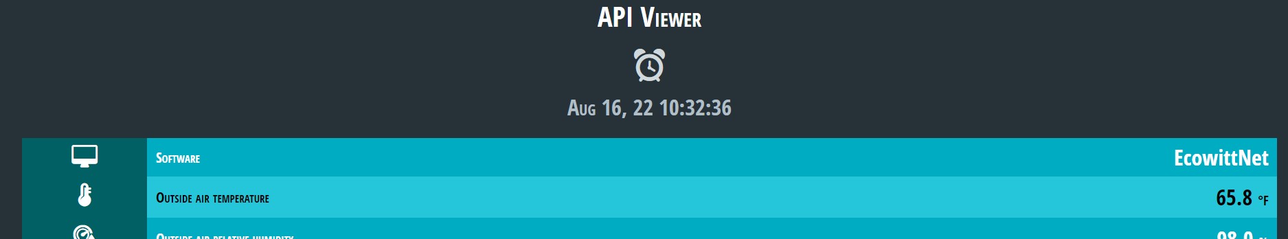

I do not see the api viewer plugin on your site, but if you use it - the software description would show EcowittNet not Meteobridge.
Screenshot 2022-08-16 103318.jpg (41.94 KiB) Viewed 40818 times
Good luck and ask any more question if you need to.
