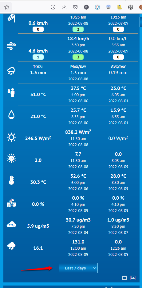

New issue:
The stationData block no longer shows any values. Ever since I switched input from MeteoBridge to Netatmo.
Strangely though, the Interactive graphs work fine, so the netatmo data must be going in the database now.

Not super easy to understand what's the problem without seeing a log/configuration.
Try executing:
http://localhost/mt/homepage/blocks/stationData/stationDataAjax.php?period=today&errors
http://localhost/template/indexFull.php?block=stationData&errors
and post the results ( assuming your meteotemplate server is http://localhost/mt )

The first log you posted shows there is no error, but no value is returned for any sensor ( I assume your database is not updated ).
Does the block show correct values when selecting a longer time interval ( last 7 days, this month, this year )?

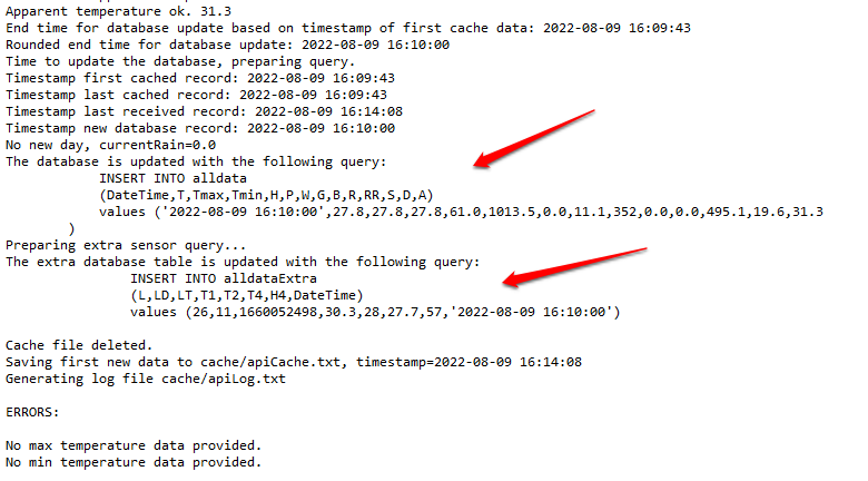

Please post also a copy of cache/apiLog.txt ( preferably containing the database query at the very end of the file, these will be included after minutes 0, 5, 10... )

davidefa wrote: Tue Aug 09, 2022 2:24 pm The first log you posted shows there is no error, but no value is returned for any sensor ( I assume your database is not updated ).
Yes, when I select 7 days, I see data has stopped coming in August 5. Strange, as this is when I stopped using the MeteoBridge to send data to it, not when I installed/got the netatmo block working..
cache/apiLog.txt:
Checking temperature is between limits specified in template Main settings.
Minimum temperature limit: -100 C
Maximum temperature limit: 100 C
Temperature is OK and within the allowed limits
Parsing maximum temperature
Parsing minimum temperature
Parsing humidity
Humidity: 71 percent
Checking humidity is between limits specified in template Main settings.
Minimum humidity limit: 0 %
Maximum humidity limit: 100 %
Humidity is OK and within the allowed limits
Parsing wind speed
Wind speed: 4 kmh
Database wind speed units: kmh
Checking wind speed is between limits specified in template Main settings.
Minimum wind speed limit: 0 kmh
Maximum wind speed limit: 200 kmh
Wind speed is OK and within the allowed limits
Parsing wind gust
Wind gust: 10 kmh
Database wind units: kmh
Checking wind gust is between limits specified in template Main settings.
Minimum wind gust limit: 0 kmh
Maximum wind gust limit: 200 kmh
Wind gust is OK and within the allowed limits
Parsing wind direction
Wind direction: 28 degrees
Wind direction is OK and within the allowed limits
Parsing daily cumulative precipitation
Precipitation: 0 mm
Database precipitation units: mm
Checking precipitation is between limits specified in template Main settings.
Minimum precipitation limit: 0 mm
Maximum precipitation limit: 200 mm
Precipitation is OK and within the allowed limits
Parsing rain rate
Rain rate: 0 mm/h
Database rain units: mm/h
Checking rain rate is between limits specified in template Main settings.
Minimum rain rate limit: 0 mm/h
Maximum rain rate limit: 500 mm/h
Rain rate is OK and within the allowed limits
Parsing solar radiation
Now parsing extra sensors.
Sensor: UV not found in API file, skipping...
Sensor: extra temperature sensor 1 not found in API file, skipping...
Sensor: extra humidity sensor 1 not found in API file, skipping...
Sensor: particulate pollution 1 not found in API file, skipping...
No cache file found, create empty file.
Parsing pressure
Pressure: 1025.8 hpa
Database pressure units: hpa
Checking pressure is between limits specified in template Main settings.
Minimum pressure limit: 950 hpa
Maximum pressure limit: 1100 hpa
Pressure is OK and within the allowed limits
Pressure is valid.
Calculated dew point: 17.1 C
Dew point ok.
Calculated apparent temperature: 24.2 C
Apparent temperature ok.
End time for database update based on timestamp of current data: 2022-08-10 12:50:00
Rounded end time for database update: 2022-08-10 12:50:00
Time to update the database, preparing query.
Timestamp first cached record: 2022-08-10 12:50:00
Timestamp last cached record: 2022-08-10 12:50:00
Timestamp last received record: 2022-08-10 12:50:00
Timestamp new database record: 2022-08-10 12:50:00
No new day, currentRain=0.0
The database is updated with the following query:
            INSERT INTO alldata
            (DateTime,T,Tmax,Tmin,H,P,W,G,B,R,RR,D,A)
            values ('2022-08-10 12:50:00',22.6,22.6,22.6,71.0,1025.8,4.0,10.0,28,0.0,0.0,17.1,24.2
Cache file deleted.
Generating log file cache/apiLog.txt
ERRORS:
No max temperature data provided.
No min temperature data provided.
No solar radiation data provided.

From what you posted the database was updated correctly a few minutes ago ( 2022-08-10 12:50:00 )
            INSERT INTO alldata
Cache file deleted.

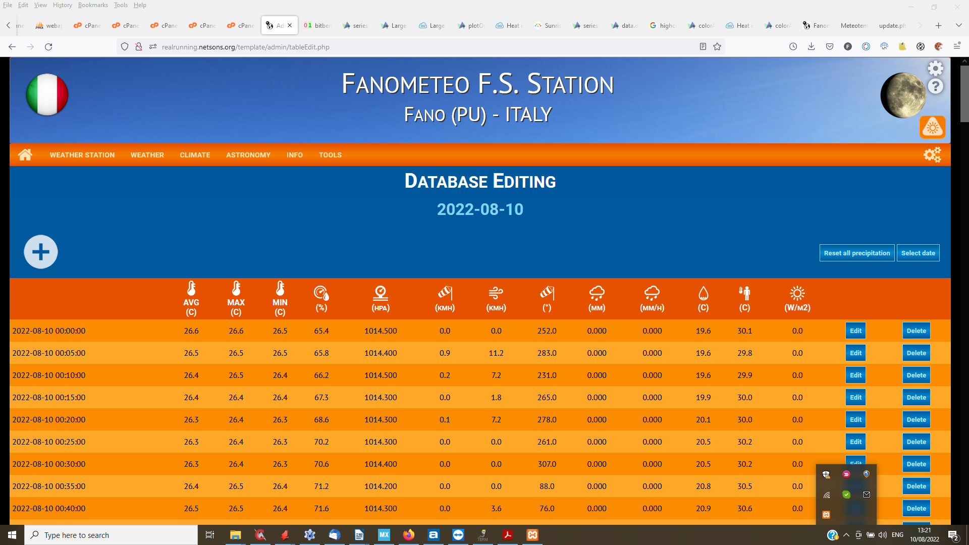

If you look in the meteotemplate control panel -> edit data do you see the data recordings for today? Something like in the following image.
If yes you should be able to see this today's data in the stationData block and in the various graphing blocks/pages.

davidefa wrote: Wed Aug 10, 2022 11:36 am If you look in the meteotemplate control panel -> edit data do you see the data recordings for today? Something like in the following image.
Yes, and I found out what was wrong; The stationDataBlock.php was some kind of later version than the original. This stems from your update showing min gust/windspeed time, and somehow it didn't work (anymore).
I've re-installed with version 10 from the MT site, and we're back online!
