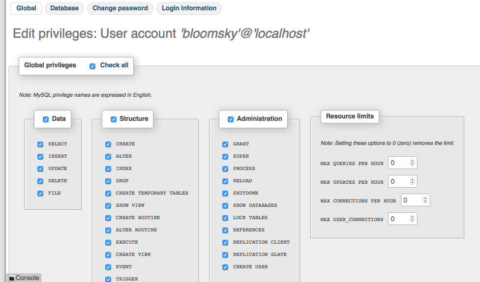

Could you check if your database user has the right privileges? It should have read and write access (may be more, I'll have to check).
Re: Trouble setup mysql - authrization denied
Post by Jachym » Sat Sep 30, 2017 9:18 am
There are usually 2 types of users, one has just read/write permissions and one can also create tables etc. You need the one with the full permissions.

Post by Fraggboy » Sat Sep 30, 2017 2:32 pm
You want to look for a Global Privileges checkbox.
Screen Shot 2017-09-30 at 7.31.20 AM.png (121.42 KiB) Viewed 24416 times
