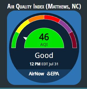

OK ... I know that the new 19 is around the corner but I noticed this block was broken and came up with an easy fix using the AirNow EPA widget.
Download the replacement file here (PLEASE always keep a copy of the old file).
https://drive.google.com/file/d/1dylGeo ... sp=sharing
-Change the name of your displayed location in the title. Mine is 'Matthews, NC'
Screenshot 2023-07-31 124553.jpg (5.84 KiB) Viewed 3399 times
-Change the name of your desired location in the iframe line. Mine is "city=Matthews&state=NC"
Screenshot 2023-07-31 124635.jpg (5.99 KiB) Viewed 3399 times
Copy the new airQualityUSBlock.php file to your Block/airQualityUSBlock directory.
No settings changes or anything else to do. Should come out looking like this.

Works like a champ. Thanks for sharing!
