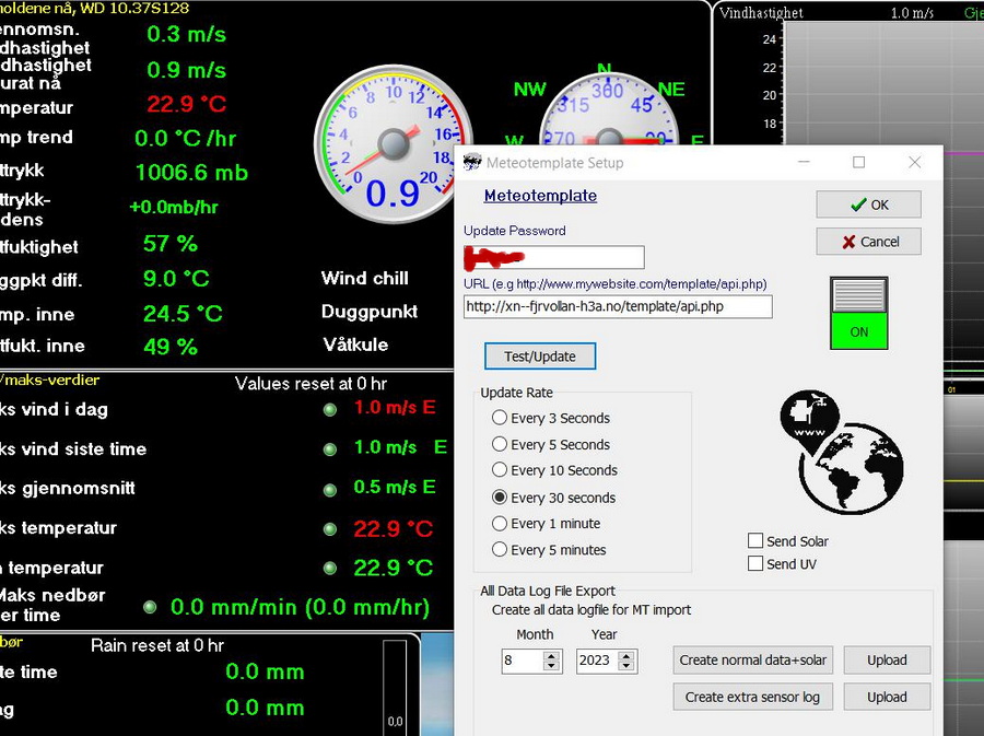

I am not aware of any special operations.
Under "Select Station Type", I selected the NETATMO station.
I am not sure, but I closed WD and when I opened it again, the connection script to the Netatmo servers was executed.
From this point on, the data from the Netatmo station appears in WD.

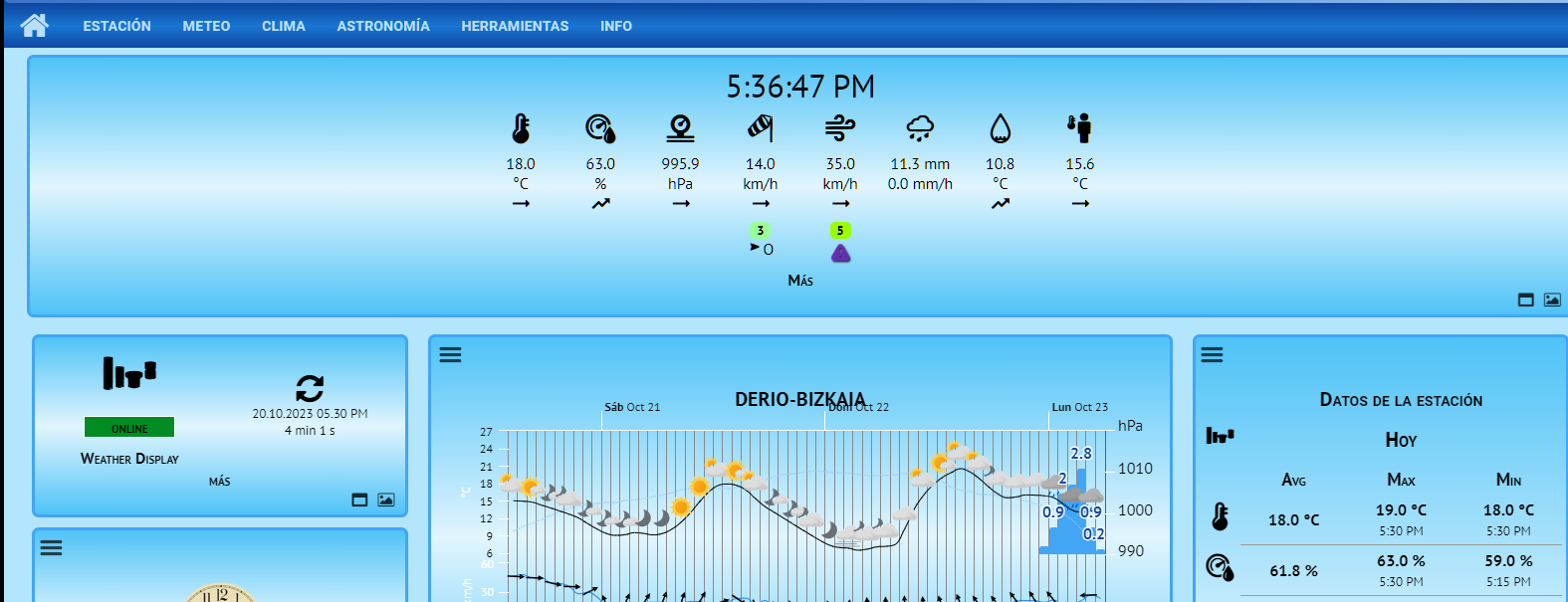

Then I linked WD to Meteotemplate (password and API url). I waited 10 minutes and, when I opened Meteotemplate, the data was updated periodically.
I've been testing for three hours and everything works correctly.
I can send you a screenshot of Meteotemplate, but I am unable to add images to my messages.

El_Viejo wrote: Fri Oct 20, 2023 6:00 pm
Yes , please send a screenshot. Will look at iit on monday when I em home.
Em at work right now and till monday. Thanks.
toby@vkbb.no
