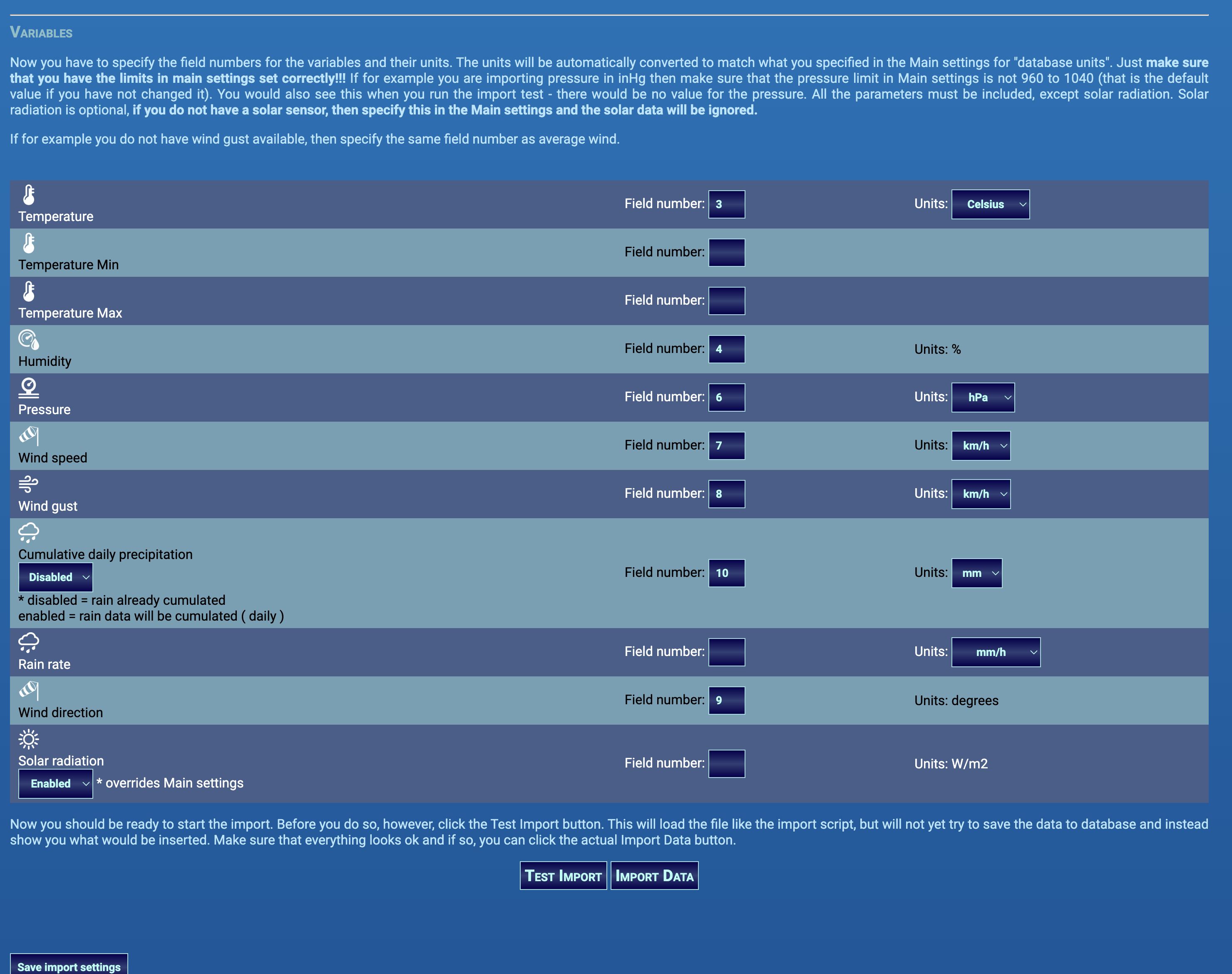

I try to import data from a txt exported from Meteobridge Nano.
The file looks like this:
# date, time, temperature[C], humidity[%], dew point[C], sealevel pressure[hPa], avg wind speed[m/s], gust speed[m/s], winddir, rainfall00
2023-01-01,00:00,14.3,72,9.3,1019.8,1.3,4.9,233,0.0

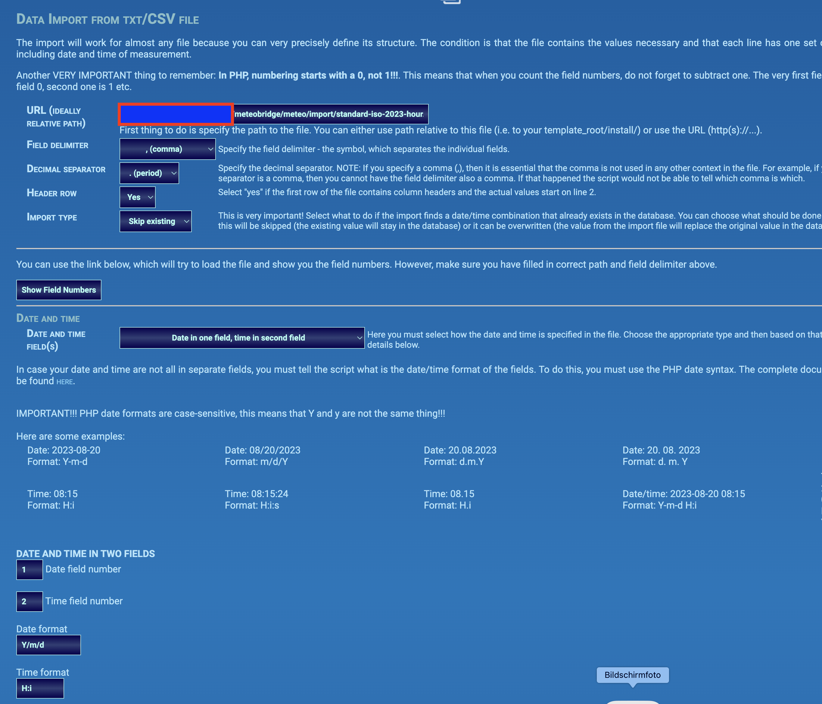

I filled the import page, the response of testing is like this:
Testing CSV/text file...
Errors will be highlighted in red...
Loading CSV/text file from ....meteobridge/meteo/import/standard-iso-2023-hour.txt
File loaded successfully.
Header row in the file, skipping first line.
The tested file has 5553 data sets. This import test will load only the first line.
Starting to parse data.
Loading line 1...
Separating fields...
Decimal separator is a period, no need to do anything, can be parsed by PHP.
The data row contains 10 fields.
Parsing date and time...Date in one field, time in a different one.
Then I tried to do the import, response comes:
Importing data from CSV/text file...
Loading CSV/text file from....e/meteo/import/standard-iso-2023-hour.txt
The imported file has 5553 data sets.
Import type: skip
But nothing is happening. What is my fault in the setup? Sorry for this maybe silli question....
Thanks for any help
Peter
