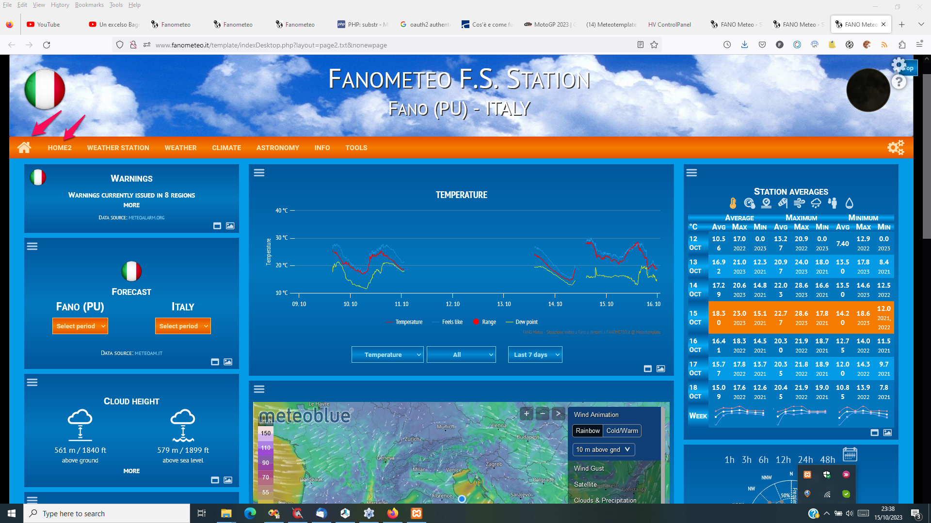

- simply create an homepage layout ( via the meteotemplate control panel ) and save it with a name ( short name, max 8 chars ), for example 'page2' ( you can create as many as you want ), meteotemplate already does this
- the mod extends the indexDesktop.php scripts ( used to load the home page ) so that you can pass a 'layout' parameter to load one of the layout created in previously ( not only the default one )
- to load the page2 layout, for example, point your browser to ( note the .txt added after the layout name ):
indexDesktop.php?layout=page2.txt&nonewpage
- the additional parameter '&nonewpage' is an addition to the meteotemplate menù to open the page in the current tab ( default behaviour is open in a new tab, which is annoying in this case )

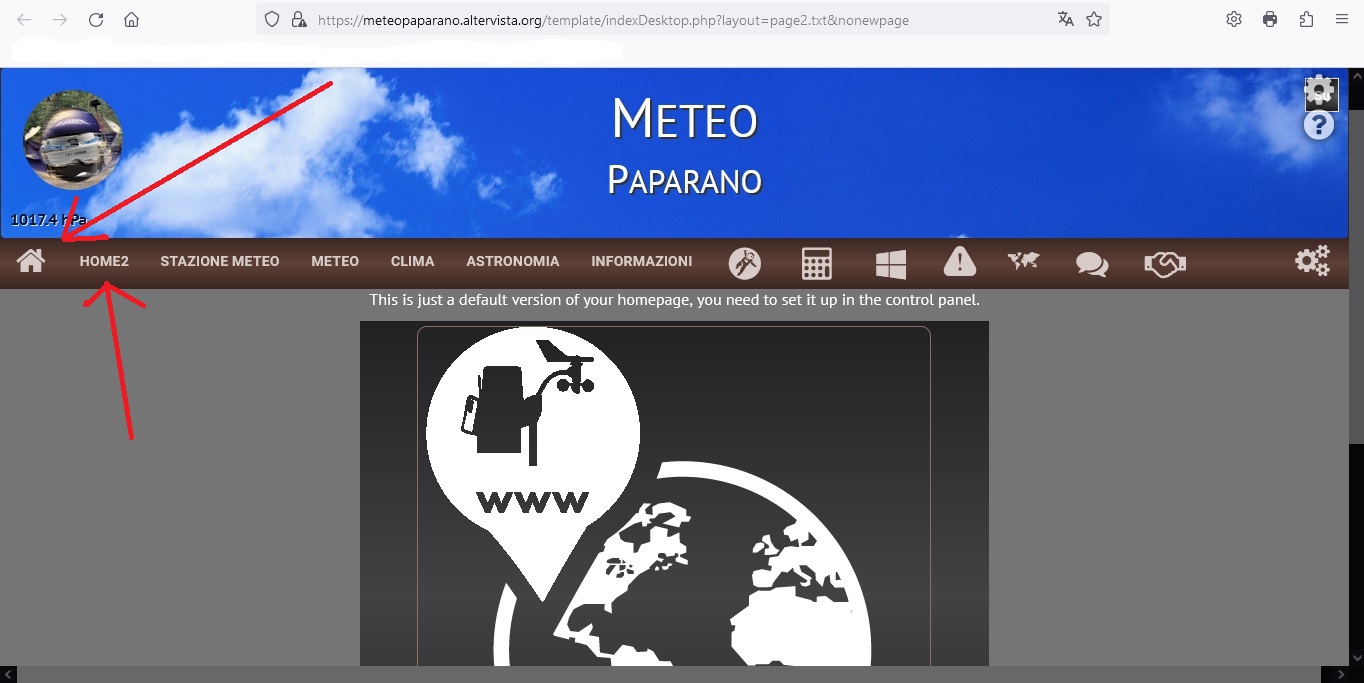

Hi @davidefa ,
I installed Multiple pages mod (I find it very useful), I added new tab to the menu and in the "Use this tab as a link, URL:" field I inserted my new home2 https://meteopaparano.altervista.org/te ... &nonewpage which of course is now empty.
However, I can't understand how to set it from the control panel because if I open it, it goes to the control panel of the main home already set... I always get lost in this nonsense!
