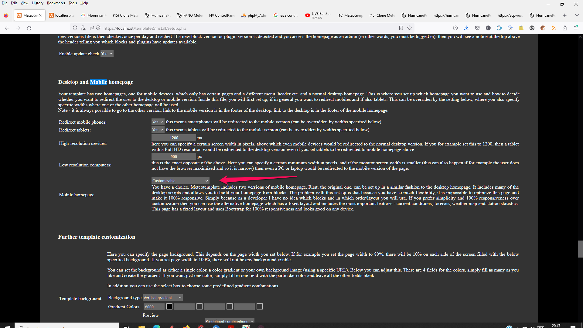

In the main meteotemplate setup you can try setting the 'Mobile homepage' setting to Customizable.
Re: Clone Meteotemplate redirects on moble
Posted: Sat Nov 25, 2023 10:41 pm
by spd2612
davidefa wrote: Sat Nov 25, 2023 7:50 pm In the main meteotemplate setup you can try setting the 'Mobile homepage' setting to Customizable.
davidefa You got it again
I am not sure why but changing to customizable worked Great thanks for all the advice
