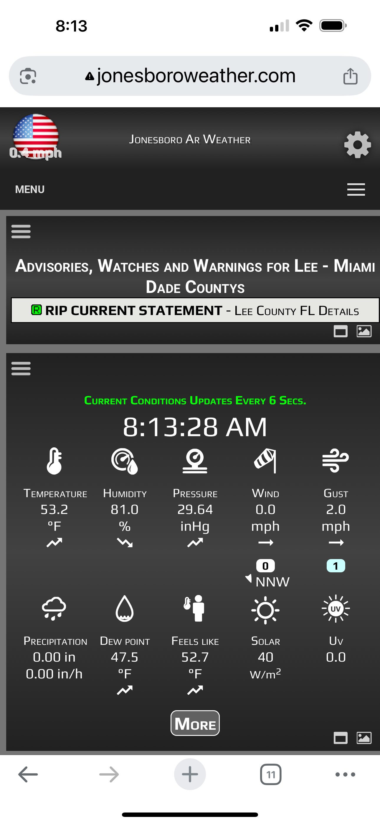

Well this just got real intresting
I could not get past the white page even config.php so I went back to my vm that was at my old domain which did work
I created a new wesite pointing to the old website but using the new domain basically just another conf file
All worked pointing to both domains but only on my wifi
If i switch my phone or pc to vpn or put my phone on cell neither domin works cant be dns as i am typing in the domain name
Here is a screen shot but i bet you cant get to that domain jonesboroweather.com

Well it does appear that my isp is blocking port 80 now but leaving 443 open
