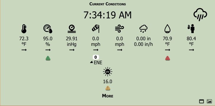

I have noticed that my Current Conditions block is now showing UV information. What is odd is not a sensor I have nor did I do anything knowingly to start showing this. How do I hide this once again as I do not see any option for this in the SETTINGS for this block?
Thanks!

You didnt tell us what you are using to send data to the template (which SW), but whatever you use, it is sending UV information:
Raw data, notice the UV value:
http://www.cecilweather.com/weather/cec ... teLive.txt
This must be sorted in whatever is sending data to the template. If there is UV available, the template will think it is available.
