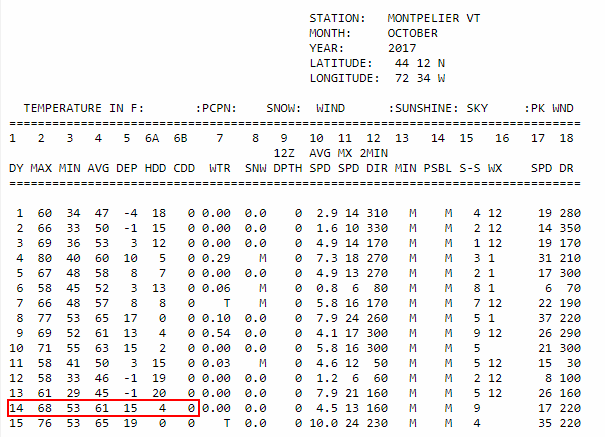

I'm seeing values for Cooling Degree Days and Heating Degree Days existing on the same day. If the calculation is done as the National Weather Service defines it, there should never be values for heating degree days and cooling degree days occurring on the same day:
From http://www.weather.gov/media/btv/degreedays.pdf:
The National Weather Service (NWS) uses the mean of the daily maximum and minimum 24-
hour temperature (Tnws) to determine daily heating or cooling degree days (where Tnws = (Tmax +
Tmin)/2).
For example, in the red box, the 24-hr max temperature was 68, the 24-hr min was 53, and the average (68+53)/2 = 60.5, rounded up to 61. The threshold for both HDD and CDD is 65F. CDD occur when the Tnws is more than 65F, and HDD occur when the Tnws is less than 65F. Notice how even though the max temperature was above 65F,
there are no CDD, because there were HDD instead.

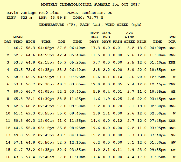

But as reported on my standard NOAA Report page (see: http://meteorology.lyndonstate.edu/mete ... rdized.php), and in the screenshot below, on Oct 15, for example, the high was 73.2, and low was 52.9, so the mean (average) was 61.7. Doing the HDD calculation, the HDD value should be (65-61.7)=3.3, rounded down to 3. (It also appears the MEAN TEMP column is not just (Tmax + Tmin)/2, otherwise it would be 63.05F, and not 61.7F.)

My point was that there shouldn't be Cooling Degree Day and Heating Degree Day values existing on the same day (per the NWS's definition/calculations), so my question was: how are the heating a cooling degree days values calculated?
Re: Degree Days calculation in NOAA Report
Post by Jachym » Tue Oct 17, 2017 12:35 pm
OK, I see:
if($minimum>$baseT){
			$hdd = 0;
		if($hdd==9999 && $average>$baseT){
			$hdd = ($baseT-$minimum)/4;
		if($hdd==9999 && $maximum>=$baseT){
			$hdd = ($baseT-$minimum)/2 - ($maximum-$baseT)/4;
		if($hdd==9999 && $maximum<$baseT){
			$hdd = $baseT-$average;
		$data[$row['Day(DateTime)']]['HDD'] = $hdd;
		$data['month']['HDD'][] = $hdd;
		if($maximum<$baseT){
			$cdd = 0;
		if($cdd==9999 && $average<$baseT){
			$cdd = ($maximum-$baseT)/4;
		if($cdd==9999 && $minimum<=$baseT){
			$cdd = ($maximum-$baseT)/2 - ($baseT-$minimum)/4;
		if($cdd==9999 && $minimum>$baseT){
			$cdd = $average-$baseT;
		$data[$row['Day(DateTime)']]['CDD'] = $cdd;
		$data['month']['CDD'][] = $cdd;
jntkwx
Posts: 8
Joined: Mon Oct 16, 2017 6:06 pm
Software: WL-IP
Post by jntkwx » Thu Oct 19, 2017 2:19 pm
Thank you, that's very helpful. These are the sections of that code I'm most interested in:
			$hdd = 0;
			$cdd = 0;
Can we agree that hdd and cdd values should not both exist on the same day? Either a HDD or a CDD exists, but not both for the same day, according to NWS definition. I think the problem here is the hdd and cdd values are dependent upon how the cdd and hdd values are summed over time (how are $minimum and $maximum defined? are they running averages for the day?) - if this is true, this causes hdd values and cdd values to exist simultaneously if the average $minimum temperature is below the $baseT and the average $maximum is above the $baseT.
