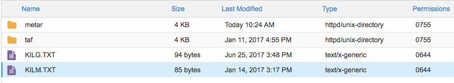

Ok, tried flushing all cache files and also changed my METAR and no change. My header and Current Conditions block works normally. I think you are right though there might be permission issue.
Screen Shot 2017-10-17 at 11.07.32 AM.png (40.92 KiB) Viewed 8590 times
Are these the files being looked at from pages/metar/buffer?
Re: Interactive Sticker - Always cloudy
Post by Jachym » Tue Oct 17, 2017 3:57 pm
yes

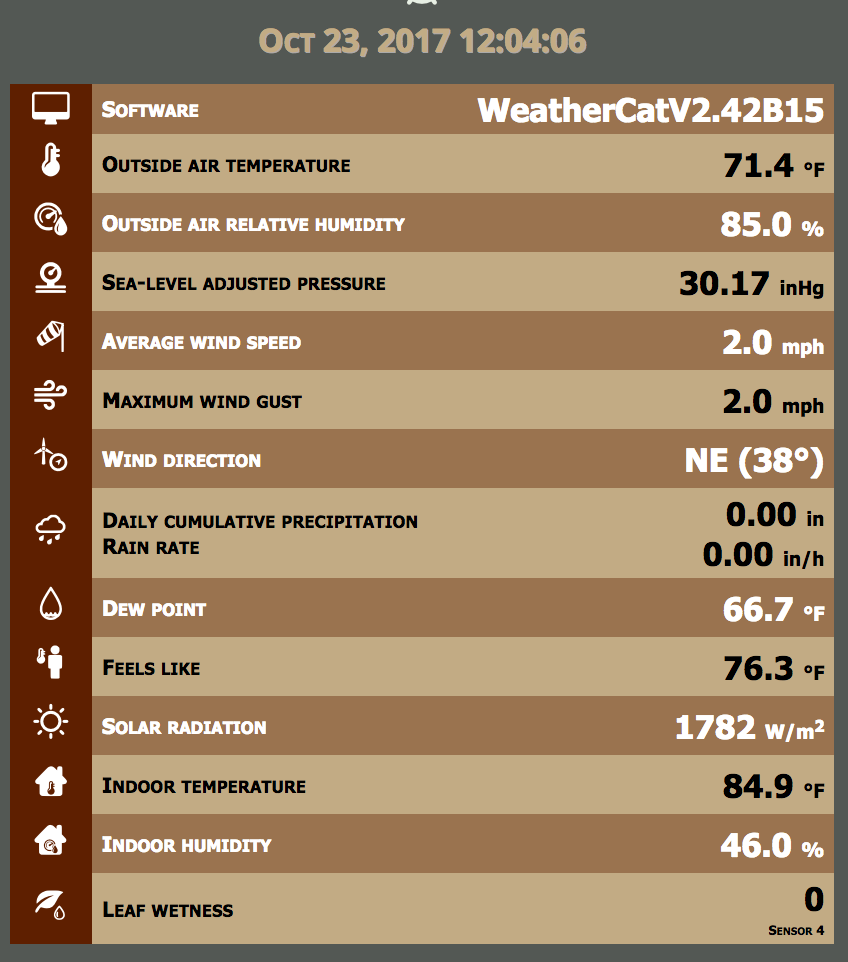

I have traced this to random Solar Data somehow getting reported by my weatherstation even though I do not have this type of sensor. In the stickerInteractive.php code, the following section seems to be firing for me:
if($S>800){
$items = array(23);
$bgNumber = $items[array_rand($items)];
$bgURL = 'bgs/'.$bgNumber.'.jpg';
$stickerColor = 'black';
$shadowColor = 'white';
When I look at the API I see this:
Screen Shot 2017-10-23 at 12.05.13 PM.png (139.77 KiB) Viewed 8507 times
I am not sure where the Solar Radiation information is coming from as I did track what WeatherCat is sending to the API and no Solar information is being sent. I do see Solar in my meteoTemplateLive.txt file so this might be the same issue I reported with the UV information (http://meteotemplate.com/forum/viewtopic.php?f=56&t=300) showing in the Current Conditions block. If I delete the meteoTemplateLive.txt my sticker starts showing the intereactive background correctly. Again not sure how this initially got reported by WeatherCat (crash, initial startup data, ???) but the API is holding onto the old info. The proposed fix in v17 should resolve this issue.

Post by Jachym » Mon Oct 23, 2017 5:06 pm
yes could be. This is a "bug" - or rather something I did not anticipate - situation where one sensor is temporarily available. MT then thinks it is available forever once it sees it at least once. I will address this in v17.
